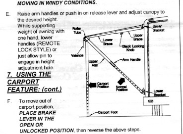

From memory, (1)roll out the awning as if using as a carport, (2) unclip the legs from the van and let them slide under the van (helps with 2 people).
Now you can slide the telescopic sections apart allowing the bolt for the black knob to be removed.

We actually got the knob back in place using a couple of pairs of long-nosed pliers and a lot of bad language!!! Delta's way sounds much more sensible. Checking that the knobs are tightened has been added to our departure checklist now.

Unlike Neil we lifted the arm away from the van and slid the leg out making it easy to access the nut and knob. Due to extreme difficulty undoing the knob we did have to hacksaw the thread below the knob and the nut fell out making it extremely easy to replace and then slide the arm back in place. Whole process with two persons took 15 minutes and most of that was spent trying to undo the frozen knob.

Anyone know the procedure to replace the "Main Black Locking Knob" on a Carefree Awning?
I did it on mine some time ago.
Cheers Neil

this any good for you guys
http://www.campingworld.com/includes/productSpecs/service.pdf
http://www.carefreeofcolorado.com/docs/tech/052876-201r2%20Patio%20Awning%20Owner%20Manual.pdf
