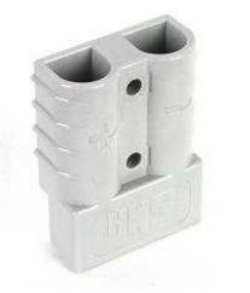

It is usual these days that there is an Anderson Plug on the vehicle and also on the van. The vehicle charges the van battery through that.
I assume you have an Anderson Plug?
03:19 AM Jul 17, 2012
Bit more info on Anderson Plugs and the 'typical' wiring.
The old way was the live on your trailer plug would slowly charge your battery but this day and age you need a connection from your elec sysm to an Anderson plug if you where in Townsville I could check it for you.

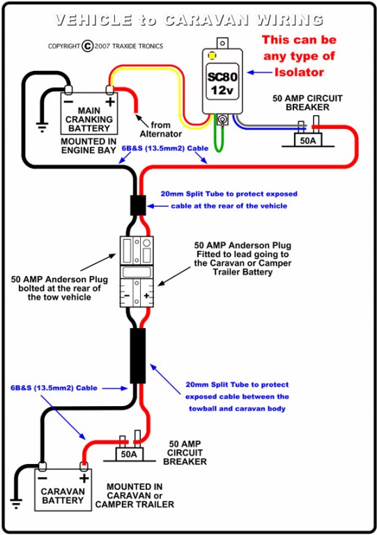

To charge a van battery in a timely manner we use a battery booster, DC - DC charger, DC charger or any other name you choose to call it. These devices are a bit like having a mains operated multi stage charger and feeding it with 240 V from an inverter fed by 12 V from your tugs alternator. The DC - DC charger does the conversion in one box and not two. One of the problems of driving a battery charger from an alternator is you loose power twice, firstly in the inverter and secondly in the charger. The DC - DC charger does it once in the one box so is way more efficient
When I first looked into these boosters 25 years ago there was only one model featured in Oz. Now there are many models on the market. Some are just DC chargers in the box. Others include solar regulators and there are others which have the battery booster, solar regulator and mains charger in the one box.
An excellent simple diagram. Much easier than trying to explain to somebody what to do. Thanks, Rockylizard for posting it. Is the wiring size refered to in the diagram, what is usually bought as 6mm?
Pete
03_troopy said
06:00 AM Jul 20, 2012
The wire in the diagram is 6B&S or 6AWG, which is equal to 13.3mm sq CCA (circular cross-sectional area of conductor) When you ask for 6mm wire you may end up with either 6mm auto wire or 6mm sqare cca depending on where you buy it. I think 6mm auto wire is about 4.6mm sq cca.
Pete
I also replaced all the 12v wiring from the tug to the fridge and battery with 6B&S.
David
