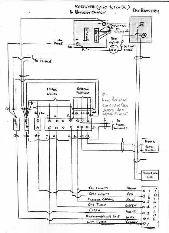

ps. I have traced out the wiring of the van as no wiring diagram was supplied. If you are that way inclined, let me know & I'll send you a copy as a general guide to your Jayco.
Thanks so much cupie.....that helps a lot....we had vans before with solar and deep cycle batteries,
but had never come across this system before.
Hubby would be interested in your wiring diagram, thanks

Here is the 12v wiring diagram.
I found the junction box under the van just rear of the hot water system & covered by a bit of tin. I put it in an electrical junction box to make it more protected from the elements.

Thank you again.....made lots of sense to hubby, very helpful, once this damn rain stops here in Tweed Heads......he will be able to have a good look!!!!
Regards Jan
