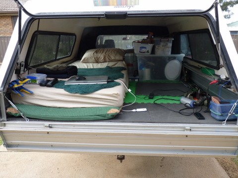

jetj said
01:14 AM May 22, 2012
Would love to see photos of how you rearrange things in the van Dawa. I'm always looking for ideas.

dawa said
02:26 PM May 22, 2012
hi Jeti;
At this time it is air bed on the floor......LOL
Dawa
