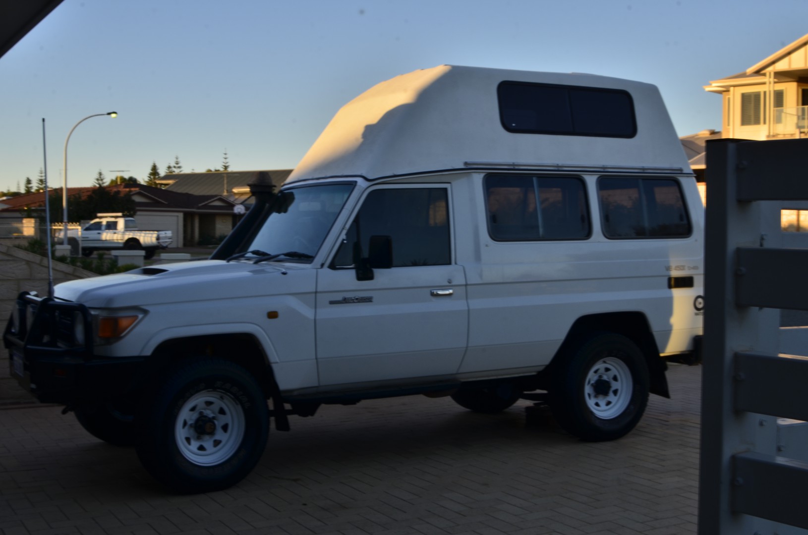

looking to set up my Toyota High Top camper.sorry posted a random pic,with solar(looking for help/advice)Perth WA
Thanks
Paul

melpal wrote: Hi i am Paul,looking for advice/help to put solar on my Toyota High Top.Many Thanks for any tips.Regards Paul
Jaahn said
08:42 AM Sep 2, 2018
Hi Paul:),
You have pulled up a 6yr old thread. I suggest you find the SOLAR subforum and look there for some ideas.
However your roof is small on that ToJo so you might be better with portable panels but they do take space also. What ever you do choose remember that heavy gauge copper is required in the wiring and a proper regulator/controller that has 3 stage charging is important. Many cheap set-ups particularly folding sets are crap made. The panels are OK but the rest is rubbish. Just buy panels from Ebay from places that have been suggested.

melpal wrote:
Hi Guys,
Thanks
Paul
Sikaflex a couple of aluminiun bars across the roof and bolt a 190 watt panel to them.Measures about 1500mm x 900mm and will help keep the car cool as well.I have 9 x 190 watt panels on my van and they keep it a lot cooler. Cheers.
