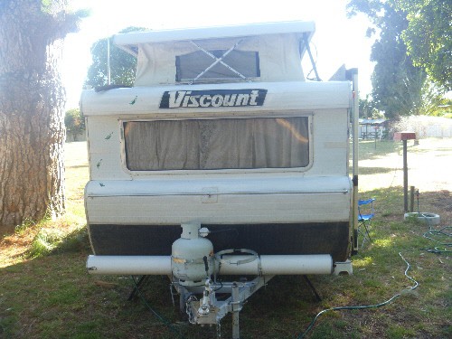

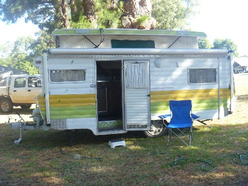

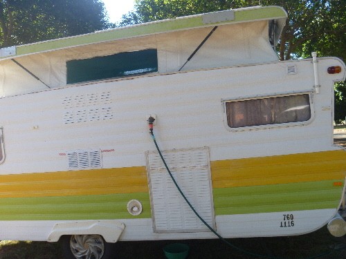

I'm having a kind of shakedown - am in Perth at a CP for a couple of days before dropping the caravan in for a new poptop skirt after finally getting her back from the autoelectrician who had her for 5 weeks in total. He did a good job of the electrics but did not leave a gap underneath the solar panels.... it kinda doesn't matter because I have a total of 390w so a little inefficiency does not matter. The panels can't be moved because they are stuck down with sikafix.
When I take the ute in to him for the solar panel and fit out I will make sure he leaves the gap. Anyway the van is lovely as ever and unfortunately I did not have time to pack all the ebay bargains.
Will save that for when I go camping with Yeoeleven provided he is not at the bottom of the Denmark River.
Nice unit there Elle, but I would look into the fact that the panels are stuck on the roof, I think I have heard that there should be a gap under the panels, not being an electriction I do not know for sure, perhaps put a question on the techie page, I'm sure you will get the correct advice there.
