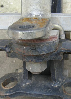

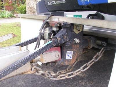

jimricho wrote:
(It has a Treg hitch which is not compatible with a WDH)
A Treg Hitch is quite compatible with a HR WDH whilst driving the highways and roads, including outback dirt roads and forest roads. When driving tracks etc where articulation may come into play then one just removes the WDH.
Both my old wind-up camper (heavy ball weight) and now the van came with Treg Hitches. I have used the WDH all the time without any issue. Would not leave home without the WDH.
There has been a few times I took the WDH off with my wind-up camper when the going got a little tough/rough. Once was when there was a creek crossing and the entrance and exit was a bit sharp/steep and on other occasions the tracks were pretty ordinary and some articulation was needed. On these occasions you are in 4WD and going pretty slow so it is not really a problem.

Ron and Shirley said
01:28 PM Jan 24, 2012
Jim
Hyman Reece use to make a special WDH hitch for the Treg which I had when I had my wind-up camper where the Treg was located at the bottom of the A frame.. Big and bloody heavy thing that I dont think they make any more. As you can see like the standard WDH but with a big solid bit underneath for the Treg. The Treg coupled down low with the bars going above the coupling. Suited the wind-up as the Treg was attached to the bottom of the A frame.
At the time, around 1998, Hardings Caravan here in Melbourne were just using the standard HR WDH and cutting the lugs/spigots off the bottom of the receiver and attaching as per a normal tow ball. As HR were making the special unit then I did not really like Hardings idea.
With my new caravan the Treg was attached to the top of the A frame and this special Treg WDH hitch I just could not get to work. Basically the bars would foul the A frame big time.
So I then followed what Hardings did, as having seen many examples of the same thing on my travels I now felt comfortable with the idea. I managed to pick up cheaply a second hand standard HR WDH and instead of grinding off the lugs from the bottom of the Treg hitch I used a spacer. Works and works well.

I had actually wondered about this, Ron and Shirley, my comment was based on the answer to a question I asked the HR rep at last year's Rosehill Show. He gave me contact details of an engineer at HR who he said was looking into this. I have thought that maybe all that's needed is a simple modification (if necessary) is to to take the spigots of the Treg bracket (that replaces the towball) to stop the bracket from turning.
As I treated the issue as somewhat academic in my case I didn't follow it up, if I was having a problem I certainly would have.

jimricho said
02:39 AM Jan 25, 2012
Thanks for that, I wouldn't like to grind off the lugs as they are there for a purpose. That spacer looks a good idea. I've owned the rig for three and a half years and each year I've towed it to Nth Qld without any problems. The ATM is only 1350 kg so unless something arises to change my mind I'll stay with the current game plan. If I do reconsider I'll look at a less expensive set up as well as the HR. I would even consider replacing the hitch with a ball, not a big deal to do, but as I implied earlier it's all academic, but thanks for the info anyway.

06:01 PM Jan 25, 2012
Jim, No need to modify anything to make a Treg hitch fit. Just get the bars that don't need modifying - http://caravansplus.com.au/images/350-05600M.tiff - have a look at the new style HR bars, they are similar to the Eaz-Lift.

jimricho said
04:26 PM Jan 26, 2012
Thanks for that info Peter, at this stage I'm not moving on this but I could change my mind at some time in the future as my rig tows quite well without one. If so I'll follow that one up.
If you check the images in Ron and Shirley's earlier post you'll see that there are two lugs (only one visible in the picture) on the Treg bracket that normally fit over the hitch receiver to stop the bracket from turning. It seems to me that this could foul on a WDH hitch receiver. This is why R&S have added the spacer under it. You may be more familiar with this than I am as I haven't investigated this very far.
