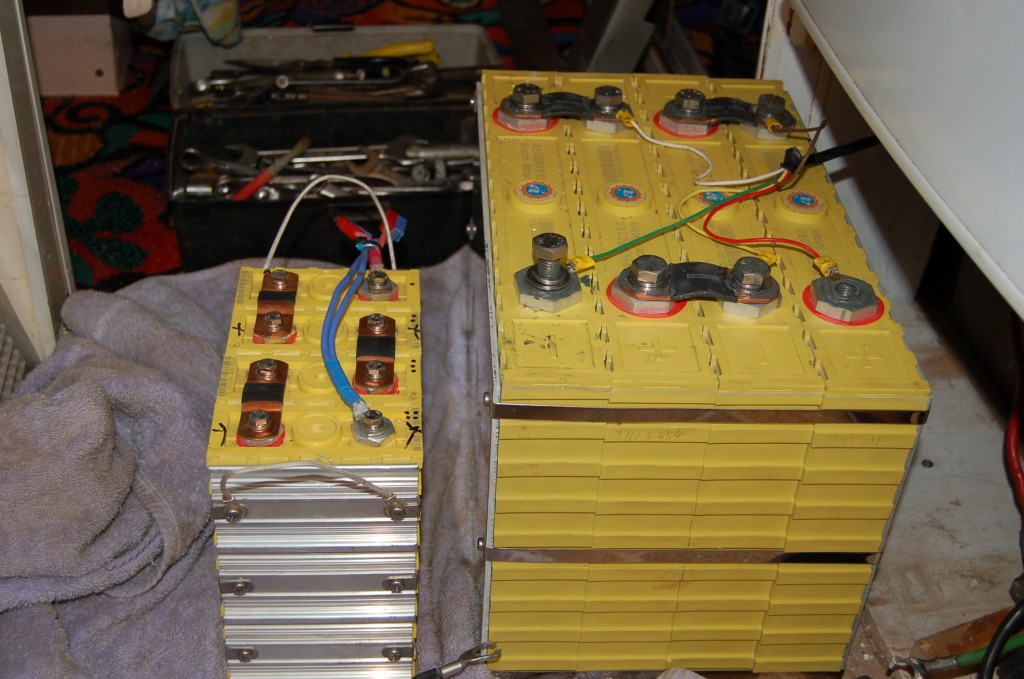

Hi Guys, There are Batterys and there are Batterys. I had a set of Fullrivers 2, 120 amph.. Worked them hard as we have a 2 door waeco upright fridge.500 watts of sola, They were ok but I didnt get a real good run from them. 2nhalf years- 3 years.
I now have a 200amph LiFepo4 battery 36 kgs and to say its like a v8 would be right.. No I wont go into details about it as there are to many naysayers. But will say its the best battery I have ever used.Very stable and with twice the grunt...,we now run 2 fridges easy..
Bob

As that's a Lithium Iron Phosphate battery I'm right out of my league here, but I guess you'd need to ensure that your charging set-up is compatible with this type of battery.
oldtrack123 said
09:19 PM Dec 20, 2011
HI Jim
AND that is where ALL the debate lies
There is no doubt about their capabilities
High power to weight capacity
Very fast charging if you have the power available
Very high discharge rates
very low self discharge
High charge efficiency
With their published life cycles it should be a one off purchase
But some users believe , only fairly basic charging systems are required
Only time will tell if they are correct & get the long life expected & needed to recover the costs
I will not go into the negative but they are around determining remaining state of charge, applying the correct charging so as not to overcharge any individual cell
They consist of multiple individual cells which require to be equalised to avoid over charging any individual cell
Also if a cell fails ,that needs to be quickly detected or ALL others in the string may be permanently damaged[series string] & even more problems with a series /parallel string if you require more than 90amphrs
NONE Have been in use in the RV area for long enough for any valued comment to be made using such basic charging systems.
Perhaps in 5years time we may know how those systems maintain the battery life
I would think that any poster who curently has them would have to say IT HAS been for LESS than 12months.
Bob
HI Jim

Hi Peter, Have seen your coments on other forums, and some of what you say is not quite right, They have been useing them since 08- and before. in boats, cars, buses, lawnmowers, satellites, 7 years on mars driving a lander there, and stand alone power for outback stations. There comes a time when you have to say it, people are useing them with out any problems , they do have to be watched "WHEN YOU USE THEM IN BIG NUMBERS' in cars,buses,ect. but one 4 cell batt in a caravan or MH. a $20 dollar cell logger will do all you want. and a low voltage cut out from Auto Barn for $30 will be all thats needed there . And a small under standing of what you have. Thats it........
Hi Bob
It seems some do not understand, here or elsewhere
I have not knocked the claimed perfomance/ advantages of these batteries in any post on ANY forum .
I have, on many occassions said I can see their technical advantages
What I have questioned & continue to question ,as in my post above is the idea that basic charging methods will lead to the high life expectancy that these batteries are no doubt quite capable of ,IF TREATED CORRECTLY
You are not suggesting that such simple systems as you suggest are used in any situation requiring high reliabilty, surely.
Also as you seem to agree the problems can escalate when one requires more than 90amphrs capacity[requiring series parallel combinations]
Your system is hardly set & forget
It requires fairly constant monitoring & manual corrections if required
Short term evidence may indicate no damge but will such a system /has such a system obtained the claimed possible life cycles ??
Evidence please AND that does not mean 6months, it means MANY years
IN practical terms about 10 PLUS years, for the average user
