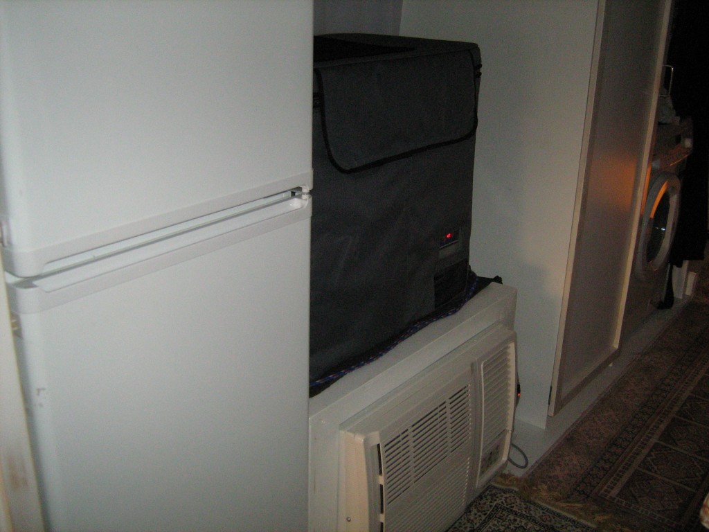

Hi guys, I have a Waeco fridge and it dosent seem to work that well,
when Im am pluged in to mains power its fine,but I have 2 x 200amp hour batteries and as soon as the volts drop a bit it stops working, it is supposed to cut off when volts drop below 11.5v .
I'd love to free camp but I cant because of this, i also bought a new 12/24v 80l fridge freezer and that also start to drop degrees as soon as I unplug from mains power.
