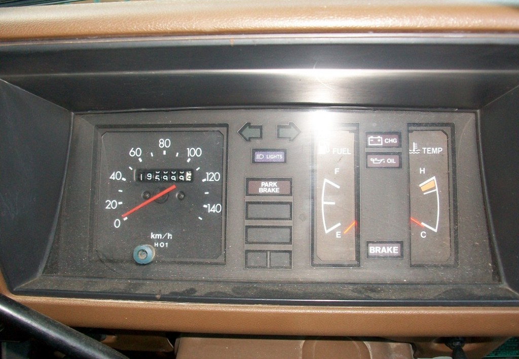

Pity you dont live closer Marg. I would happily look at it for you. Heres some pics of an electronic speedo with a mechanical Odometer, its out of an XD falcon of a freinds. The odometer on this doesnt work either, in the picture there is a cog missing(broken) betwean the white cogs on the left & the wormdrive on the stepper motor. This part, the price of $45 from a speedorepair place in Adelaide, this is the part price not what they would charge as i was going to fix it. Freind decided he would live with the odometer not working.

Can you post a picture of your speedo so i know what it looks like, as i spend a bit of time around a wreckers.

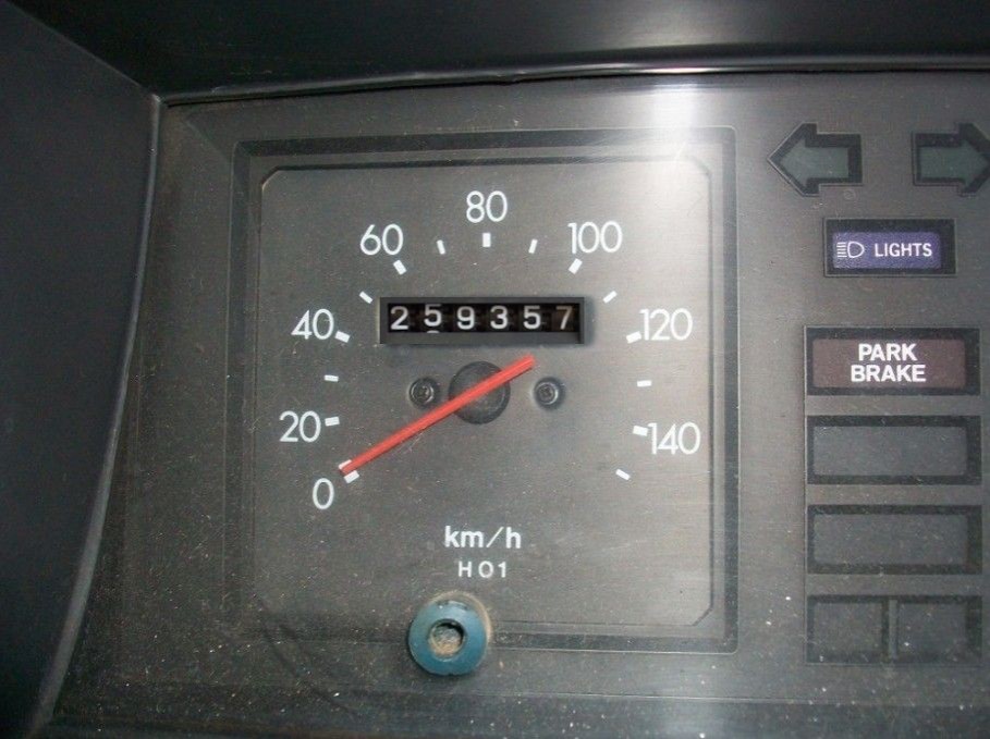

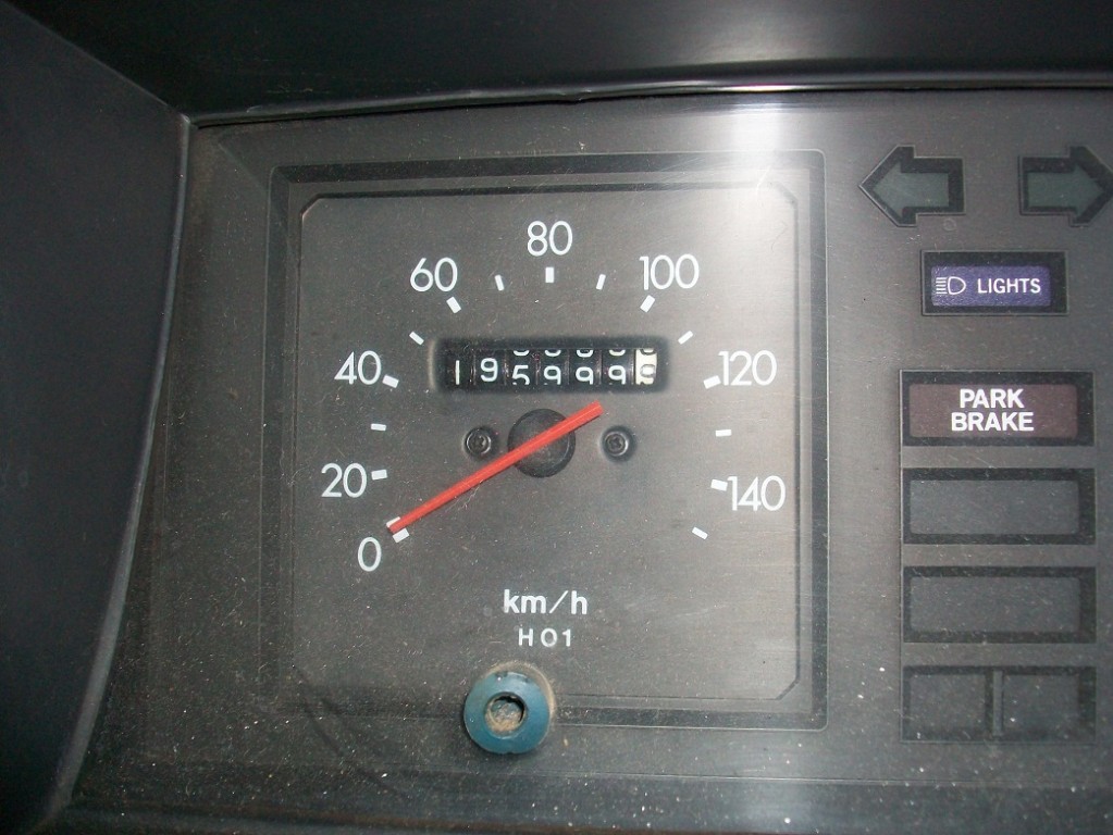

How stupid am I? Of course the odometer is inside the speedo. Don't know what I was thinking. Excuse the dust. Didn't notice it till I uploaded to the computer.
Can you see all the 9's. They go click, click the whole time I'm driving but won't turn over.

Thanks forthe pics Marge. Heres a pic of a typical odometer mechanism, the row of little cogs are turned one at a time when the previous number has done 1 revolution, will advance the next number by one digit. It would apear one of these cogs is either faulty or just jamed. Unfortunately to atempt to fix it the speedo has to be removed & then dismantled. The nex question is do you know any one close by who is retired & capable of fixing it cheeply?

Thanks for that DeBe, thats a good explanation. Think it is jammed as only happens when all the 9's come around. Other times it finally gets going again but this time it just won't move on. I will find someone sometime who can have a fiddle with it and see if they can get it going again.
