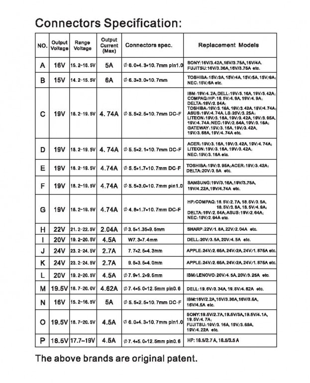

These are the 12v laptop power supplies from Jaycar referred to above:
I use the 90 watt one with my laptop and find that it is satisfactory in my case and think it would be for most laptops. Check the power requirements of your computer by looking at the label on your existing 240v power supply.
They come with a range of plugs to fit most laptops and will automatically select the correct voltage according to the plug used. This is dispayed on the unit so you can check it is correct before plugging it into the computer. I consider this to be a better and less costly option than using an inverter.
Note also Happywander's remarks about the need for a Pure sine wave if using an inverter with a laptop (or any electronic device). Unless the label on any inverter specifically states Pure sine wave assume that it is not.
I believe in only using inverters when there is no other option as they do waste power, even allegedly high efficiency ones.

At the risk of sounding pedantic and for the benefit of members and visitors to this topic who are not familiar with laptop power supplies I should point out that the device we're talking about is more than just a "cable" but is in a special "box" (with its own input and output cables) designed specifically for powering a laptop from a car's cig lighter (or other 12v source). This takes the place of the "box" that's in the lead that normally connects the laptop to the (240v) power point.
I make this distinction to avoid confusion with the many 12v cables that are available for connecting to various devices.
This is the gizmo we're talking about....(it comes with a supply of different plugs so that it can be attached to almost all laptops)
(use of Jaycar image is acknowledged)
