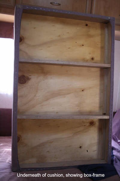

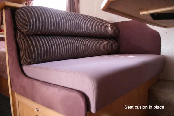

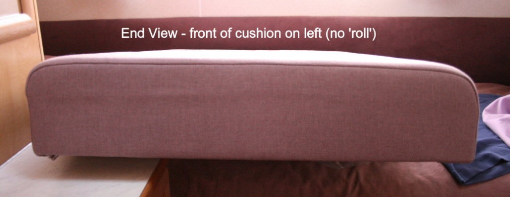

I fully understand the difficulty of getting van seat cushions that are comfortable and have foam that will actually last and not sag/compress.
We insisted on Extra Hi-Density Foam cushions when we ordered our van and it came with a 10-year Warranty on the foam.
Within the first year it had sagged where we sat mostly and we spoke with both the dealer and the manufacturer. They sat on the seats and refused to agree they had sagged no change under warranty!!
So I bought some meranti - light weight but strong wood used in caravan construction and built the seat frame, and took it to an upholsterer to attach foam and cover. We were able to sit on samples of the foam he had and finally chose 30mm hi-density foam used on kitchen chairs.
Now, more than 12 months on the cushions are still excellent provide support, comfort and have not sagged where predominantly sat on.
Attached are photos of the outcome.
-- Edited by rockylizard on Friday 9th of September 2011 11:34:55 AM
