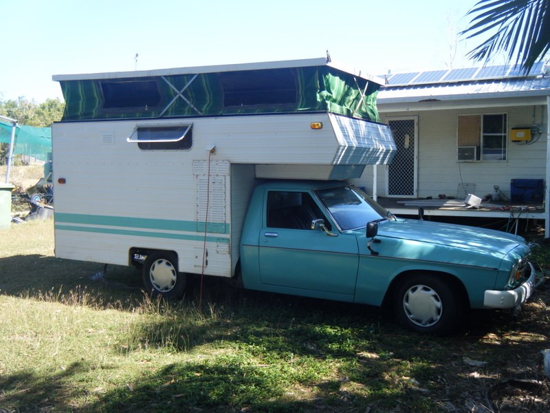

Just come back from my first trip in the hj motorhome and getting 6 klms to the liter. Is this good or should I look at converting it to dual fuel. It had gas on this engine before I bought it but was taken off the vehicle. What sort of fuel consumption do you get on gas? I would apreciate some help.Thanks, Bill
