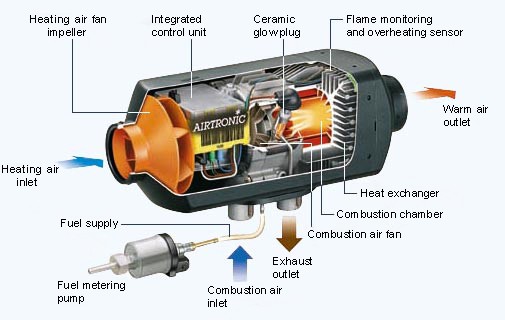

This type of heater can have either Gas or Diesel as the fuel.
They are a Heat Exchanger.
The cool air from inside the vehicle is circulated over the "Hot" outside wall of the combustion chamber. Then circulated back into the vehicle. Through air pipes and vents (just like your car heater) It does not have any Burnt Gas or Diesel fumes or Carbon Monoxide in it. It's just Warm Air. As no contact is made with the burnt fuel residues.
The fuel is burnt in the combustion chamber. Like a tiny jet engine or kero blowlamp.
Combustion air is sucked in from the outside of the vehicle to the combustion chamber. Mixed with the fuel and burnt then piped out side again.
All the exhaust fumes and gas is piped outside of the vehicle. Exhaust pipes may well include a little silencer/muffler.
Peter and Margarets post with the Webasto thread is well worth a look at.
