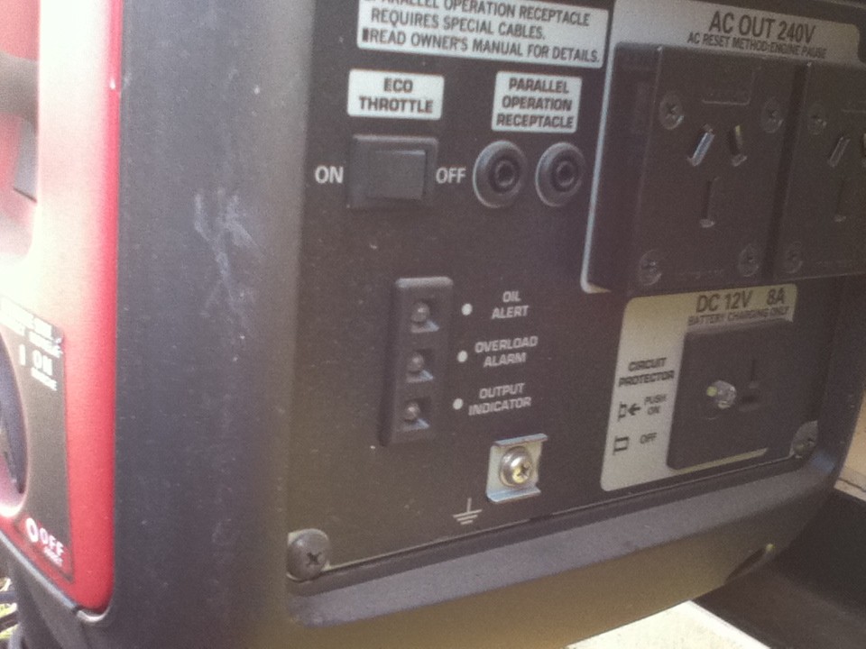

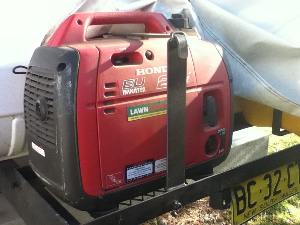

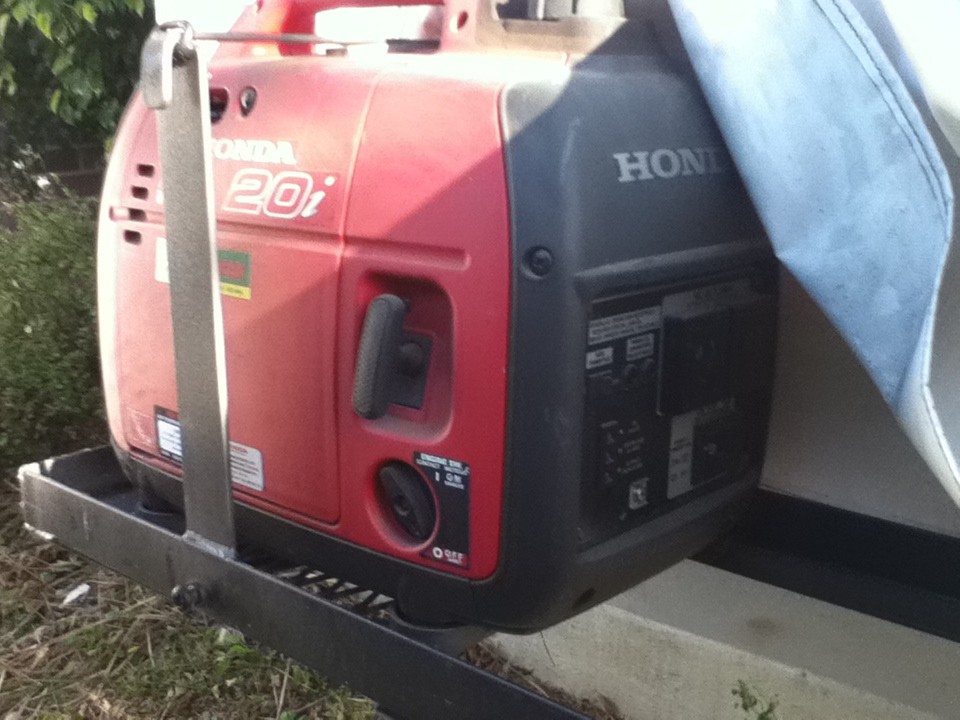

milo said
12:48 AM Jul 8, 2011
heres some pics of our generator set up
i think if were at our set up during the day the van keeps warm ,
Generators need air to run and produce fumes. This means that running in an enclosed space unless are a no go unless the space is designed for it. You need to be certain that you are not getting fumes into the van as these can be deadly in an enclosed space.
Cheers, Nichol
This is too true Milo. I seem to remember a young man dying somewhere up north during Cyclone Yarsi, because he had a Genny running in an enclosed room at the time. Only about 19 I think.
but night time would be the tricky part
i knew it was a honda
