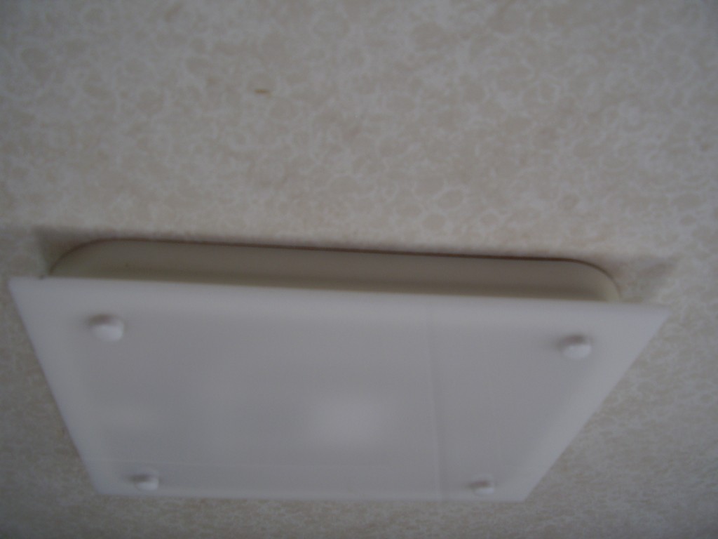

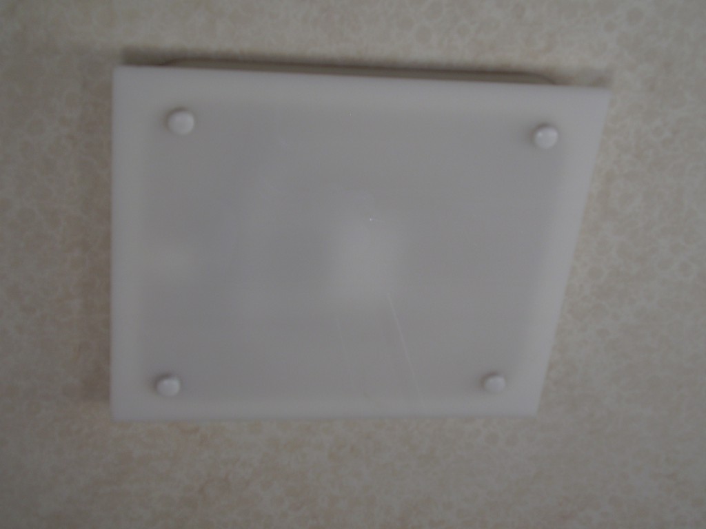

Yes and no, is the appropriate answer at this stage - what we are doing for the moment as we are running out of time to get the lights changed over, is to add spacers to each screw and place a flat piece of 'milky' perspex over the top, sort of making a very modern looking light fitting. Hopefully we can get it done and post a photo before we head off next week - if not will be done when we get to Canberra, then I will post a photo - then the above will hopefully make sense.

Well the new 'shades' are up and I don't think they look too bad, Pete's not sure, so will 'live' with them for the next couple of weeks, then make 'an informed decision' as to whether they stay or they go and we bite the bullet and completely replace the lights. Went to take a piccy - the batteries are flat in the camera - will get some new ones tomorrow and will then post a photo for you to see.
June
Got the said batteries today, took the piccies, what do you think.
-- Edited by Pejay on Monday 16th of May 2011 04:04:34 PM
I like the retrofit, the new diffuser's look very impressive, good job.
Did you make them yourself our have them made?
Regards Jim
Pejay said
07:48 PM May 19, 2011
Hi Jim
After a couple of days on the road, we too are quite pleased with them, and all they are is pieces of milky perspex cut as rectangles - $6 each from a local perspex place, longer screws and the white plastic caps that go over the screw heads.
