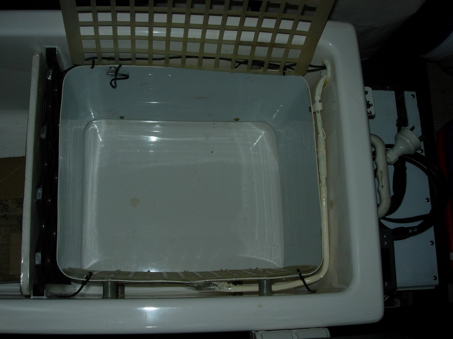

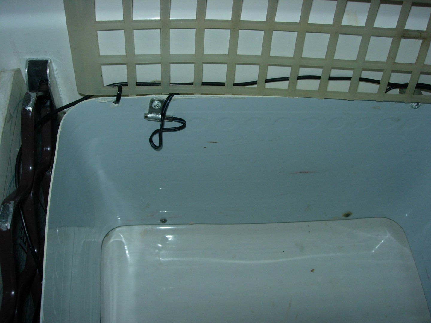

Had a Waeco CDF-40 that the foam insulation had absorbed moisture & was afecting the insulation propertys. So i cut it up & found the insulation is only 20/25mm thick. Since i had a good EvaKool fibreglass Esky & its insulation is 40mm thick. Decided to convert the esky to a Fridge/Freezer using the Waeco parts. It apears to work quite well.
DeBe said
07:34 PM Mar 25, 2011
Have decided after some thaught to enclose the compessor, & fit an ajustable barrier in side so it can be used as a freezer oneside & fridge on the other.

looks very much like my evercool fridgemate
cheers
blaze
Inside looks a hell of a lot like my Evakool ED70 fridge /freezer.
Cheers Keith
