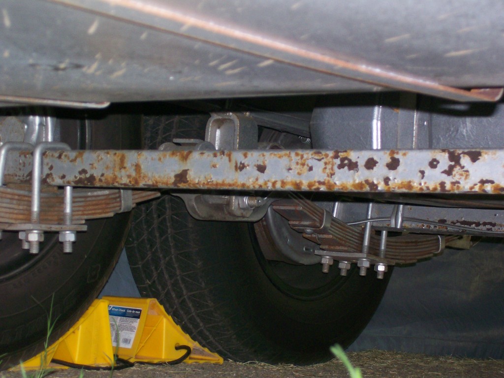

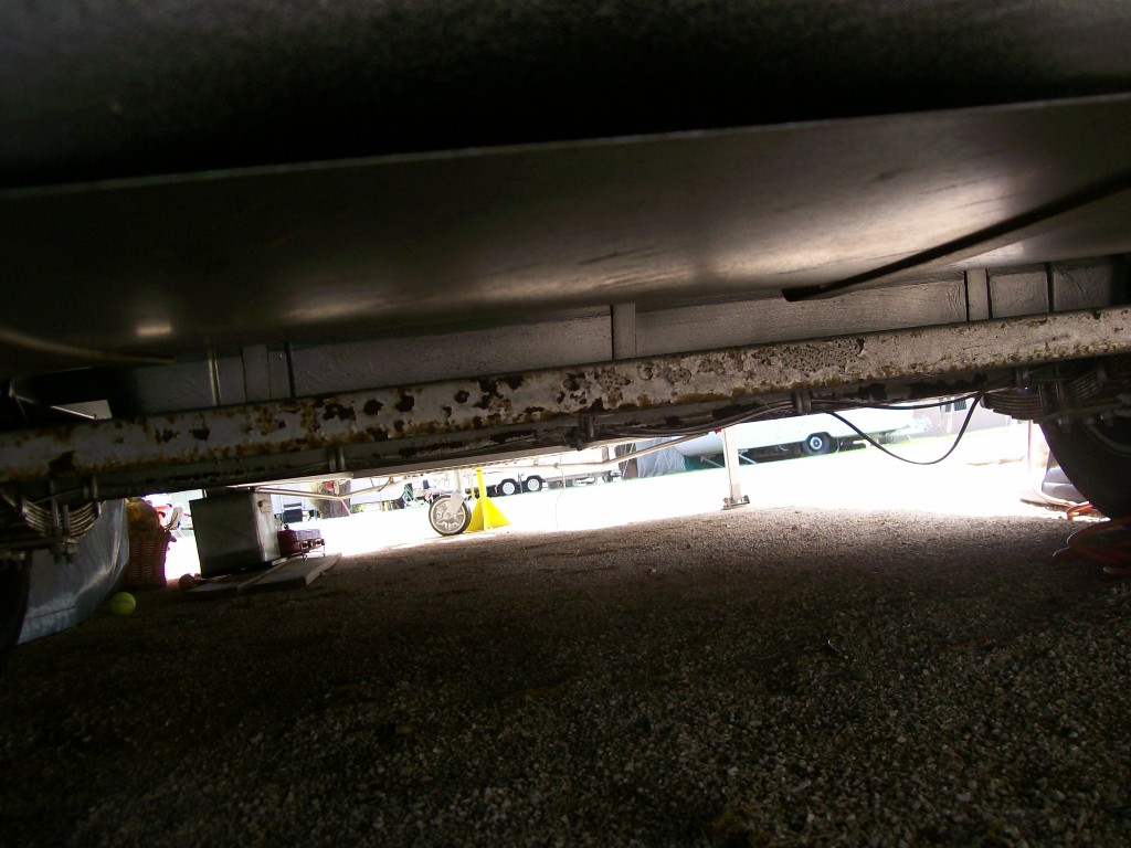

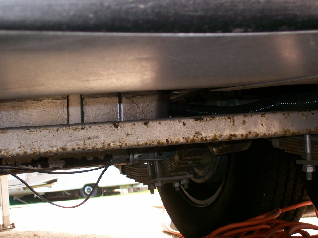

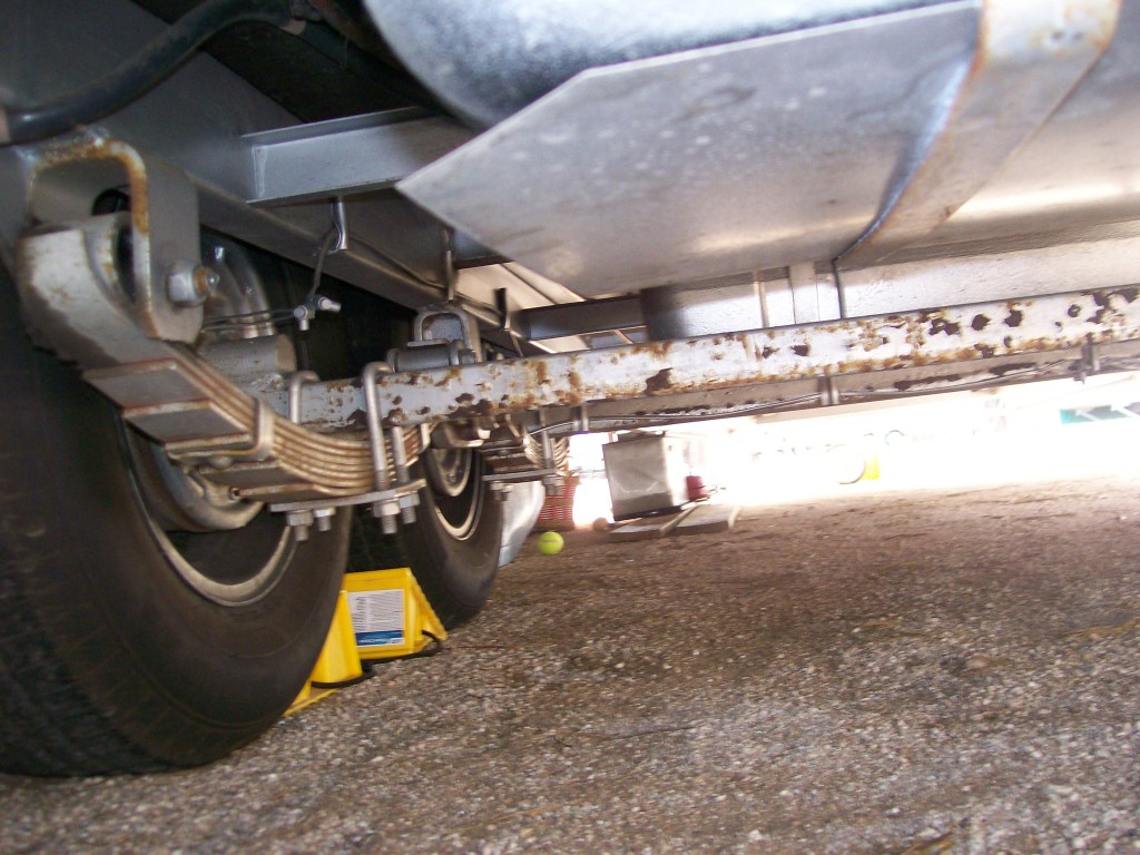

Hi folks, I would like your comments on the rust on the axles of my van. It was delivered to me (new) in June 2010. (now 9 months old) Purchased from Noels Island Star in Adelaide. Built by Spaceland in Melbourne. Rust started to appear on gas bottles and chassi after 3 months. I approached Noels about the rust and their response was "this is normal wear and tear from parking the van on damp grass". Or stone damage (note - the rust is on the rear of axles). Needless to say we are in delicate negotiations at this time. I am not very hopefull of a resolution though because of the following :- We live in our van full time and when I had approached Noels in the past to address a long list of problems, they said I had to return the van to Adelaide. When I explained that I would have nowhere to live while repairs were done, their response was "we can not help you as we do not cater for people who live in their vans" and hung up the phone. I was aghast !!
Consequently I have repaired all faults to date, myself at my expense !!! Cheers Very disolutioned Doug P.S. I can provide a list of faults to anyone who is interested.
I would think the problem isnt rust apearing but paint blistering and disapearing after painting a rusty piece of steel to make an axle, My thoughts are that the axle is solid steel and not RHS in duragal. So the problem to me is poor prep before paint.
If it is RHS I would question the integrety of the steel, how rusty was the inside before becoming an axle. A possible solution would be to go to aderlaide and find a CP that will let you sit the van on blocks, get a mobile mechanic to come and drop the axles out and then take them to the manufacter for replacement.

What you've experienceing is quite common, or even the rule. The axle on the Island Star are to the best of my knowledge Alko, but could be from batches manufacturered and supplied to them by Melbourne Caravan & Trailer Suppies. All these axles are made from square 'Black Billet. These billets have a outer skin of mill scale which rusts quite quickly. The rusts generally only penetrates to a depth where it comes into contact with the raw steel underneith the scale and stops there. After the stub axles have been machined on the ends of the billet (Or welded on in the case of an overlay axle) the spring location plates positioned and welded and the the axle bent for camber, they are lightly sprayed with 'Cold Gal' (Zinc) paint to prevent rust showing during transport and installation. i'e purley cosmetic value. It's only surface rust and will not be the cause of any axle failure. If you want to keep it looking nice then hit the axles, fish plates, brake drums etc periodically with a spray of Cold Gal (Killrust etc). Whatever you do will soon be removed by stones and gravel strikes as you tour. Cheers, ozjohn.

HAD THE SAME PROBLEM WITH MY SPACELAND AT THE SAME AGE & GOT THE SAME ANSWERS AS YOU, I JUST PULLED THE AXLES OUT, SANDED THEM BACK TO BARE METAL AND REPAINTED, NOT WORTH THE HASSLE AND TIME TAKING IT BACK TO SPACELAND

Just poor prep before painting combined with a little stone and grit damage, scrape it back and repaint will silver kill rust . Most of the silver bits on a van are merely coated with cheap wheel silver or silver frost and will peel off over time . As said not worth the hassle looking at warranty claims . give those springs a re-coating while at it .

Most of the chips and rust on the axles in question are BEHIND where the stones may hit. The van tyres wouldn't kick up the stones to hit there anyway.
I was aghast !!
P.S.
Cheers, ozjohn.
