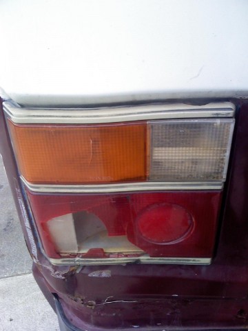

I would like to ask some kind experienced fellow grey Nomad....How do I remove the L H tail light lens...I have a new one to put in and after removing the six nuts inside the boot and light assembly...It is still as tight as the proverbial Fishes posterior..
I don't want to wreck anything I don't have too.....Please help!

Hi Welcome, If you have removed all the nuts at the rear of the tail light it could b the sealant around the tail light. I have found this to be tight around some tail lights you might have to leaver it out.

These things are usually screwed and glued to seal it off at the back.
If you carefully lever it off not to damage the base on the bus it will all become clear.
There may be a gasket on the back as well. If there isn't one on the new assembly, you may need to use it on the new one, so go easy.

Its possibily had a water leak around it at some time , so a fool has used some thing like urathene to seel it , if this is so you will have to cut the sealer where ever possible.This is the same stuff they fit windscreens with & has to to be cut.

and then there the common problem i had with coaster RUST had stuck it all together --used rust eater took awhile but eventually worked
