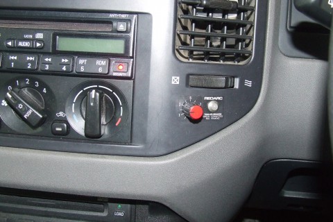

Jim I had to go with redarc....theres just no where to mount the Tekonsha...in my Pajero..under dash and your knees are hard up against it.....well my were..admittly I'm 6ft5" tall...I mounted it under the right vent ...right of the radio on centre dash

Dave thats a neat job would have to be happy with that

Thanks again Dave, looks a really neat set-up. Much neater than my Hayman Reece controller installation.
Does the Redarc have to be readjusted between highway and town use? With the HR unit, if set for highway use it will lock the wheels in town and if set for town use it's ineffective out on the highway.

I find its a bit touchy in town...but I'm blaming the new van's brakes as they havent been adjusted yet .needs more wearing in they say....best part having the controller there..you can see exactly what your doing..........not thumbl'n under stearing wheel feeling for the controls..........control goes from 0 - 9 ........auto electrician said most set theirs on around 3.5..depending on van weight and brake setup......the red button also is emergency controller...press it in if your van starts swaying..
