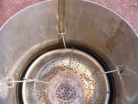

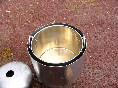

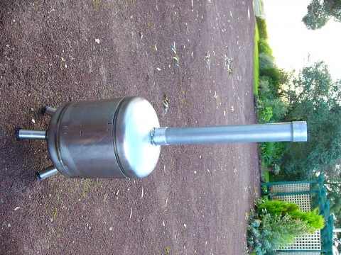

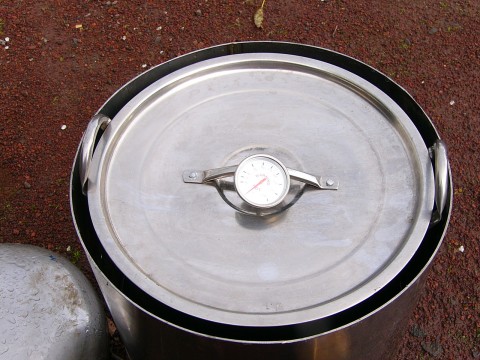

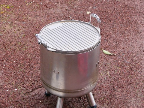

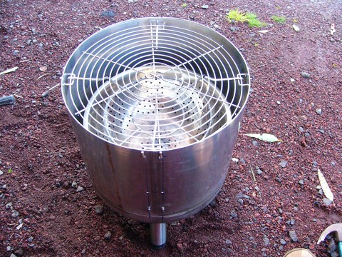

I have had a couple of weeks off on compo so needed something to do. I made this choofer from an old stainless steel car gas cylinder from a wreckers.
Cost to date about $25 for stainless steel nuts, bolts, welding rods and cake rack.
Ideas taken from choofers, Cobb cooker, Campoven Mate and using a Kelly Kamper Kooker to hold fire/ heatbeads. Designed to bake, roast, grill, BBQ, smoke, and as Pot Belly stove. Still to do, put rotisserie on top, and find a suitable gas ring to fit. At the moment can use heatbeads or wood. 6 heatbeads will bring oven to 220 deg C. Its all fun, eh? Keeps me out of the Boss' hair.
Ian

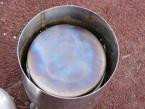

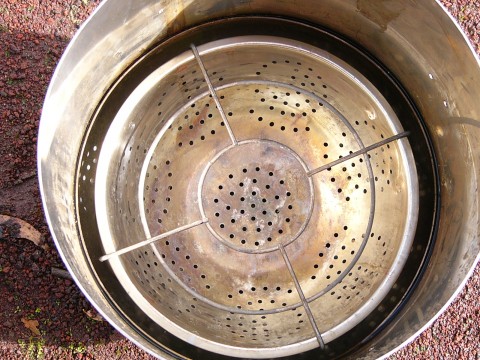

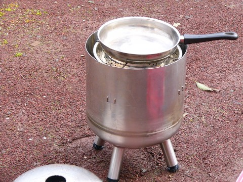

Ian
-- Edited by iant on Monday 6th of September 2010 10:39:06 PM
