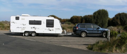

I have a 2003 Paj, same as yours, you won't be able to get the type of mirrors that fit over the existing ones due to their odd shape, so you'll need the type that mounts on the door. These are a bit more expensive but some "experts" say they're the better set-up. They're the only type I've used so I'm not in a position to enter into a debate on that. They do tend to vibrate slightly but that may be common to most of them...

Hi jimricho and once again thanku for the valuable info. Have to agree the Pajero isnt easy to fit thats for sure but I love it! Also thanks for the close up of the mirrors. Cheers Robyn.

You're welcome, no problems mounting the door type, also thebit that rests on the door is padded so there's no scratching worries. The photo was cropped out of an existing one so didn't need to do it specially, you can probably see it was taken at the same location as my profile photo.

Haven't had any problems with denting or scatching. Since taking that photo I've since readjusted the set-up slightly so that the centre buckle and pad sits on the door a bit better, also glued a small pad of marine carpet (about 60 x 80 mm) to the pad but this is to fit the door better and not to address any (non-existant) scratching or denting problem. The pad is not magnetic or suction cup, although I have seen both types advertised.
When I purchased the mirrors I had little choice of type as I had just picked up the Goldstream and didn't have any towing mirrors so I went to the nearest caravan shop and that was all they had that was suitable. They fitted and adjusted them for me so I was able to get on the road and head home.

If you look in the picture in my earlier post you'll see that the pad is sitting in a bit of a depression in the door panel. I've set ut up a little bit higher and that in combo with the carpet pad means it now sits a bit more solidly on the door. By using marine carpet I don't have to worry about it remaining wet and going mouldy and I had plenty of small off-cuts of marine carpet on hand anyway.
