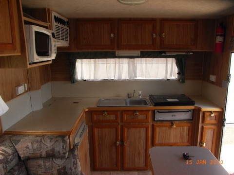

Having recently purchased a Caprice Eclipse (2000 model), we took it for test run to the Rollingstone caravan park just north of Townsville. Wonderful park and enjoyed our stay although we had to cut short a day because of the weather.
Two problems became apparent with the van and I was wondering if anyone had some advice/suggestions please.
The airconditioner (Electrolux Blizzard) is at the back of the van and set into the wall. See attach photo. Very little cold air makes its way to the front of the van even though the air directors are around as much as possible. Possibly too much as I suspect they may impede the flow of air. I was thinking that a re gas may be in order as the output is not that cold at all.
The refrigerator (Electrolux 3 way)takes so long to get cold on 240 volts. Again I was wondering about the re gassing. I confess that I didn't try it LPG or 12 volt.
As both units are close on to 10 years old and the previous owners lived "onsite" for six of those, I believe that they were being used consistantly, I was wondering if they were past their "use by" date.

Graeme A couple of things to check on the A/C, before getting it looked at, in case you are unaware.
There is a filter behind the facia for the evaporator. This gets blocked, and may need cleaning. Also, some people remove it all together, which is not good, as then the evaporator fins clog up. If this is the case, clean as best you can, but removal of the complete unit, is the only real way.
Secondly, the condensor (at the back) should be vented to outside, through a grill. Check that this is clear and if possible, remove it and clean condensor fins.
These two things are classic causes of low air flow and insufficent cooling
Gee its in a bad position, opposite the door and across the van

The aircon is in the worst possible place for a van.
I installed a split system on the back bumper and placed the inlet above where the range hood would be. I removed the range hood. I don't cook in the van and the aircon does that job to a certain degree.
If you a reluctant to change aircons then you may have to do some big maintenance on the original one. It probably will be more efficient if everything is still working as it should.
I also have a desk fan oscillating the cool air around the van.
These 3 way fridges can be temperamental so you probably need to try all the recommendated ideas. Starting it on gas to get it down to the temp you want is a popular idea.

Thanks all for your suggestions. I agree that the A/C is in a bad position. I am considering seriously of removing it and installing a roof unit in the mean time perhaps a fan will help. Are there any suggestions for the brand of A/C I should put in? The boss is keen as it will give her more cupboard space. With the fridge, I will try using lpg first.

We have a Heron AC in same position as yours. It does cool van down - has worked in 45+ temps. So before you abandon it, try the solutions previously suggested. Before you go for a roof mounted model, find out through forums, how many people are happy with these - I have come across some negative comments.
Three way fridges are rather notorious for not working well in the tropics. Try regassing, but you might also consider a compressor fridge. Our compressor fridge has needed regassing twice in 12 years of fairly solid use. Our 3 way Chescold camp fridge has had at least 3 regasses over about 18 years. The compressor fridge didn't miss a beat when we lived for several months in temps 40-50.
