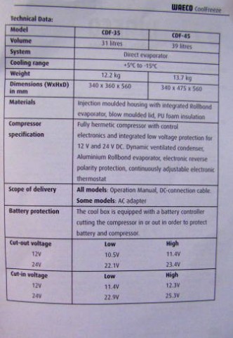

Hi Hylda& jon. I have been trying to find info on theseCDF035. Waeco sent me a catalogue but it doesnt tell you what the current draw is on 12V which i would like to know? They use a Chinese compressor (2yr warranty) . the CF40 usesDanfoss compressor (5Yr warranty). I have a CF 40 which runs on a N70ZZ battery with 100W solar panell as a frige it more than keeps up, as a freezer doesnt quite keep up. Can you post a picture of the control panel as the Waeco catalogue doesnt show it? Very interested. Cheers Daryl

Thanks Hylda&Jon for that info & photos pitty there catalogue wasnt more informative & I notice the spec sheet you posted they havent put the current draw, which is surprising since its hard to compare this model with a CF40 considering it uses a different compressor. The spec sheet for CF40 has every thing listed. Just wondering if there is a plate on the frige underneath with curren draw? cheers Daryl Ps sorry about the inquisition just i used to be afrige repairer & curious.

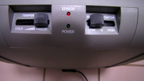

Hey Daryl No help from the plate on the underside of the fridge sorry but after a bit of googling I found a document about different fridges on an American recreational vehicle website - ' http://www.awardrv.com/ ' it said:
Waeco Coolfreeze CDF-35
Weight: 15KG,Capacity:31Litres W340 x H380 x L1.560mm, 1`2 or 24 Volts Average Power Consumption = 1,01 amps/hr. Holds 37 cans
What that means to my deep cycle battery is beyond my feeble knowledge and It wouldn't refer to it being on freeze mode as I intend to use it but it seems the common consensus is about what I thought-24hrs. I hope the figure is correct & helps you Jon
