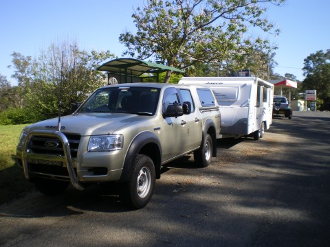

We have a Ford Ranger, 3ltr Turbo Diesel. One of the best vehicles we've had. Runs like a dream, pulls as if there is nothing behind. on average we use 14.1 ltrs per 100 towing an 18ft van.
We like the convenience of having the room to carry all our outdoor things in the back when we are travelling, it's very convenient and sure saves stacking tables etc. in the van.
If you want a technical point of view I will get Rob to post something later on today.

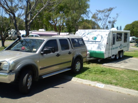

We drag a 17ft pop top(duel axel) with an 05 Holden Rodeo turbo deisel 3 litre. Bought it second hand near new with bull bar, lights, snorkle and running boards for a good price. Fitted a canopy subsequently. Lots of space etc. have had no dramas with the rig but as with any 3 litre diesel I would like a little more power. Not as good a finish as the Hi lux for example but a lot cheaper generally. I get 14.5 litres to 100ks fully booted and spurred with the aircon going etc. The low pop top van helps a lot when we are butting into a wind. Note to techies out there:
I have been told by all and sundry that you should not tow in fifth gear. I only do when going down grades or on flat roads with tail winds etc. Mostly I am in forth gear doing 90 ks an hour at about 2.7 thousand revs. Anybody heard anything different??
that worries me.........your vehicle should be able to run in all gears...if not then the setup is wrong.or its overloaded.....
Ball weight........checked my campertrailer...ball weight.was 120kg.....trailer weight loaded is 840kg....has brakes fitted
