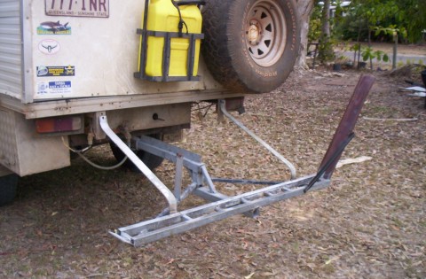

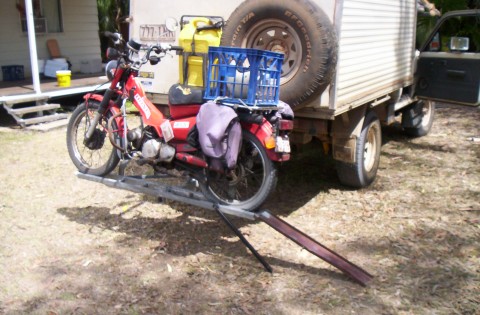

Hi Pauline. I have a rack that I made so I can carry my postie bike around on the back of my hilux 4wd. It has a fold down ramp which I drive my bike up to be tid down . it involves no lifting, and its great to have transport once you set up camp somewhere. If you want, I can send you some pics.H vae you got a towbar? Give us a bell if you want more help.Bill
PML said
07:53 PM Dec 11, 2009
Hi Bil12. I'd appreciate a few photos to see what you mean. My tow ball fits into the step-plate at the rear of the van. I have a normal bike rack that would fit on that, but I would have to lift the bike up onto it - impossible. Your idea sounds good - would it allow me to swing it out of the way so that I can lift up the rear door? Cheers Pauline
bill12 said
10:27 AM Dec 14, 2009
ok. I will take some pics, today,14/12/09
bill12 said
11:23 AM Dec 14, 2009

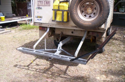

Hi. Don,t have a rear door , so don,t know if yours will open , but I am sureyou can modify it to miss.I have a hayman reese towbar , and the bike rack sits in the square towbar reciever. you also bolt it to the back of the van for more support.enclosed are some pics I took. I hope this helps you. To carry a push bike , the rack would not have to be so strong. Bill
oh hell Pauline, I've been getting home so late I forgot about you
If you follow Bill's plans as above and substitute the square tube (haymen reese fitment adapter) and replace that with a suitable straight section of steel (2" x 3/8") with a 50mm hole drilled into it then it will fit yours, use the 50mm hole that you already have in your step to bolt the new system on to it!
if you then make another "upright" at the other end of the rack to clamp the front wheel on as well as the rear "ramp" then I think it would be fine
if you make the front one fold down the same as the rear one then clearance for your rear door would not be a problem!
you will not need the two struts as shown in Bills design as your bike is a lot lighter
if you can find an old steel bedframe and salvage the angle iron off that to make the ramp then that would be ample and cheap
sometimes an old steel bed can be purchased from an op shop for $5
