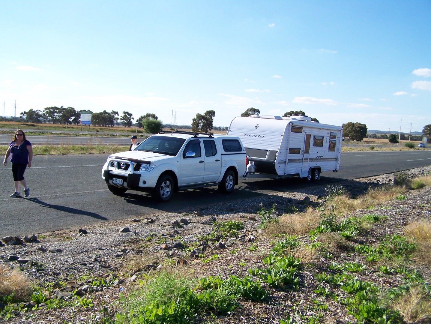

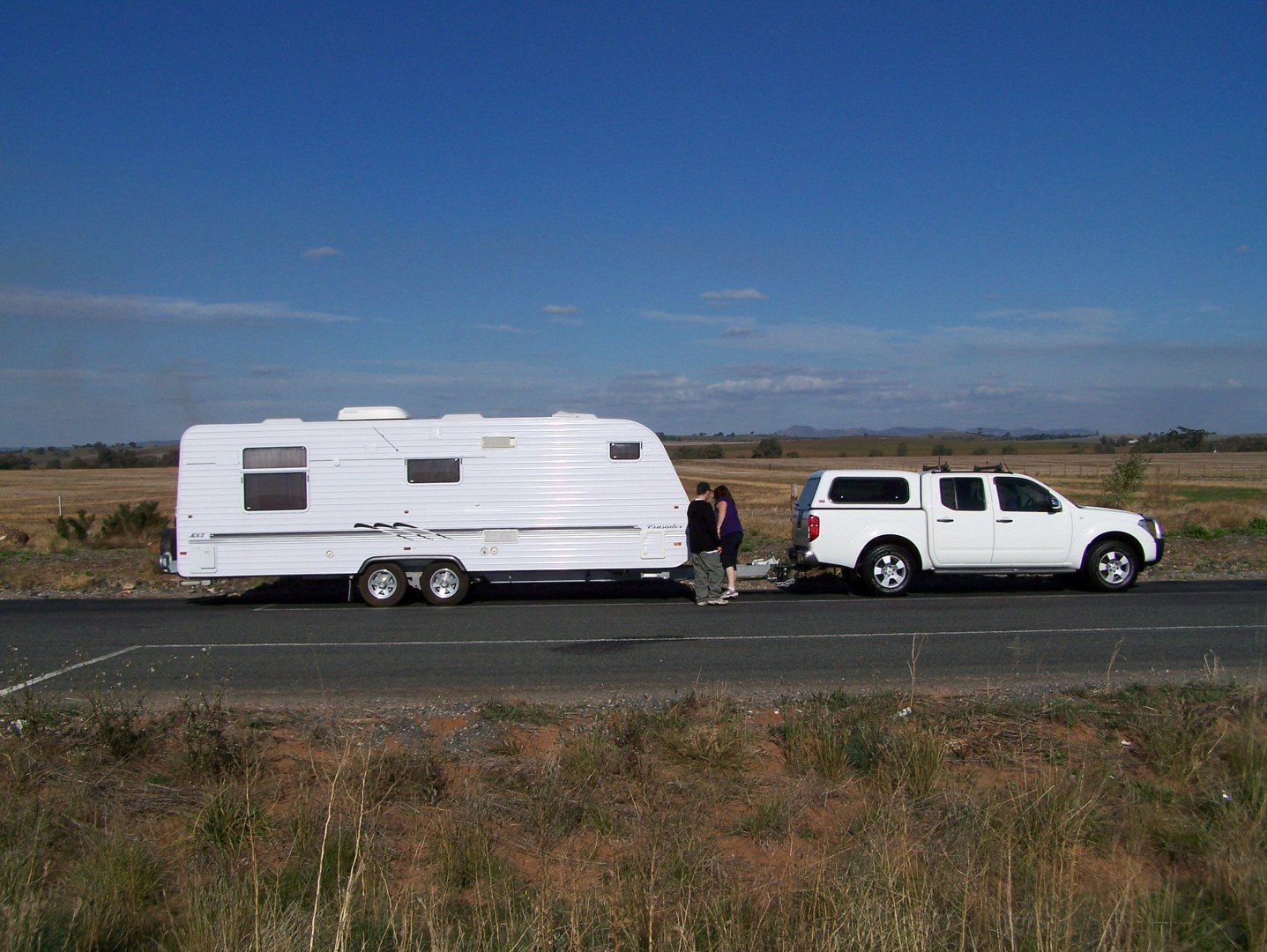

Hi all - we are newbies on this site. We have an 07 Navara auto STX turbo diesel, towing a Crusaider 22 ft family van (close to the 3 ton max) The Navara tow's it well at around 85 to 90 KPH. The Crusaider van has been used twice in 2 years (purchased it new) in a nutshell I am very disapointed in the quality control of the van as we spent 1 week mainly free camping in it last week. Firstly it was a HORROR to tow with both water tanks full, the 2 tanks are both mounted rearward of the tandem axle instead (like other manufacturers) one foreward and one rearward of the axles, I have just spent all day relocating the rearmost tank foreward. My son observed the wall between the bunks and kitchen moving, the idiots screwed the bottom of the cupboard into light ply causing the wall to break away. Our silly fault but at the first powered site we encountered we used the solitary electric hotplate on the stove only to find it did not work (first time used, out of warranty). When I moved the water tank I noticed with horror that the shower outlet drain plug underfloor crossed a chassis member, this had been cut out with an angle grinder (how rough is that?) without plating the missing piece of chassis. A power cable runs through a welded chain link on the chassis meant for the hand brake cable a potential fire hazard, if rubbed through. The toilet door is out of square and warped consequently very difficult to close, other furniture fittings leave a lot to be desired. The plastic external fridge vents "blew off" when a semi overtook me, I replaced these at $75.00 each but put 2 stainless steel screws in the ends to ascertain this wont happen again in the future. I also replaced the mag wheel centres as they were heavily rusted (remember its only 2 years old) aftermarket replacements= $60.00, perished plastic handels all around and 4 seasons hatch door comming adrift, the water pump, although good is placed in the only usable cupoard space in the kithchen area instead of less useable space and the list goes on. I was a very happy 18ft Pop Top, Jaco Westport owner prior to this, unfortunately our son outgrew the 3/4 size bed so we opted to the much larger Crusaider van. We are Very disapointed, but working on the van fixing the problems one by one - very poor for a van that I pad in excess of $75,000 in persuit of the quiet life......
Check the weights carefully and not by just reading the compliance plate.
If it is a centre door model pay particular attention to the ball weight which can be excessive.

Hi Guys, thanks for the advice. I will be taking my rig - fully loaded (including water tanks) to have the ball weight measured and re- adjust the Hayman Reece set up. Hopefully this will stop the horrid swaying above 85 KPH
