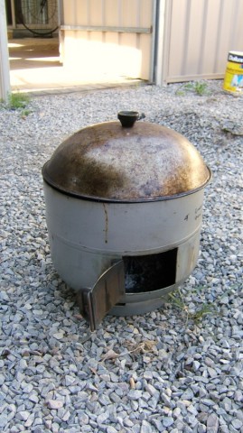

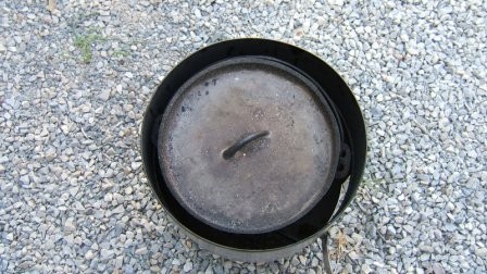

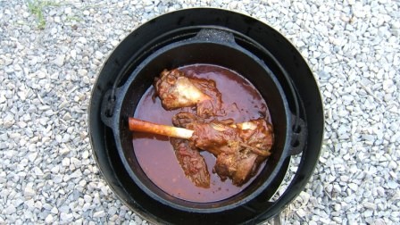

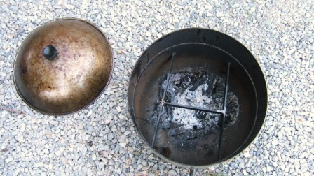

Gary and Kerry said
09:30 PM Oct 31, 2009
Finally got around to making a choofer. today was the big test, cooked my famous lamb shanks, beautiful.
Does anyone have plans/design or pictures of one?
