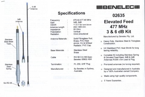

Just installed a ICOM 440 and a 6.5 db gain whip . I got the 440 as it can be mounted under the seat and all the controls, channel selector, vol and speaker etc ;are located in the hand piece.
The antennas are the key to performance there is a good diagram on the BENELEC site which shows that 3db gain is good for hilly terrain and a 9 db is good for straight line such as flat stretches in the GAFA . There are quite a few antennas out there all with different performance data and vehicle mounting location setups . .
The one I got is not top of the market but came with both a 3 and 6 db gain whips for less than a $100.00 The radio came from Repco at $370.00, book price elsewhere $489.00. Fitting DIY, no big deal just follow the destruction list, if still unsure get onto the forum for a tune up on how to stuff it up big time. LOL

Wombat 280 said
07:32 PM Jul 3, 2009
Here's a copy of the Benelec cattledog showing the antenna I have set up with the ICM 440
