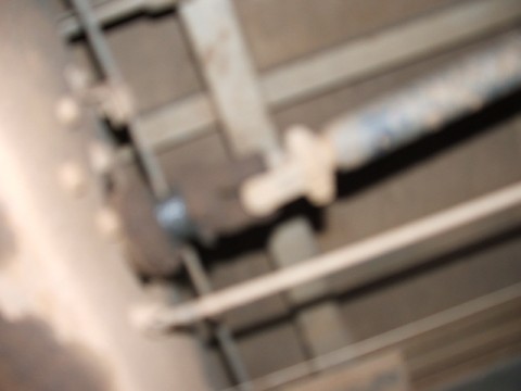

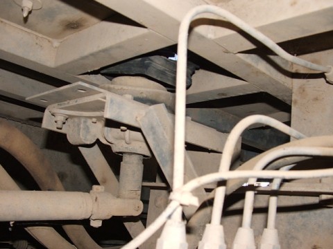

Thank you Dave and Bob, I think its all purely mechanical, got under and saw a ball joint at the front, (gear lever extension under the floor) a long solid 1.5 inch shaft heading towards the back, on going throught the chassis rails two universals, and then another ball joint at the gear box
yep that makes sense, each one of those little joints may have a tiny bit of play and should, in theory have an adjuster
with a little bit of time and a great smattering of patience nearly all play could be taken out
