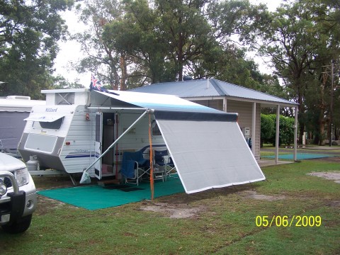

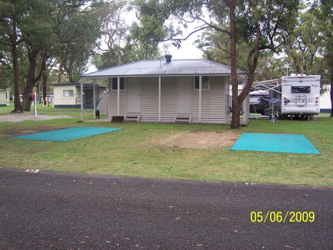

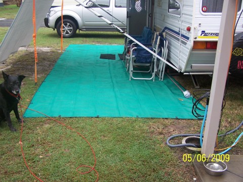

I try to get a site that doesn't have a concrete slab but one that is made of eco matting on a compacted road base slab , they are normally about 25 mm above the surface and you can still drive pegs through them to hold down the annex Not all parks have them but some of the updated ones are going that way , obviously it's cheaper to install.
Took tickets in a RFDS raffle at our local show and won an Eco mat the best prize ever just the bees knees would highly recommend them . If buying one get one that's longer than your van and the extra bit serves as an annex door mat .
The Military use them for chopper pads to keep the dust down and surprisingly they work .
