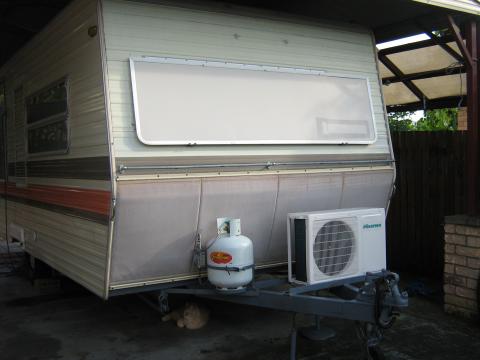

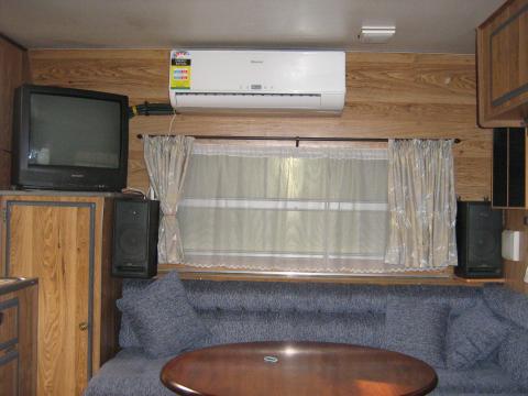

Here is a couple of pictures of the split system ,if you are going to have a go at fitting it your self and want any other pictures or other imfo let me know.I'm no expert on this but I fitted this about 12 months ago. I could not afford a proper caravan air con.
The brand of the system I got was HYSENSE which is only a cheap brand from China,but I'm happy with it so far.

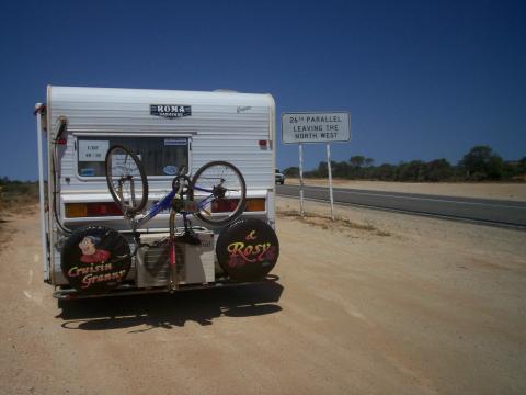

I've travelled from Broome to Cairns via SA, and now sit in comfort in Cairns as the humidity climbs from sweat season to wet season. It's mounted to the rear bumper, and hasn't moved a bit in more than 23,000kms.
