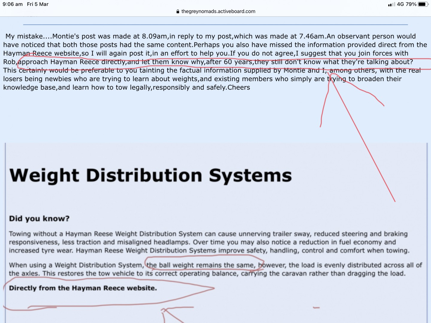

For those with no apparent understanding of how a WDH works,here are copies taken directly from the HR website,which clearly explain that a WDH does NOT change towball weight. Please understand that this information is the 'real deal',for those among us who want to learn,and it is not the dumbed-down version that seems designed to help those who cannot understand that a towball puts weight ONTO the car's rear axle,and a WDH takes that weight OFF the car's rear axle before it DISTRIBUTES that weight to the car,s front axle,and the caravan's axle group.No matter how some choose to duck and weave,and come up with all sorts of theories,these are the simple facts. Again,in an effort to help those in denial,I strongly suggest that you access a video by John Cadogan...just Google "John Cadogan WDH",or similar,and watch his video.If,after viewing that video,you still do not understand the workings of a WDH,there is little hope for you.Sorry
P.S The video is titled "Weight distribution and load levelling hitches for heavy towing..." and is designed to help (Quote) "...an uninformed Dick...", among others,to understand the REAL actions of a WDH.

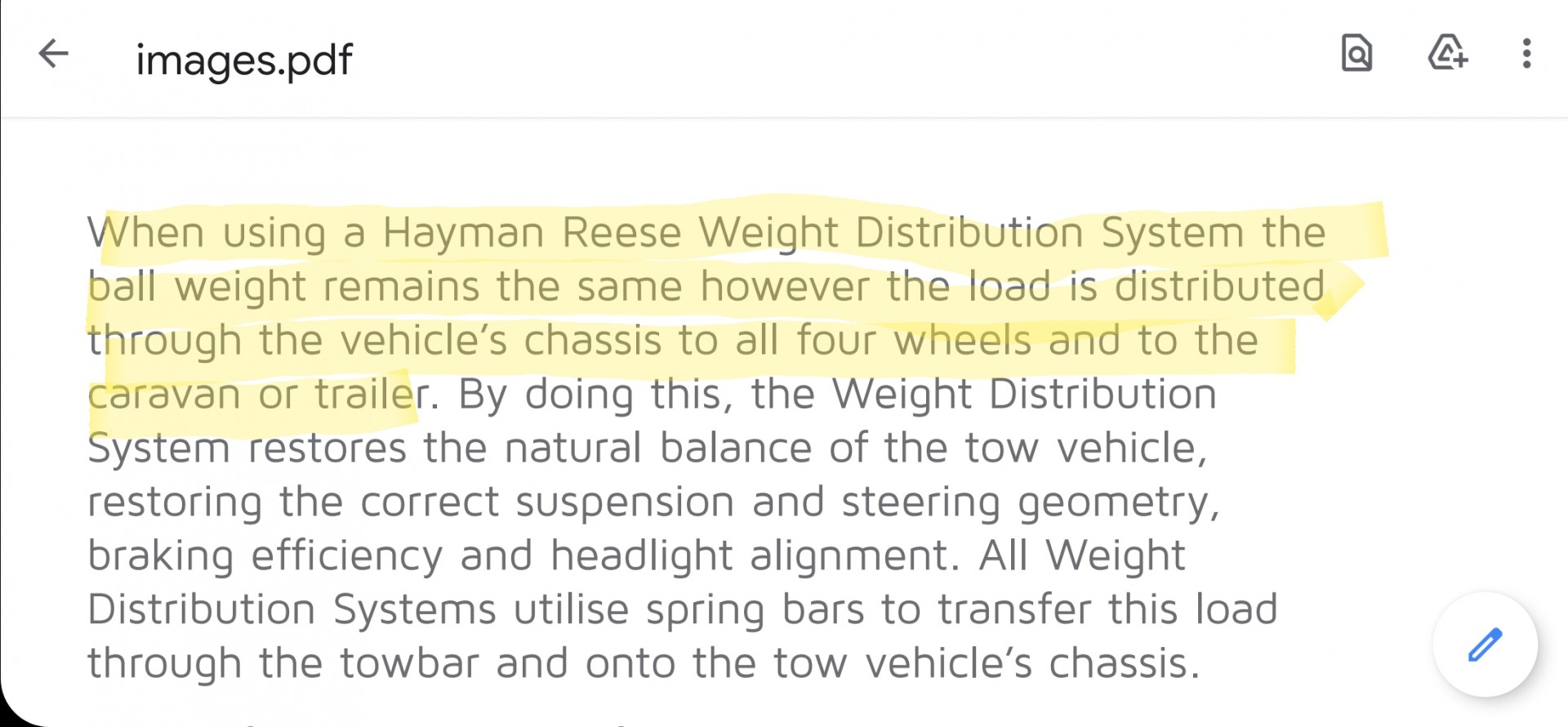

Changed my mind. Who is "we"?
"When using a Weight Distribution System, the ball weight remains the same, however, the load is evenly distributed across all of the axles. This restores the tow vehicle to its correct operating balance, carrying the caravan rather than dragging the load."
There is nothing confusing about that statement from HR and as another poster has pointed out unless you weigh the ball how do you intend to disprove it?
That statement was made by the designer and manufacturer of the product so why do you need further clarification?

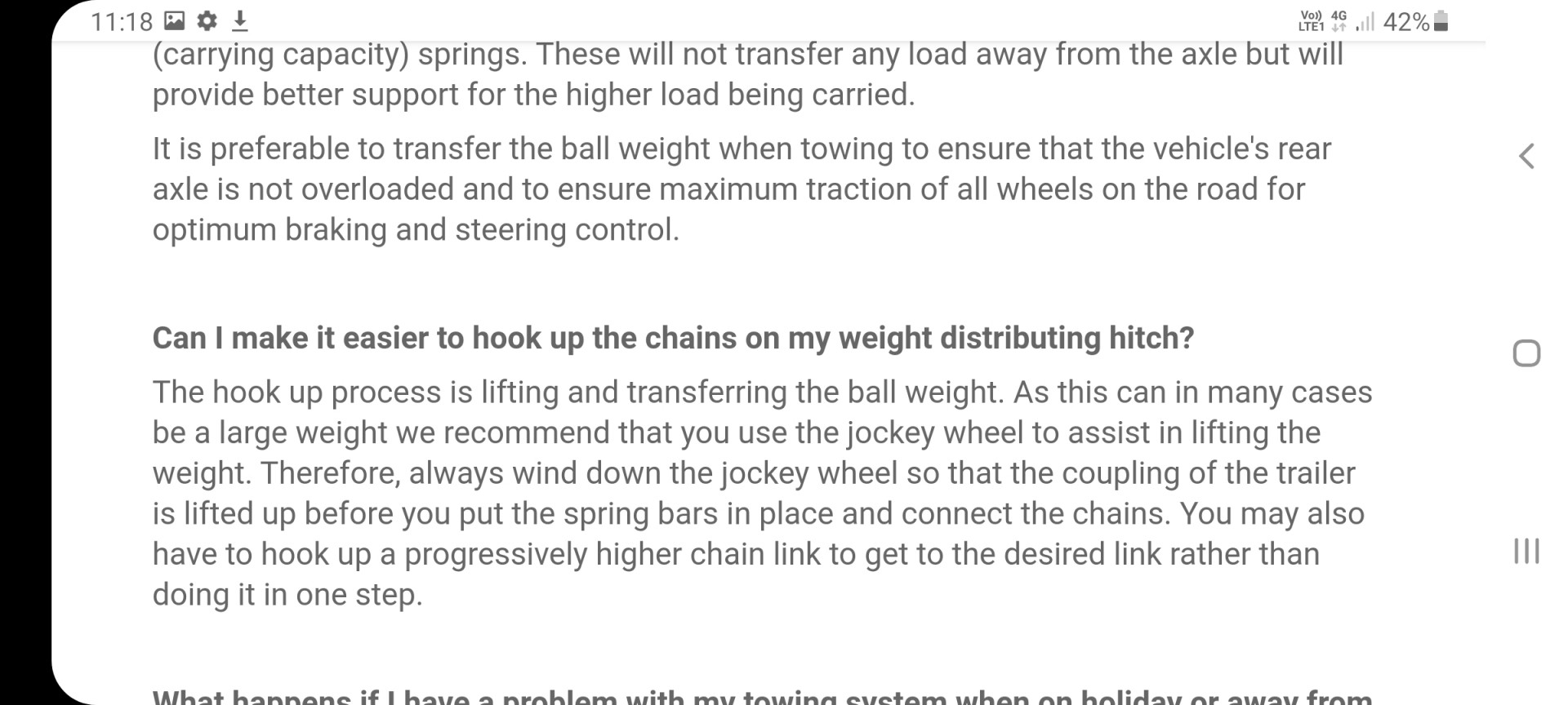

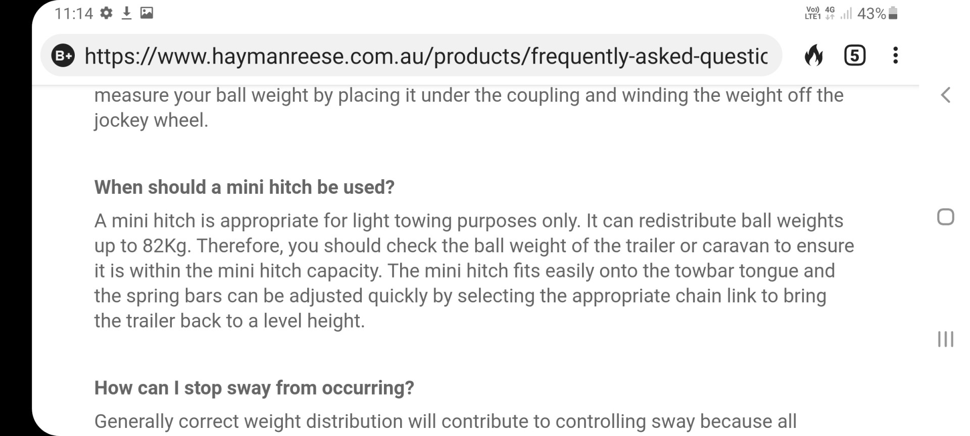

And again on the HR web site. L O L..
Found the above in about 60 seconds. Lol
This is out of their brochure. Might muddy the water a bit. But seems to support the above screen shots.
