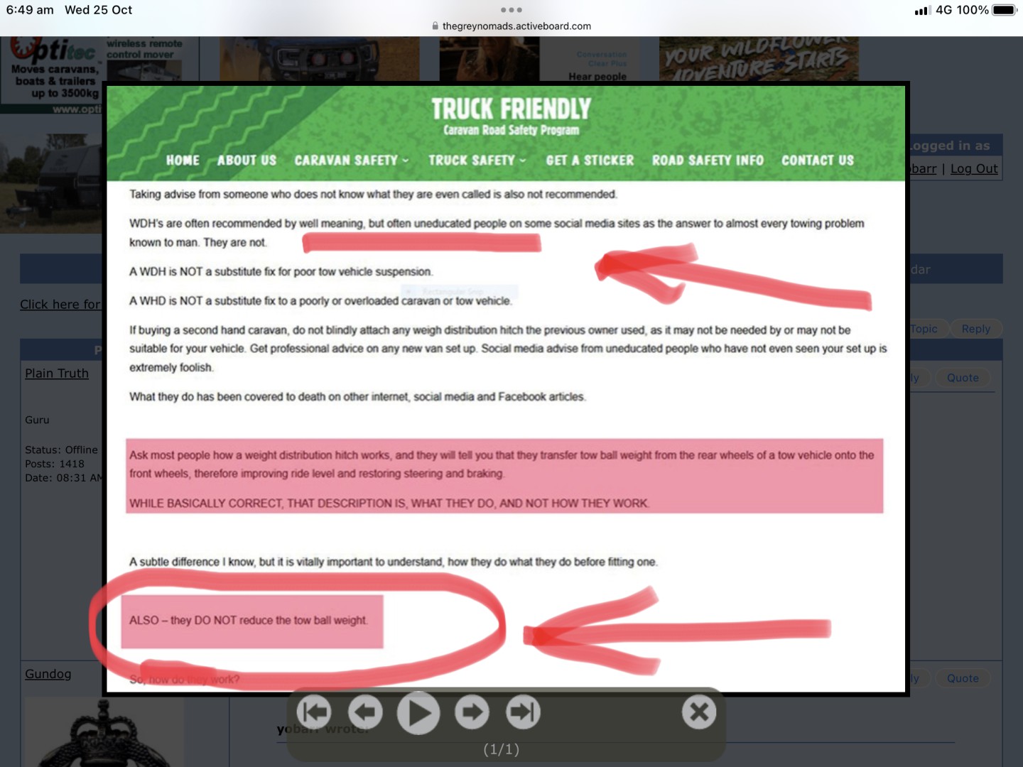

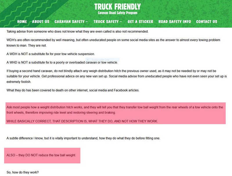

Plain Truth said
09:31 AM Oct 25, 2023
Maybe this article can help https://www.truckfriendly.com.au/weight-distribution-hitches-facts-and-fiction/
Thanks Alan, for posting this simple truth. Later today I will address Graham's confused diatribe.
Even his LARGE RED highlighted sentence is incorrect as a WDH doesn't shift ANY weight that is "centered (centred?) on the point where the trailer and vehicle connect". That weight stays the same.
Your post AGAIN explains this!
Some weight is shifted from the car's REAR AXLE and distributed to the other axle groups.
Never have I "set yourself up as an authority on the subject", simply presenting the facts. Cheers
Great to hear from you again, Alan, as I was concerned that you may have discovered the error of your ways, and gone to ground.
Perhaps you should now take the time to view, in its entirity, the video posted by Tony (Eaglemax) which confirms all the facts that I have been tirelessly presenting for the last 5 years. If you still can't accept the truth then there is little more that I can do to help you.
Please note that I cannot be bothered "Trolling the internet" to prove a point, as I live by the words of Desiderata:- "Speak your truth quietly and clearly, and listen to others, even to the dull and ignorant. They too have their story."
Everybody is entitled to an opinion, no matter how misguided they may be. Tony's video should open your eyes. Cheers

This simplified answer how a weight distibution hitch works.
Rather than the weight being centered on the point where the trailer and vehicle connect, the weight distribution hitch distributes the weight across the axels of the vehicle and trailer.
