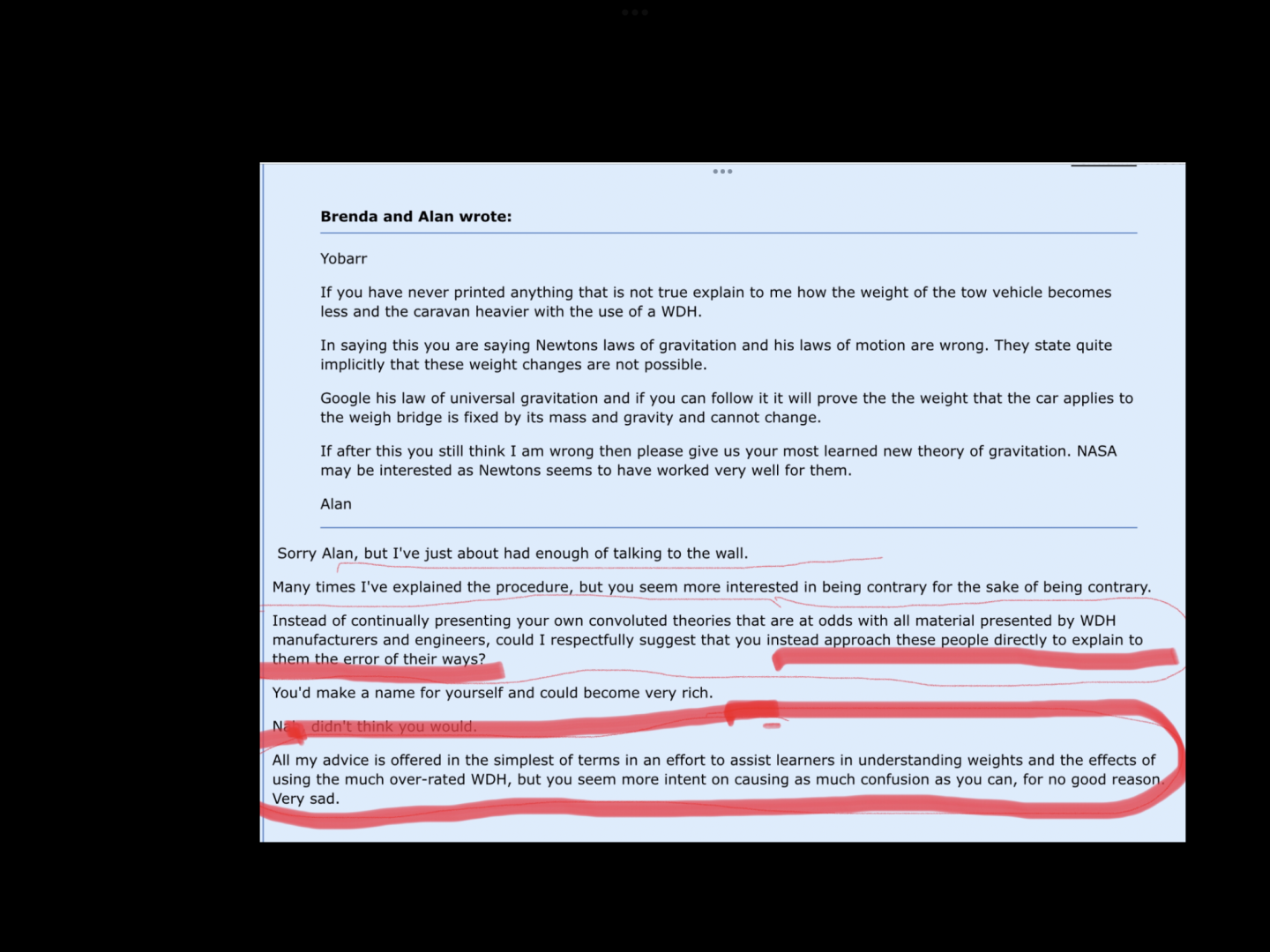

Alan,
Whatever method TMR officers might use is hardly relevant....they determine the ball weight by weighing it. They do not, as you suggested, "assess" it or calculate it.
Dealers use a calibrated scales to measure ball weight on a new van pre delivery as does I believe most manufacturers and in my experience accuracy has never been a problem.
There's nothing complicated about "how a weighbridge works" Alan.....it weighs your van or tug. Let's keep it simple.
Neither is there any mystery about how a WDH works.....I explained that in a previous post...again let's not introduce red herrings.
Brenda and Alan said
09:58 AM Feb 8, 2024
yobarr wrote:
For heaven's sake Alan, when people discuss weights they generally are referring to the weight applied through the wheels of a vehicle to the ground, not "mass" or "force" or any other term that you may choose to use to make yourself appear to be knowledgeable. You're not.
When we are discussing WDHs there is NO disputing or denying that the total weight applied to the ground through the wheels of the car is reduced when a WDH is tensioned, and at the same time the total weight applied to the ground through the wheels of the van is increased. Nobody is interested in "mass" or "force" or whatever. They're just caravanners trying to understand their weights.
This all is simple stuff but in an effort to appear to be knowledgeable you persist with your rubbish-talk that causes only confusion for those among us who simply are trying to learn.
Yobarr
Now I know you are joking. An under standing of what the terms mass and and weight (force by the way) are essential to this discussion. Your not in a position to lecture me on either. The effect of tensioning a WDH is not in dispute. What is in dispute is your belief that the car itself weighs less and the van more than their mass would allow the to under the influence of gravity.
Again I'll tell you that a weigh bridge tells you what force (weight) a given mass exerts downwards under the influence of gravity. And that weight is dependent on two things only gravity and mass so the weight of the car can't change.
The weight the wheels imparts to the ground is made up of that from the car plus any weight imposed by the van.
This is not rocket science, but simple mathematics.
Alan
ps You have never explained HOW a WDH works only stated the results at the various axles.
-- Edited by Brenda and Alan on Thursday 8th of February 2024 10:00:47 AM

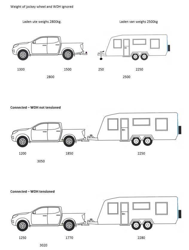

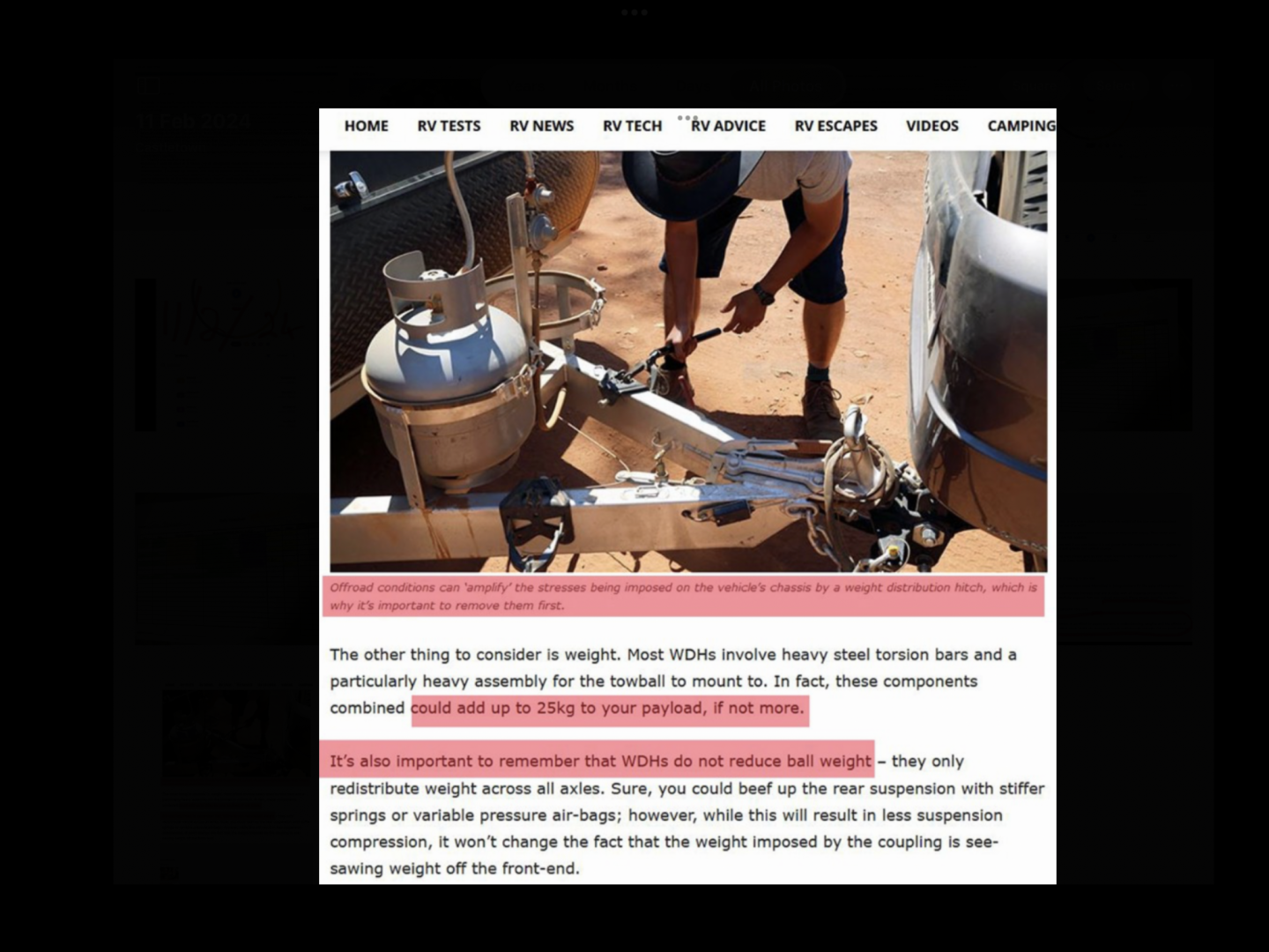

Watsea did a great job with documenting his calculations, but there seems to be little interest from forum members to discuss to that level of detail. Without such discussion, the argument can never be resolved.
It was way back umpteem posts ago that I posted a simple image of what a WDH does. Surely that is all that matters and we can grow up and move on from these endless and pointless arguments.
"When using a Weight Distribution System, the ball weight remains the same, however, the load is evenly distributed across all of the axles. This restores the tow vehicle to its correct operating balance, carrying the caravan rather than dragging the load."
I think the Hayman Reece engineers know what they are talking about, I don't need Newton, Archimedes, Einstein or any other forum expert to tell me otherwise.

Greg 1 said
11:49 PM Feb 8, 2024
The simple drawings of the ute and van followed by monroe's post of the extract from Hayman Reece says it all.
People who professionally weigh things like Van's do not use the cheap pogo stick ball weight gauges, they use a calibrated load cell which are very accurate along with wheel pad scales that are also highly accurate down to points of a kilo.
Far better than a weigh bridge.
08:39 AM Feb 11, 2024
I am not trolling as some think, I am simply trying to show that the thinking around a WDH is in most part wrong. Look at watseas' and rons 'posts on their calculations on how a WDH works. You will see that both indicate an upwards force at the towbar which acts in opposition to the towball download thereby reducing it. This accords with what my stance on this based on very basic physics shows.
I'll say again that Haymen Reece is wrong in their claim. This is simply proved by simple physics again. If other posters can't see this then I suggest some research is needed.
Are we losts' post showing the weights of car and van under the three conditions says it all if you remember the the tug weighs 2800 Kg wt in all three (because its mass is 2800 Kg), I'll leave the subtraction to those interested.
Alan
Alan
I have observed the contest of positions and endless repartition of opinion that is boring.
Alan, you are trying to cement your position with technicalities that is far beyond the interest of the majority.
Yobarr you fuel that fire with your senseless posting irrelevant pictures that provide no actual help on the subject matter, alas you also fail to provide an supporting evidence to the position the towball weight never changes.
Sure we have various companies/people who state that ball weight never changes, these people also ont provide any evidence to support their statement.
The biggest failing on this and other similar threads, is it is never discussed how or why the use of a WDH is a consideration to be used. Statements like using one is making a vehicle do what it wasn't designed to do (or words to that effect).
The other issue that is overlooked what is the process to prepare and setup you caravan and tow vehicle to enable you to visit a weighbridge.
Although your highlighted quote is not quite correct, it is indeed FACT.
Here it is again. Does anyone disagree?
Copied from the Hayman Reece website:
Alan
So the engineers who designed and manufactured the hitch are wrong!
The reality is it is useless information anyway and cant be measured.
Unfortunately, Alan, it is people like you who confuses the genuine buyer or prospective buyer who is looking for practical information before spending his hard earned on a caravan or motorhome. Forums such as this one are meant to be informative and helpful with genuine practical information, which is the reason I have contributed to this and other forums.
Surely there must be an engineering nerds forum out there where people like you can spruik your gobbledegook.
I suggest you take your argument up with Hayman Reece, I'm sure their engineers will have plenty of time to debate Newton's Law with you!
Great post Montie. Severat times I have suggested to Alan that he should approach Hayman Reece to explain to them that, for 50 years, they've been misleading buyers of WDHs. Imagine the money he could make!
But no, he prefers to "confuse the genuine buyer" by continuing to dispute the facts.
Ignorance is Bliss, and Alan is entitled to an opinion, but I do despair that the rubbish that he persists in posting may negatively influence newbies, and general members who simply want to learn about weights, to their detriment.
A WDH DOES NOT change towball weight. Never has. Never will.
-- Edited by yobarr on Sunday 11th of February 2024 02:24:22 PM
a WDH changes TBW, as has been demonstrated.
cheers

Perhaps you too should contact Hayman Reece and point out to their engineers the error of their ways. Better still, perhaps you can measure the ball weight of the hitched van with WDH and post the result.
In the meantime as an RV dealer I will accept their assertions as per their website that a WDH does what they claim it does. It's not as if A WDH was a new concept, it's been around and used successfully for many years.
