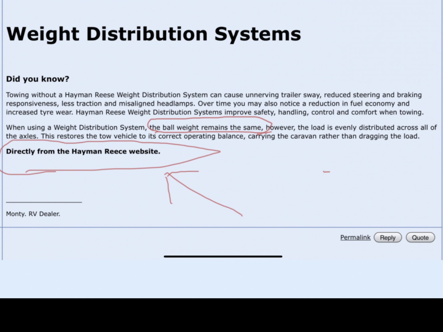

Rob,
Hayman Reece who are the manufacturers of the WDH clearly state that it's use does not change the ball weight.
What more proof do you need?
Now I happen to agree with them. Ball weight is transferred to the tug rear axle when the van is hooked up and the WDH distributes it from there. The weight applied to the tow bar does not change as stated by Hayman Reece.

Alan,
Unfortunately I think you are in denial.
It has been explained to you several times backed up by the statement posted on HR's website.
Time to move on mate.

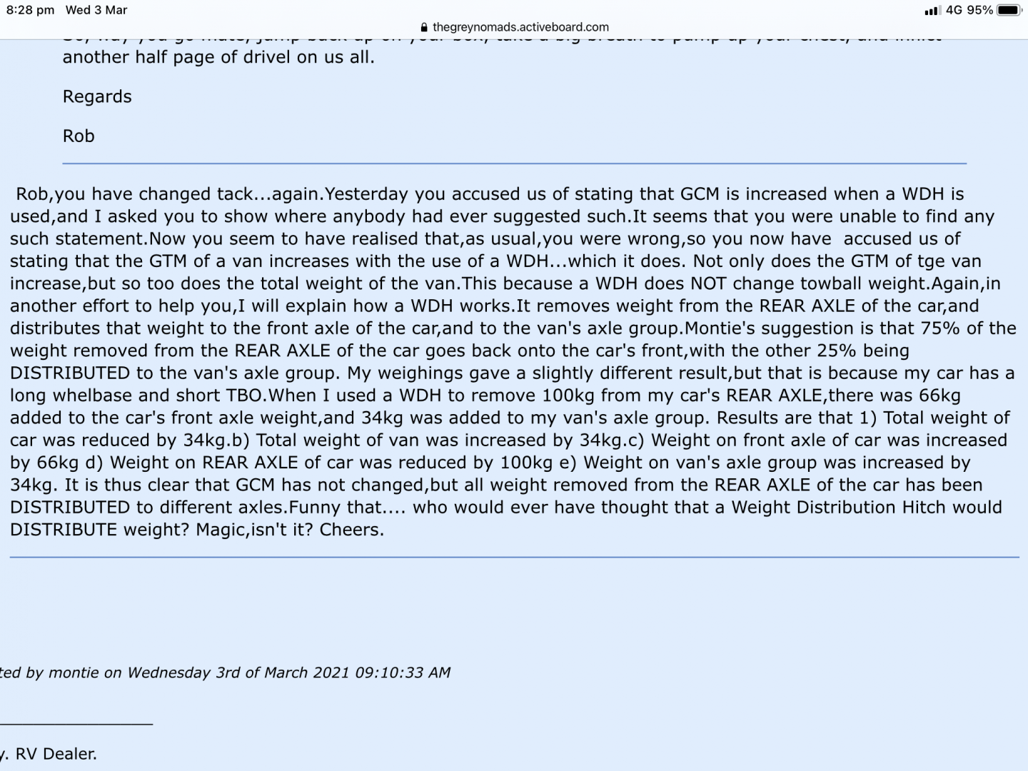

yobarr said
08:31 PM Mar 3, 2021
Brenda and Alan wrote:
Yobarr and Montie, Hayman Reece have EXPLAINED nothing on their website. And both of you keep refusing to understand that the tug becomes lighter as the WDH is tensioned in spite of repeated attempts to show that this is so. The figures don't lie. They clearly show that this is so. This clearly means that the download on the tow bar is reduced in spite of what you want to believe. When either or both of you can provide a legitimate set of weighing figures that shows this isn't the case I will examine them. Consistently both of you make claims and neither of you can back them up with any sort of figures or reasoning. Both of you keep trumpeting the tow ball weight doesn't change but have not given any concrete evidence that this true. Maybe you can't.
Alan,you apparently don't actually READ posts,or you would have seen these results that I posted TODAY at 8.09am.Cheers
Yobarr there is no post from you at 9.09 that I can see on my computer and certainly no posts from you with with factual information that negate the figures that I have presented.
If you can do it just present figures to support your claims instead of just nay saying what i post.

yobarr said
05:04 AM Mar 4, 2021
Alan
My mistake....Montie's post was made at 8.09am,in reply to my post,which was made at 7.46am.An observant person would have noticed that both those posts had the same content.Perhaps you also have missed the information provided direct from the Hayman Reece website,so I will again post it,in an effort to help you.If you do not agree,I suggest that you join forces with Rob,approach Hayman Reece directly,and let them know why,after 60 years,they still don't know what they're talking about? This certainly would be preferable to you tainting the factual information supplied by Montie and I, among others, with the real losers being newbies who are trying to learn about weights,and existing members who simply are trying to broaden their knowledge base,and learn how to tow legally,responsibly and safely.Cheers

Rob,would you be kind enough to substantiate the claim that I have highlighted in your post above,as you made a similar claim at the start of the year.I have included a screen shot of my response to that original claim,but I can find no record of your reply? What you think about me is of little interest to me anyway,but it would be appreciated if you could offer some evidence to support your unsubstantiated claims. As highlighted in the screen shot,I don't really care. Always I offer advice from experience gained over many years with weights,and always that advice is factual,and easily substantiated. It is of little concern to me that you seem to not understand how a WDH works,and that you have no apparent interest in learning,but I am concerned that the rubbish you post will negatively affect 'newbies',or even current members who simply are trying to broaden their knowledge base,and learn how to tow legally,responsibly and safely.These are the very people I try to help,with much of that help being offered,and gratefully accepted,via PM to avoid unhelpful input from a couple of members who know little,understand less and have no apparent interest in learning.Have a nice day.Cheers
-- Edited by yobarr on Thursday 4th of March 2021 09:59:07 AM
I note over the last few pages on this topic you have not answered one of the questions both myself and other members have put forward.
May I suggest that your replies from now on be that of answering those questions, without ridicule, without telling us all how you know more than anyone else, without displaying your total dislike for the 200 series over the 79 series and just provide an answer that is concise and readable for all to interpret and understand.
All these comments from you when you are challenged only goes to ruin the topic as a resource.
As I asked the other member in a post above, just give proof of your claims rather than your meagre attempt to discredit anyone who does not agree.
So in simple terms Yobarr, prove your point, the silent majority are waiting for a sensible input.

yobarr said
10:57 AM Mar 4, 2021
bentaxlebabe wrote:
Yobarr,
I note over the last few pages on this topic you have not answered one of the questions both myself and other members have put forward. May I suggest that your replies from now on be that of answering those questions, without ridicule, without telling us all how you know more than anyone else, without displaying your total dislike for the 200 series over the 79 series and just provide an answer that is concise and readable for all to interpret and understand.
Rob
Sorry to have confused you again,Rob,but the WDH question has been comprehensively answered,many times,here and elsewhere.To assist you further,I suggest that you:-Access the Hayman Reece WDH website.Access videos by John Cadogan. Access ANY simple-physics literature.Access my many detailed explanations of the workings of a WDH. Failing this,just accept that you do not really understand WDHs. And,once you have done these things,you should have no trouble finding time to tell me about the "...other forums..." from which I have been banned. You might like to READ,and sensibly respond to,the post I made today at 4.55am,paying close attention to the request that I made in the first sentence.Cheers
-- Edited by yobarr on Thursday 4th of March 2021 02:48:21 PM

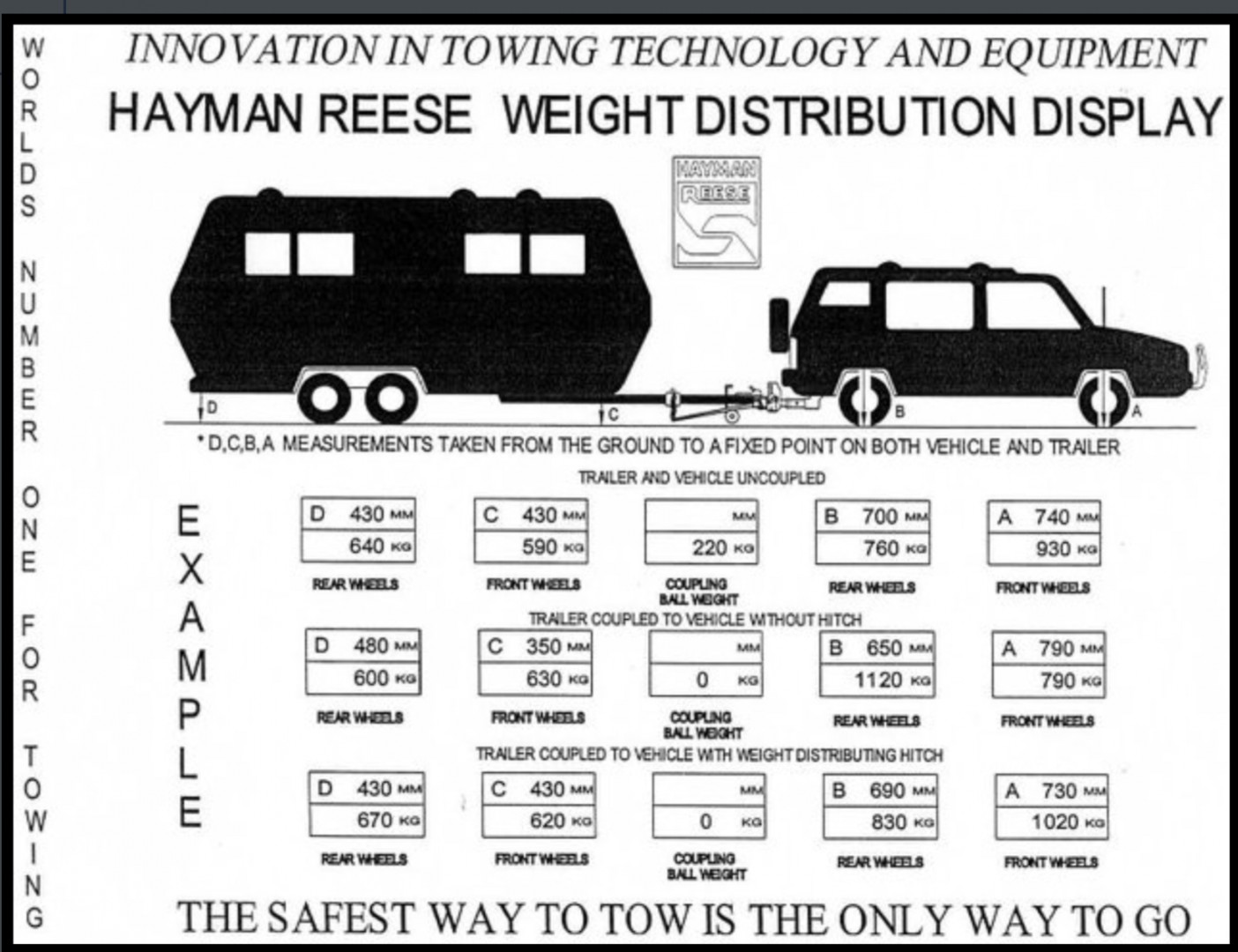

Anyone interested needs to have a look at the example of weights by HAYMAN R.
We need to do a little arithmetic here so grab your calculators.
The picture by HR gives the weights and the heights with the separate car and caravan sitting on a weigh bridge.
The next row show the car and caravan connected and the weights from HR clearly showing the same GCM as was indicated on the top row if you care to do the additions.
The third row shows the weights once again, but this time with the WDH connected.
If once again you do the additions you will again note that the total of the new weights with the WDH connected is the same as the GCM as weighed in the first row.
This chart clearly shows no weight being recognised on the tow ball as the weight in both cases has been transferred to the other points on the car and caravan while on the weighbridge.
Now this is what HR told me when I rang them the other day but as I said....their claim of their Hitch not removing any tow ball weight is so that the consumer fully understands that when he is weighed correctly by a compliance officer a tow ball weight will be recorded because the car and van will be weighed separately and unhitched.
Someone else above correctly said that when a WDH is fitted, the vehicle and van chassis basically become one due to the simple physics of the interaction of the torsion bars between the two.
Here is the document from Hayman Reece.

Rob,
