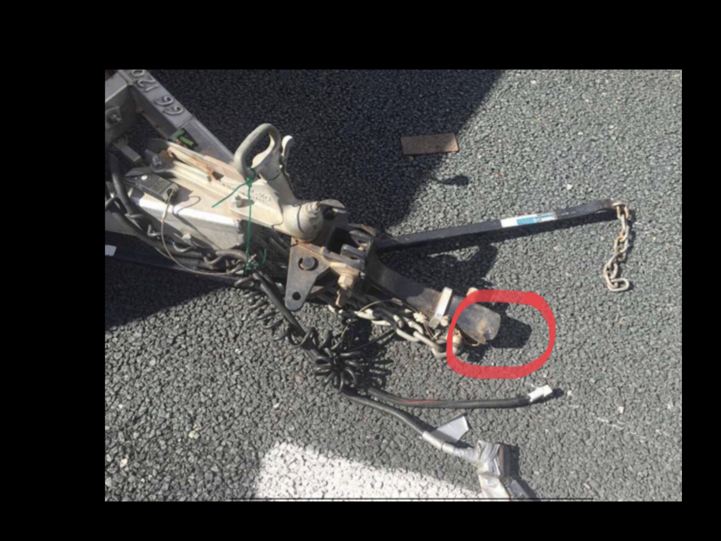

P.S The shank has been snapped-off inside the receiver. Was this contributed to by the use of a WDH, which increases TBO as well as applying extra weight to the car's rear axle?

The picture says to me that the shank of the hitch was too long for the short receiver, and it was the receiver that was sheered off.
The picture says to me that the shank of the hitch was too long for the short receiver, and it was the receiver that has sheared off.

Hi Graham, You are, of course, correct about the receiver being the part that sheared off. My apologies. The picture was one I grabbed without studying it, simply to illustrate the massive stresses placed on many components when a WDH is used, stresses that many have no clue about.

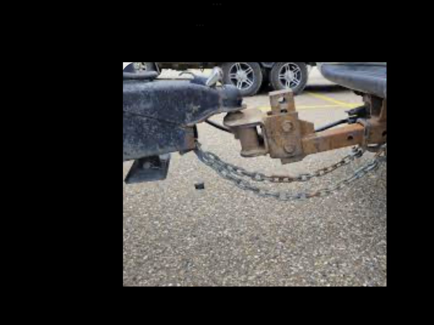

-- Edited by yobarr on Sunday 22nd of October 2023 09:40:37 PM
The old furphy of restoring weight to the cars front axle again surfaces.
As an example let's consider a typical 6000kg GCM twin-cab ute with 350kg on the towball. This results in around 150kg (+/-) being removed from the front axle of the car, and transferred to the car's rear axle.
If a WDH is used to return, say, 70% of that weight to the car's front axle you've moved 105kg. Wow! Big deal. Just carry a fat passenger!
A typical steel bullbar would weigh 80-100kg so the car already is likely to be carrying over 100kg more on its front axle than it was when it left the factory. The 350kg towball weight removes that extra front axle weight, taking the front axle back to factory weight. Unsafe? Nah. Hardly dangerous.
If the car has no bullbar, unlikely in the bush, the removal of 150kg from the front axle is a non-event, akin to not carrying passengers etc. With 350kg towball weight and no WDH my car runs at 1350kg front axle weight. How much is enough?
Another widely misunderstood practice is measuring mudguard height from the road to "adjust" WDH tension, with 2" drop seeming to be regularly quoted. This also is garbage as TBO and spring ratings are two of the main variables, along with wheelbase. A car with heavy-duty springs, long wheelbase and a short TBO is going to drop a lot less than a car with factory springs, short wheelbase, and long TBO, assuming same towball weight. My car drops 15mm, tops.
Then we get the clowns who wind the WDH up so high that there is so little rear-axle weight that oversteer is likely.
In days gone by a WDH was used by Ma and Pa to level the overloaded Kingswood and Viscount, in order to minimise unwanted attention from PC, but nowadays the "Levelling up of the combination" (your words) is of far less importance UNLESS the van has non-loadsharing suspension, where having the van level is critical. The stance of the car is unimportant, within reason.
As you suggest in your second to last paragraph above there is so much confusion and disagreement, even among WDH manufacturers and other "eggspurts" that it reinforces my belief that a WDH is indeed a con-job along the lines of Radial Tuned Suspension from the '70s! Remember the "HooHaa" over that? A blasted swaybar. Spare me.
Again I will say that a WDH is produced in an effort to make a car do things for which it never was designed.
Get a more suitable car, or a smaller van, remembering always that if safety is of any importance always the weight on the wheels of the car should be at least 10% more than the weight on the wheels of the van. Cheers
P.S Some people seem to have NO idea?
