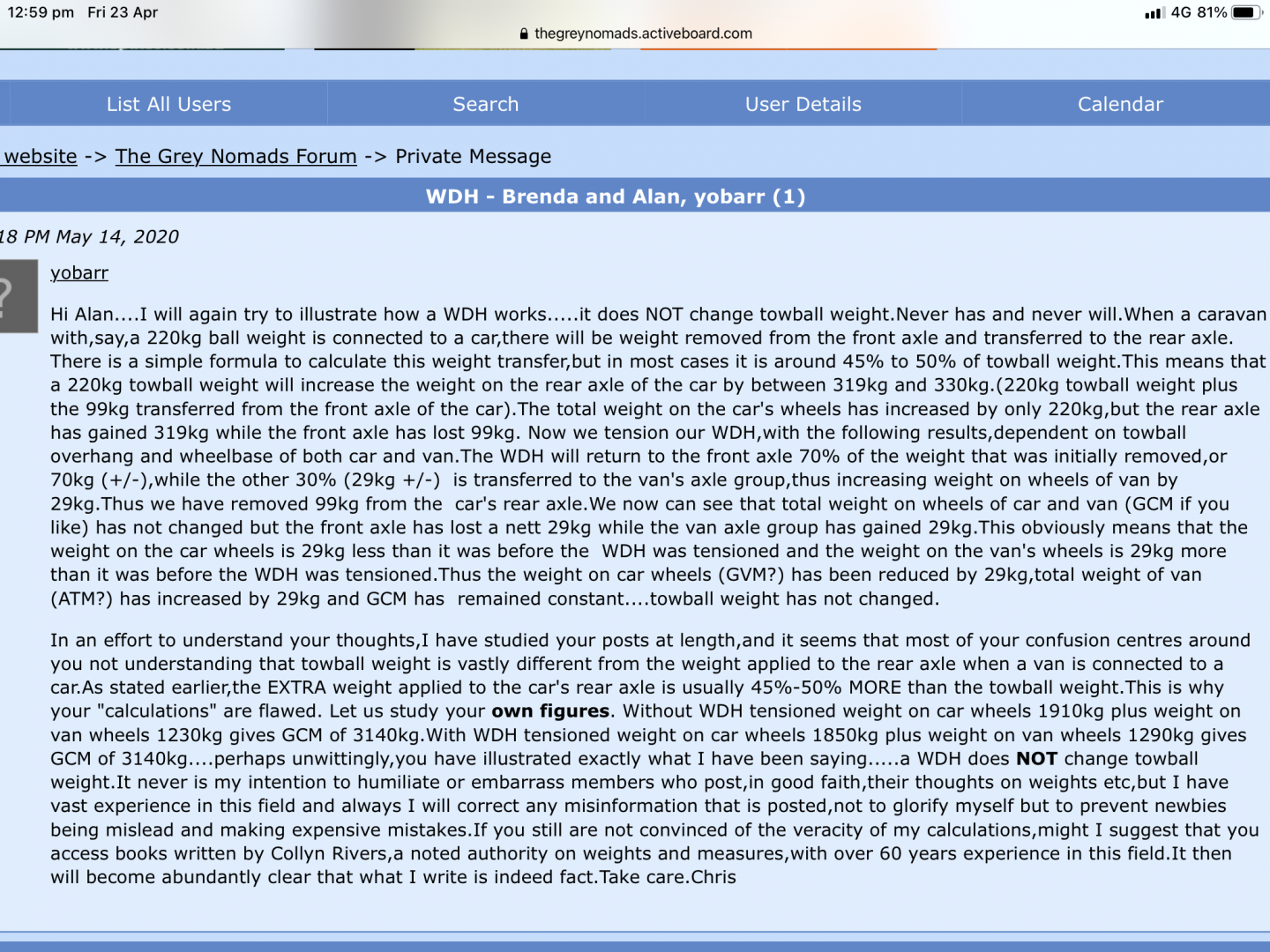

Alan,you are so far lost in the WDH wilderness that I fear for you.Many times,both on the forum and by PM,I have explained to you the workings of a WDH,but still you do not,will not,or cannot understand that a WDH does NOT change towball weight...EVER. To refresh your memory,I have included a screen shot of a PM I sent to you on May 14,2020.Because we have not heard from you of late,I thought that finally you understood the facts. Apparently not? Cheers

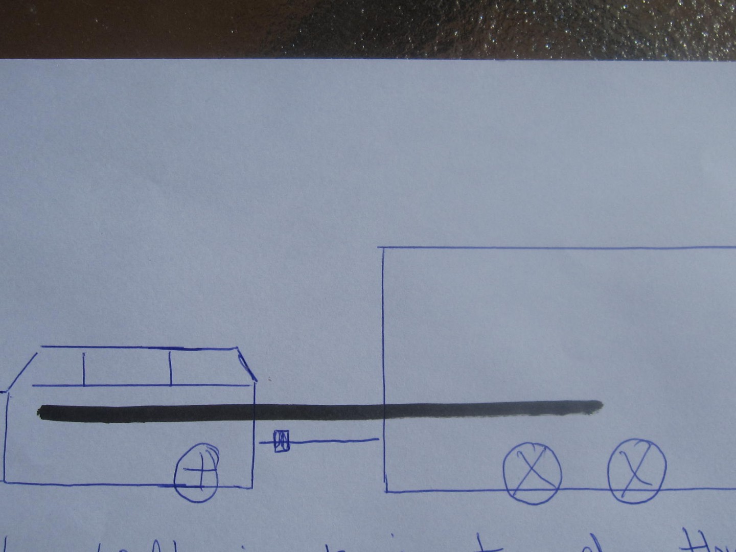

Has the tow ball weight remained the the same on the Olds Toronado and van picture I posted yesterday? If it has then why isn't the rear of the car dragging on the ground?
Rob
-- Edited by bentaxlebabe on Friday 23rd of April 2021 01:53:15 PM
Hey Yobarr,
Rob
