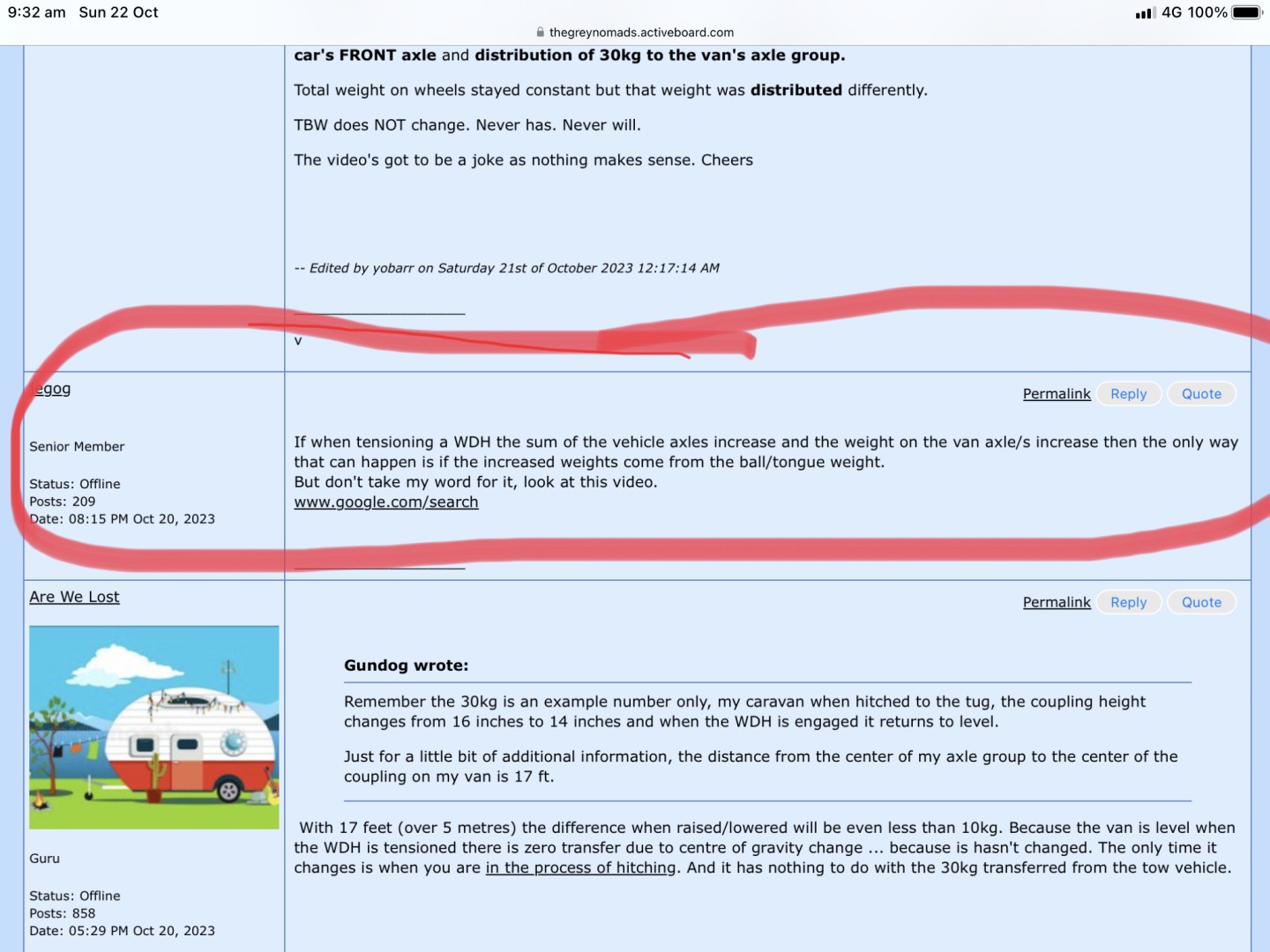

jegog said
09:15 PM Oct 20, 2023
If when tensioning a WDH the sum of the vehicle axles increase and the weight on the van axle/s increase then the only way that can happen is if the increased weights come from the ball/tongue weight.
But don't take my word for it, look at this video. www.google.com/search

jegog wrote:
If when tensioning a WDH the sum of the vehicle axles increase and the weight on the van axle/s increase then the only way that can happen is if the increased weights come from the ball/tongue weight. But don't take my word for it, look at this video. www.google.com/search
Sorry Dennis, but it appears to me that you're utterly confused. All the convoluted theories presented, along with the associated lack of understanding of simple physics by some members, had resulted in me losing interest in what should be a such a simple process, but to the best of my knowledge NOWHERE has it ever been said that "the sum of the vehicle axles increase". (Your words)

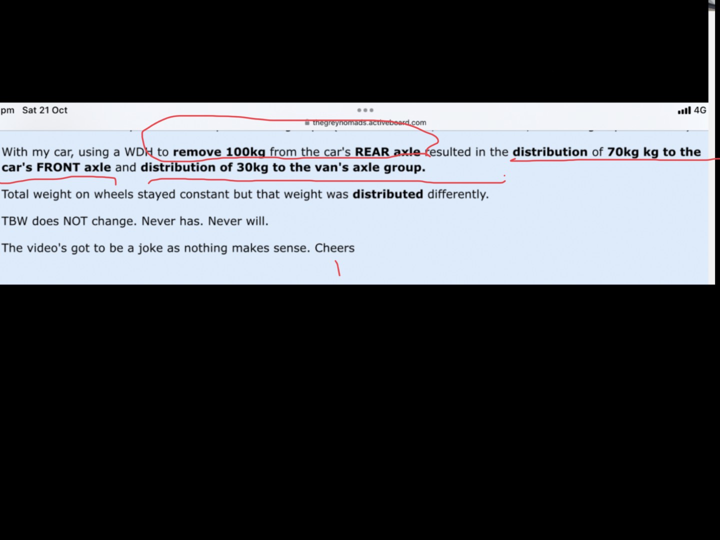

Quite the contrary, with the REDUCTION in weight on vehicle axles equalling the INCREASE in weight on the van axle/s. Surprising! Who woulda thought?
The total weight on wheels (GCM if you like) does NOT change, TBW does NOT change, but the total weight has been distributed differently over the 3 separate axle groups. (Front axle of car, rear axle of car, and axle group of caravan).
With my car, using a WDH to remove 100kg from the car's REAR axle resulted in the distribution of 70kg kg to the car's FRONT axle and distribution of 30kg to the van's axle group.
Total weight on wheels stayed constant but that weight was distributed differently.
TBW does NOT change. Never has. Never will.
The video's got to be a joke as nothing makes sense. Cheers

For the 700th time (approx) I will advise that a WDH increases weight that van's wheels apply to the ground, and reduces weight that car's wheels apply to the ground. Not negotiable. Sorry.
Could I respectfully suggest that instead of waffling on with seemingly endless convoluted theories, ideas and "illustrations" you should conduct your own tests, which will confirm my figures.
TBW and car's wheelbase, along with the van's forward length, will give different figures for the distributed weight, but the results will be very similar unless you use a stupidly-short wheelbase car such as an LC200. Cheers.
P.S My results AGAIN for your perusal. Good luck.

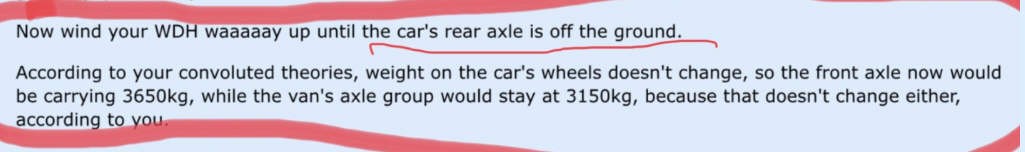

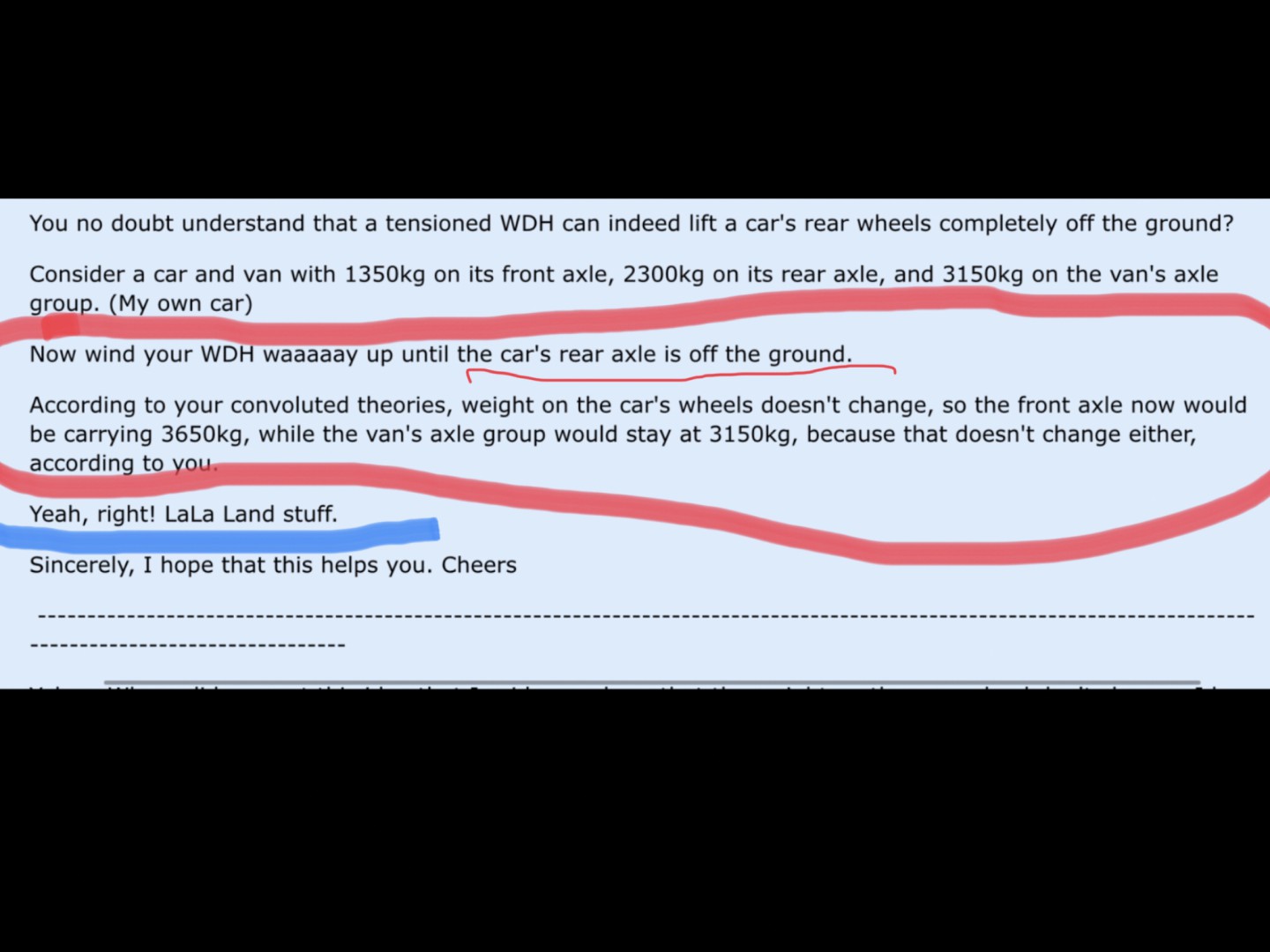

Here is your post 10:58am on 18 October.
yobarr wrote:
Sorry Alan, but this is becoming monotonous. You're now telling HR they're wrong, and that you "laughed" at them.
According to your convoluted theories, weight on the car's wheels doesn't change, so the front axle now would be carrying 3650kg, while the van's axle group would stay at 3150kg, because that doesn't change either, according to you.
Yeah, right! LaLa Land stuff.
Sincerely, I hope that this helps you. Cheers

Really?
I offerred an apology if I was wrong. How about yours.
How about stopping the ridicule and move on. Instead of just spouting the same thing over and over again and presenting your opinion as fact .... EXPLAIN why you think that everyone who has posted logic is wrong.
Not again. Stephen, could I ask that you actually read my post above where I gave figures from my own weighing exercise to show Alan that weight applied to ground by wheels of car changes, as does weight applied to ground by wheels of van.
You seem to have confused that response with the one given to Dennis (Jegog) who attests that the weight on the car's axles increases, and so too does the weight on the van's axles, so the increase in weights comes from the ball/tongue weight. (Screen shot below). Yeah, right. Total confusion. LaLa land stuff.
Never have I attributed that comment to Alan.
Rote learning sometimes is a great educational tool, but only when people actually want to learn.

Again Yobarr your theory that towball weight does not change mean that to be so the car must become lighter and the van heavier.
This is a physical impossibility which you continue to just ignore.
Again explain which physical property the WDH changes, mass of the force of gravity.

Yobarr Dennis posted a very good video by someone with more knowledge of physics than yourself. Again you reject it because it shows yet again that your belief is wrong. Look at the table that has been calculated at the 4 min mark.
Add together the figures in columns Fv and F3 and the result is 8300 lbs(wt), this is the unchangeable weight of the trailer.
This again shows exactly what I have been saying. The total weight of the trailer is fixed by its mass so an increase in axle weight is matched by an equal reduction in tow ball weight.
THIS IS BASIC VERY SIMPLE PHYSICS.

Jegog, thanks for posting that link. It is a little more technical than the typical explanation but not too much. But I will need to watch it again to appreciate it fully. With your comment on axle weights increasing, I believe you are on the path but did not take into account that the net effect of the lighter ball/tongue weight is included in the axles' weight. The overall combined weight on the axles can not change.
Yobar, if you think there is something wrong in the video, what specifically?

How do you explain this situation, presented in an earlier post? Cheers
-- Edited by yobarr on Saturday 21st of October 2023 11:42:03 AM
Easy to explain. Your words that show you have misunderstood Alan's post. He did not say that, indicate it or anything like that. In fact it is baffling how you could interpret that is what he meant.
