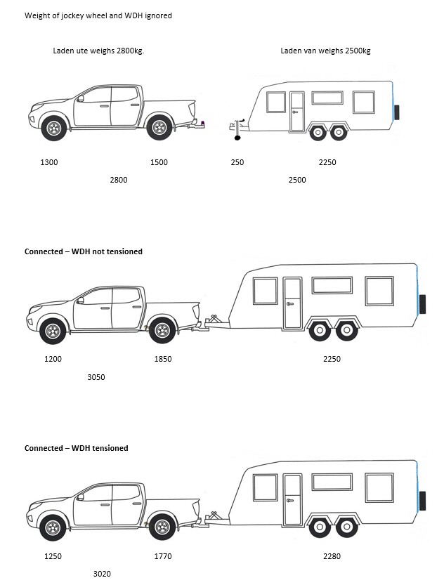

Are We Lost said
04:07 PM Jan 27, 2024
Yes, please let's stop this never ending saga where words and meanings get misinterpreted, and next thing the thread gets closed. Apart from the inner workings of the forces involved, is anyone disagreeing with the resulting weights as per these hypothetical diagrams? Weights are just approximate as a guide.
Without bringing discussions on mass vs weight, newtons or kilograms, forces, moments or whatever, isn't this all that matters? What it reads on the scales?
-- Edited by Are We Lost on Saturday 27th of January 2024 04:20:15 PM
Not correct.
Front of the tug is heavier than shown. 1250 according to the other numbers.
Are We Lost said
04:24 PM Jan 27, 2024
Peter_n_Margaret wrote:
Not correct. Front of the tug is heavier than shown. 1250 according to the other numbers. Cheers, Peter
Correct Peter. I noticed that when I double checked after posting. I briefly edited the post to remove the image and said I was correcting it. I fixed it, removed that image and that note while you were posting your comment. The new image has a different name.
You were too quick.
-- Edited by Are We Lost on Saturday 27th of January 2024 04:27:26 PM
yobarr said
08:06 PM Jan 27, 2024
Excellent post Stephen, particularly the illustrations that clearly show the simple process that I have many times outlined.
Your diagrams should help even the slowest of people to understand how a WDH works.
When I first joined the forum and posted these simple facts I was shot down in flames by some members, but I've stuck to my guns and have again been proved right. Thankyou.
Your comments about weight versus mass, newtons or kilograms, moments or whatever are most pertinent as such terms only are introduced by members who are attempting to appear knowledgeable, when all that we really want to know is how a WDH effects its distribution of weight.
As you succinctly state, all that matters is "What it reads on the scales". Period.
However, my concurrence with your assertions is exactly that, and is not to be confused as being at odds with my opinion that, whether mandated or not, a WDH is used ONLY by those who are trying to make a car do things for which it never was designed.
Some of the smaller cars now rated to tow 3500kg would be an accident looking for a place to happen if a 3500kg PIG trailer was towed. One model has a dangerously low 1650kg rear axle capacity. And 2800kg GVM. (From memory) You'd have to be joking.
Again, thanks for outlining the procedure and the results. Cheers

Somewhere I have all the figures from my own weighing exercise, which I have posted here previously on several occasions, showing that when the WDH was tensioned weight was removed from the car's rear axle and DISTRIBUTED to the car's front axle and to the van's axle group.
The total weight on the car's axles reduced, while the total weight on the van's axle group increased.
Strangely, the increase in front axle weight, plus the increase in van axle weight exactly matched the weight that was removed from the car's rear axle. Who woulda thought!
It also is of interest that you haven't developed some other convoluted theory that addresses weight changes that occur when a WDH is used to lift a car's rear axle COMPLETELY OFF the ground.
NOW try and convince the gullible that the car exerts the same downward force as it did before the WDH was tensioned. Yeah,right.
You were too quick.
