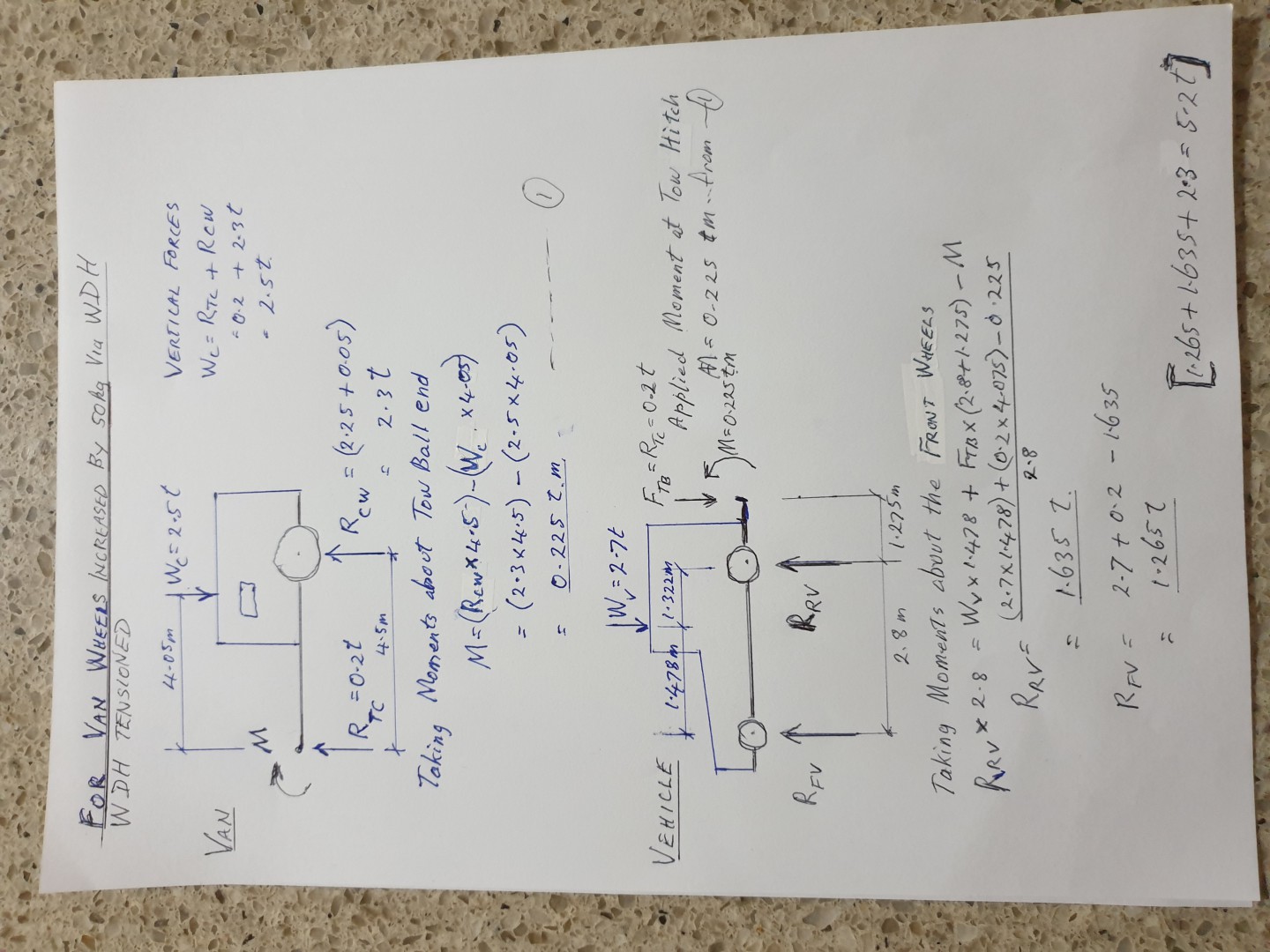

I will be interested to see your workings on how you calculated the difference when tensioning the WDH. I would have thought you would need the measurement of where the WDH downward force is applied on the drawbar to derive the ratio with the van wheel distance.
Also, the usual guideline for a starting point is to return half the lost weight on the tow vehicle front axles. Your calculations show a restoration of almost 100% so your example is not a recommended situation. However I appreciate that your calculation starts with a given at the van wheels.
Are We Lost,
In my workings, I simply applied a torque at the WDH. That could be any type of WDH ie a similar type to a HR WDH or, say, an Andersen type or some other that we don't know about. Applying the torque was in the calculations. Sure how the respective types apply that torque will generate forces in the A frame and hitch. As we should understand, the vehicle-caravan combination must be able to bear the extra forces for the WDH system to work.
I found working from an assumed extra wheel load at the trailer and working forwards, were easier calculations than working from the front, where I might have to solve a simultaneous equation.
Attached workings for when an extra 50kg is distributed to the van's wheels and workings for when an extra 20kg is distributed to the van's wheels. Of course, with the latter case, there is a lesser restoration of weight to the vehicle's front wheels.
Possum3,
I cannot see where I am showing a trailer weight reduction of 200kg. Are getting mixed up with weight of the vehicle at 2,700kg and the van's weight of 2,500kg?

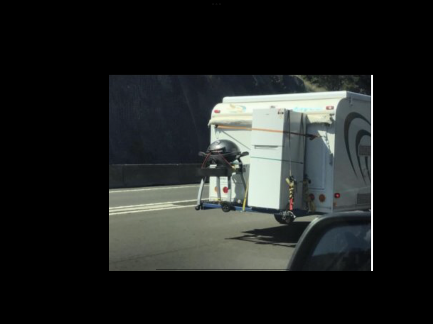

I would like to see what is at the front of that van with the full size fridge on the back! The unbelievable weight on the back must have a serious effect on the towing vehicle. (How do you suppose they even managed to lift it up to tie it on?)
Several months ago I did see a reference that even carrying a couple of bicycles on the back can be illegal. And not as supposed because of weight, but because the length of the van has been extended past the rear bumper. Sorry, I cannot recall the specific details or reference.
If that is true then any van with objects hanging from the back could be pulled over by the police for no other reason.
Yobarr posted that other photo some time ago. As I recall not only were there a large family on board the towing vehicle but there were also heavy objects hanging off the back, so much so that it should have effected the down load on the front which is seriously down in the photo.
The driver was obviously one of those that think if the tow vehicle can move it, then it can tow it on the highway. (Note the absence of of a WDH and towing mirrors!)
Murray
Hi Murray. Its to do with rear overhang, which must be the lesser of 3.7 metres, or the front load space. Cheers

It does remain in place, because the dial guage is used also to dial up the force applied to the weight distribution bars.
Are We Lost,
Possum3,
