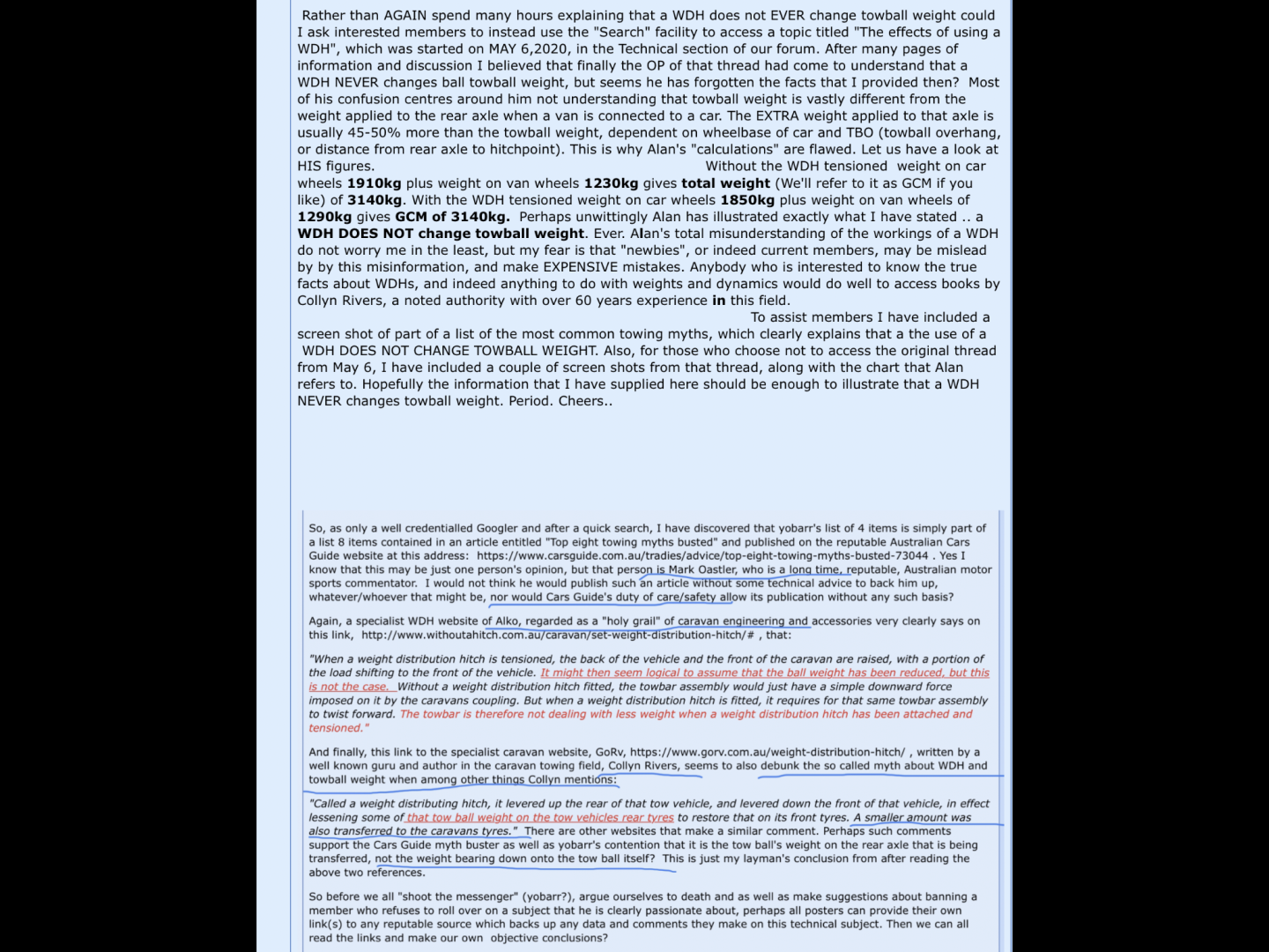

Sorry Stu, but what you write is 100% incorrect. Many many times I have explained WHY what you say is wrong, along with many p references to Collyn River's RV books, John Cadogan's many videos, advice from many people involved in weights and dynamics and my own extensive testing with a WDH on my car. Towball weight NEVER changes when a WDH is used, although the clamping pressure between the towball and the hitch head increases. Because of opposing forces the actual weight bearing down on the towball structure remains constant. The rear axle loses weight, with about 30% of transferred weight going on to the van's wheels and about 70% of transferred weight being returned to the car's front wheels. Towball weight remains tge same. NOT negotiable, sorry, although the percentages of distribution will vary dependent on TBO, wheelbase and forward length of van. What you and Alan say doesn't bother me but I AM concerned that newbies and others who know little about weights, or are seeking reassurance that all is good, will eagerly accept that what you suggest is fact. It isn't. Cheers
P.S Later today I will PM you with my figures in an effort to help you understand, but all you're doing here is causing total confusion for many. Cheers

Alan started this rubbish back on May 6th, 2020, and I then devoted many hours documenting facts, data and references to show him that he was wrong. Because he had not raised the subject since, I assumed he'd eventually seen the light, but now this. Quite frankly, I've about had enough of trying to help someone who knows little, understands less and has no apparent interest in learning, but I will post a screen shot of some of the relevant correspondence for perusal. Everybody is entitled to their own opinion, but I believe that it is abhorrent that their distorted interpretation of the facts is presented to other unsuspecting members of out forum, who are none the wiser and may act on it. IF the supplied chart is studied and analysed it can clearly be shown to be a nonsense with towball weight listed as zero. Yeah, right! As Montie suggested waaay back,Jenny Craig would probably be most interested in learning how to achieve this magical loss! Anybody who is interested in actually LEARNING would do well to search for a thread titled "The effects of using a WDH" which was started on this forum on May 6,2020. Information supplied there should assist even the most challenged among us, but simply looking at the figures supplied directly below here should be enough. Towball weight ZERO. Yeah, right. Cheers
As someone else said, if a vehicle manufacturer recommends its use then the whole argument stops there.

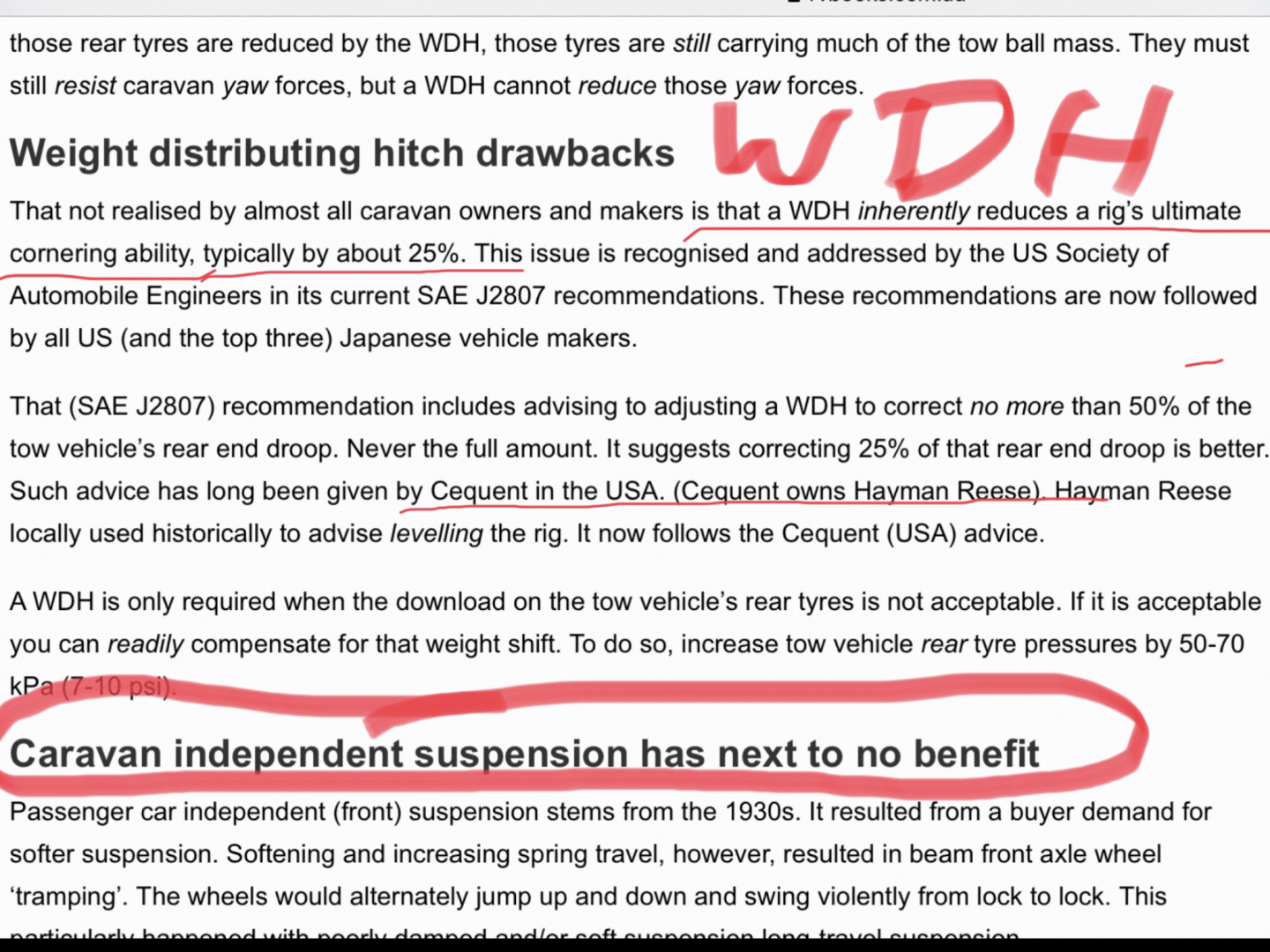

Here we go again we miss representing what is said in SAE J2807, please read the full document and you will see that J2807 is aa procedure to rate trucks in the 1/2, 3/4 and 1 ton market to to establish towing and load capacities.
Within that document SAE uses 1 style of WDH without sway control, using A setting 50% FALR, as a control measure for testing sequence.
Cequent the then owners of Reece and HR, I visited their US web site ascertain what their recommendations were for FALR, on their range of WDH'S only one model in their entire range mentioned 50% FALR, but what was consistent across was the method in the application and setup of the hitch.
I had this same issue with CR on another forum, when challenged about J2807 on WDH application he retreated from his position and went defensive.
It's easy to pick bits and pieces from various opinions to create an illusion of fact or truth.
And I say this without qualification that a WDH is not necessary in all circumstances, but if your vehicle's manufacture demands or reccomends their use, then do so they are the foremost experts not some forum self appointed expert.
I have approximately 100,000km towing while using a weight distribution hitch.
This says it in a nutshell,

P.S The story below may point out to members a few home truths about WDHs, but I am obliged to advise that it is simply a screen shot from one of the many books written by Collyn Rivers. As can be seen, a WDH REDUCES cornering ability (safety?) by about 25% and should never be used to level the vehicles, with no more than 50% restoration being acceptable, but a mere 25% being suggested. Why bother? Ever heard of oversteer?
