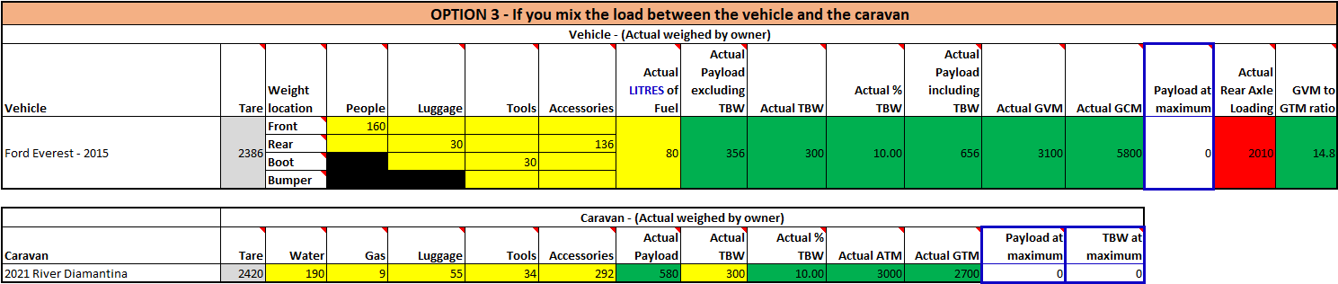

In Kevin's spreadsheet there are 3 options with the critical figures displayed for:
1) A laden vehicle of max. GVM with trailer/van; 2) Laden caravan of max. GTM with vehicle; and 3) Weight distributed between Vehicle and Trailer/Van.
With a max. rated rear axle load of 1750kg that has become all critical in my case.
Options 1) & 2) in the spreadsheet were both unacceptable in my case with the axle weight exceeding 2 tonne in 1) and the GCM exceeded in 2).
Option 3) of distributing weights between car and caravan offered the best outcome however my rear axle is still over limit at 1831kgs. When I went to the first weighbridge I measured the weight transferred by the weight distribution hitch to the front wheels of the Everest (120kg) and the axles of the caravan (50kg). This was for a caravan ATM at the time of 2740kg measured unhitched on the weighbridge.
Kevin's spreadsheet allowed me to put in some actual figures for luggage etc in the caravan, as weighed laden at the weighbridge standalone. Seeing as I knew the ATM weight of the van laden of 2740kg and the weight transferred from the vehicle's rear axle, I was able to toggle the weights in his spreadsheet until this ATM minus the recent items removed [rear trye & bracket (30kg) + plastic wheel ramps (8kg)] approached the van's new current weight of 2702kgs with ball weight of 256kgs. The spreadsheet arrived at the axle limit of 1831kgs using these new weights for ATM and TBW.
Enter the weight distribution hitch. With the van with WDH tensioned (ATM 2740kg), the hitch distributed 170kg from the vehicle's rear axle previously, as described above. Using this as a ballpark figure, and providing the same tension is observed on the spring bars to the hitch, this would reduce the axle load from 1831kg to 1661kg and bring the axle back within its rated limit with 180kg allowance.
With reference to Kevin's spreadsheet the:
- GVM sits at 2960kg of max allowable 3100kg (a little high for my liking) but still with 180kg to spare.
- GCM sits at 5367kg of a rated 5800kg, so no issues there.
- The trailer has another 433kg payload it can carry, however I will not be adding to the 2702kg laden above to ensure my vehicle's rear axle remains within tolerance. Ditto, the car has another 180kg payload it can carry, but I will not be adding anything further.
- GVM to GTM ratio is good at 19.3%.
- TBW to ATM weight ratio expressed as a percentage is 9.47% (just outside the min. acceptable weight ratio in Australia of 10-15%).

KevinJ said
09:03 AM Mar 25, 2022
Hi Tim, The results in the spreadsheet are indicative of what I have seen with other setups. Invariably there is scope to add more payload to both the vehicle and van as in your case but the rear axle weight is the deal breaker, hence a calculator which does not include rear axle calculations could get you in a lot of trouble as you would think you could add more payload without realising what is happening to the rear axle. If I can figure out how to include WDH as a parameter, I will add it though at this stage I am not sure if it is possible as they can be tensioned differently even on the same vehicle.
The attached shows the rear axle weight over by 260 KGs if we were to simply load the vehicle and van to their maximums and ignore axle weight.

The formula for 256kg towball load results in 388kg additional rear axle load. You listed 220kg in payload, mostly passengers in the front seat. So, assuming that equates to 100kg on the rear axle, and using your measured rear axle load we get:
1235 + 100 + 388 = 1723 (or 108kg less than your quoted 1831kg).
If you use kerb weight from Ford specs it is even less. Maybe there is an error somewhere and rear axle load is not so bad after all.
I believe it is still resolvable, but suggest you take some things off your inventory. You said you were going to travel with half water to achieve enough towball weight. If you removed the washing machine you would not need to water to counter balance it .... saving over 100kg.
I am sending a PM with further thoughts I have on your setup.

New calculation of Tare and Kerb Weights for my 2015 Ford Everest - now entered into KevinJ's spreadsheet, also attached.
Vehicle at the time I weighed front and back axle (no passenger) was 2,515kg. It however had a 3/4 tank of fuel. So at 80 litres, that becomes 60 litres x 0.82 (SG) = 49.20 kg
Tare therefore is: 2,515 - 49.20 = 2,465.80kg + 8.2kg (10 litres diesel for tare) - weight of towbar (30kg) = 2,444kg
The Kerb Weight also requires alteration to add back 70 litres of fuel = full tank = 2,444 + 57.4 = 2,501.4kg
I have entered both into the spreadsheet.
With reference to the Spreadsheet attached, the GVM for the vehicle is obviously increased and 105kg under the vehicle's rated max. GVM.
Clearly, the implication is I need to monitor both the ball wt. and the weight I have in the vehicle. Removing the 3rd row of back seats remains a good option.

I will leave it to Kevin to discuss what is in the spreadsheet, but I note it is still showing rear axle load of 1811kg (over the Ford specified maximum). Thiis figure is identical to the verision you posted on 26 March, and I believe it is overstated, based on your figures. I have discussed that with Kevin but will leave it to him.
A couple of observations/questions:
How did you arrive at 2515kg weight when the weighbridge is in 20kg increments?
If the measured weight was 2515kg with 60L of fuel, how could it be less (2501kg) with a full 80L tank?

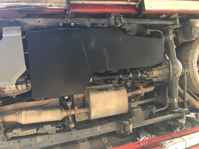

In the spreadsheet you have 2000(mm) as the distance between front axle and fuel tank. This can't be right as that would imply the fuel tank is between the axles. I believe 3350 would be close to the mark. That will adversely affect your rear axle loading.
You referred to 30kg towbar weight. Not sure how the spreadsheet deals with this. Kevin?

Steve, answers to your questions below:
1. 2515kg calculated using Pedders single axle scales, not weighbridge.
2. Good point, however you have overlooked my deduction of 30kg for towbar from front + rear axle addition.
3. Steve, I took mid-point of tank which travels transversely from rear axle forward. Refer picture of fuel tank attached which extends from rear axle forward.
4. Kevin in his most recent post (3/4/22) has stated to ignore this in his spreadsheet calculation.
I realise my rear axle is still over the max. rated load however with reference to Kevin's spreadsheet, you will note I also have minimal load in the car. I am to deal with this by:
A) Use of the E2 WDH;
B) Placing all weight in the rear and back seat of car (which is a minimal payload any case with reference to Kevin's spreadsheet) on to the front part of roof rack over the front axle.
C) Ensuring that TBW does not increase beyond 150kg download by distributing weight over wheels in caravan and at point of lowest height.

I have addressed Steve's concern with position of fuel tank by confirming the fuel tank indeed does lie in front of rear axle extending forward to front axle - refer picture in my latest reply to Steve. So my calculation of mid-tank as at 2000mm still seems correct.
I have amended spreadsheet to include the towbar weight of 30kgs at Tare. That leaves a whopping (not) 75kg of payload before max GVM for vehicle is achieved. Crazy ... How does anyone pack to tow anything?! In any case I am to adopt the measures outlined in my post to Steve to shift weight from rear axle to front axle and now more than likely will remove rear seats before the Titanic disappears in the sunset - lol!

Hi Tim.Whilst I have not yet been able to find a few hours spare to trawl through all the figures that you and others have supplied, I have still been keeping a bit of an eye on developments! However, a quick glance shows that you'll be cutting it fine to get this thing all legal whilst ensuring that the weight on the car's wheels is at least 10% greater than is the weight on the van's wheels. But I will watch with interest your proceedings! Cheers
KevinJ & Others - The weigh station results are in from this morning's attendance and I have been using Kevin's 'Load Calculator' spreadsheet. This is enclosed for my Ford Everest and 21' River Diamantina Caravan.
I was considering a GVM upgrade until I found the cost to increase the GVM from 3100kg to 3230kg for a Ford Everest was $3,981.86 (Pedders). For that meagre gain it is just not worth it. (BTW - The new Ford Everest released later this year has a 3500 GVM. Doubt I can afford it though.)
Well, I will leave off here since I believe I (we) are good to go.
My thanks to the Nomads that have contributed to resolving my weight distribution issues and assisted my uptake of information.
All comments welcome - Tim
-- Edited by KevinJ on Friday 25th of March 2022 10:25:16 AM

Moving on, there seems to be a discrepancy between the Ford specs for kerb weight you quoted (2407kg) vs the kerb weight you measured (2515kg). Also, how did you determine the rear axle weight was 1235kq when the weighbridge increments are 20kg?
Next, I don?t understand how a towball weight of 256kg can result in 1831kg rear axle load. Last night you said:
"The spreadsheet arrived at the axle limit of 1831kgs using these new weights for ATM and TBW."
Kevin (KevinJ), thanks to you and Steve (AWL) for picking-up on this matter.
As we are all aware, it is a matter of attempting to make the calculator reflect accurately the real life situation in relation to weight distribution.
Cheers Tim
Cheers, Tim
CONCLUSIONS:
