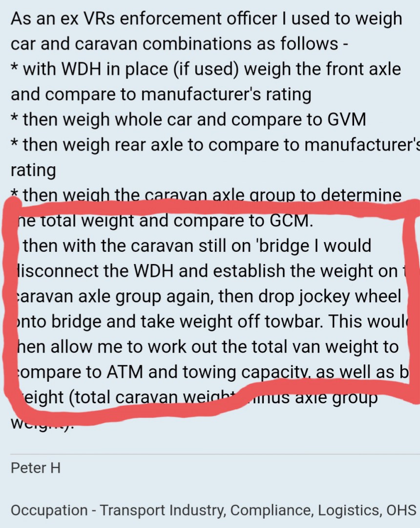

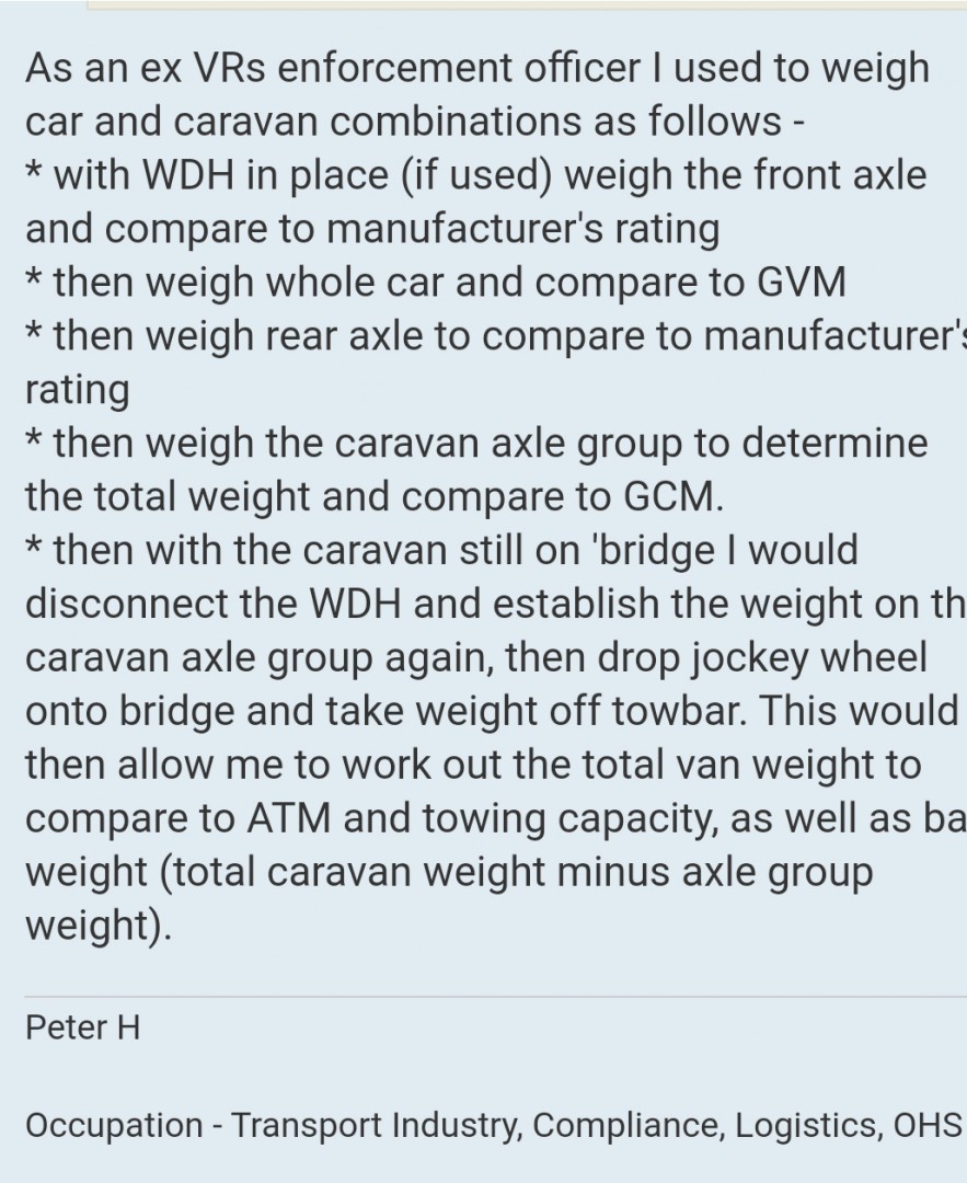

Hi Neil...without being difficult,can I again refer you to the text below from "...an Ex VRs enforcement officer" who states that whenever he weighed car and caravan combinations,that weighing exercise was done WITHOUT any WDH being untensioned.(Released) You can be sure that if ever I as silly enough to use a WDH,and one of those clowns weighed my vehicle with the previously tensioned WDH having being released,and an offence notice was then issued for being overweight,I would rip them to pieces in a court of law.Surely the person who posted this information is not the only enforcement officer at Vic Roads who has a brain? Cheers

oldbloke said
09:16 PM Feb 27, 2021
With all due respect.
-- Edited by oldbloke on Saturday 27th of February 2021 09:17:52 PM
-- Edited by oldbloke on Saturday 27th of February 2021 09:19:12 PM
In fact Peter, as you suggest, that shows that GTM, and ATM, compliance are both compared when the WDH is untensioned, or removed. He also says he checks tow capacity compliance and ball weight at the same time!
Certainly, that is the only way ATM can be checked, as by definition it is the maximum rating when the van is disconnected from the vehicle.
-- Edited by TheHeaths on Saturday 27th of February 2021 09:36:04 PM

yobarr said
06:34 AM Feb 28, 2021
Hi Neil....if you simply are wanting to determine the weight of your van,and that it doesn't exceed your ATM rating,that must be done with the van disconnected,so obviously without any WDH. However,when the van is connected to your car,and you are using a WDH,ALL weight measurements must be done with the WDH tensioned,as if you were set to travel. To do otherwise would give false readings,and false hope to those who suspect that they're overloaded.If your disconnected van exceeds its ATM by "...perhaps 20kg at times...",you can rest assured that once that van is connected to your car,and the WDH tensioned,you will be waaay over your rated ATM.This is because weight has been added to your van's axle group,but towball weight has not changed,so the total weight of the van has increased.The first half of the script you have supplied,from the ex VRs enforcement officer, clearly explains that all weighings of front axle,rear axle and van axles are done with the WDH tensioned.It is only when they are trying to determine the actual van weight that the WDH is untensioned.Cheers
oldbloke said
08:51 AM Feb 28, 2021
Thankyou Ian and Yobarr.
It was always very clear to me in Peters post that the van was weighed with the hitch not tensioned. The tow vehicle was a different matter.

Sooo,,, I weighed the van yesterday. As per above. (WDH NOT connected). I have found that even with water I will just scrape in if water tanks are full.
TBW, CVM, ATM , GTM , TBW all ok and easily limits. ATM may go over perhaps 20kg at times. But not concerned about that.
My conclusion is that last time I weighed everything I stuffed up. Perhaps the water tanks were half full. ? Who knows.
My question is....Yobar, why do you insist the WDH must be connected, YET two x Vic Roads people say the opposite. Remember this is about compliance?.
Hi Neil...I would strongly contest Vic Roads claiming that the WDH must be disconnected.Commonsense,simple physics,and logic would suggest that the vehicle's weights applied to the ground should be measured as the vehicle is structured for travel.If you choose to use a WDH,weighing a vehicle without it being tensioned would give false readings. Who cares what the car and van weigh with the WDH not tensioned? All those weights go out the window once the car and van are set to travel.Please refer to the second paragraph in the script by the VR enforcement officer..."With WDH in place".This surely is the ONLY way to determine actual weights applied to the road by any vehicle that has one attached. Cheers
-- Edited by yobarr on Sunday 28th of February 2021 06:04:29 AM
Hi Neil...if ATM is over "...maybe 20kgs at times" without WDH attached,you can be sure that the ATM will be further increased with the use of a WDH,which puts more weight onto your van's axle group while not changing towball weight. Cheers
Well, Yobar, that may be true, or not. BUT you can contest all you like......what do the regulations say.?
Yobar, when he refers to the WDH in place he is weighing the front axle of the tow vehicle, not the van.
This is not about opinion, this is about the regulations,,,compliance. Whether the regulations are good, is a different matter.
It would sound great if I said in front of a judge, and stated my mate says it should be weighed this way but the judge simply reply with,, the regulations say the "mass of the van." If the WDH is attached the weight would NOT be equal to the mass of the van,, would it?
Yobar, if without the WzDzH attached my van weighs 2000kg then I add 60kg to the mass of the van using the WDH, is it the same? Is 2060 the same as 2000?
Yes, adding the WDH add 60 kg,,,more or less as expected. Ill repeat Vic Roads weigh without the WDH attached.
-- Edited by yobarr on Saturday 27th of February 2021 08:46:22 PM
