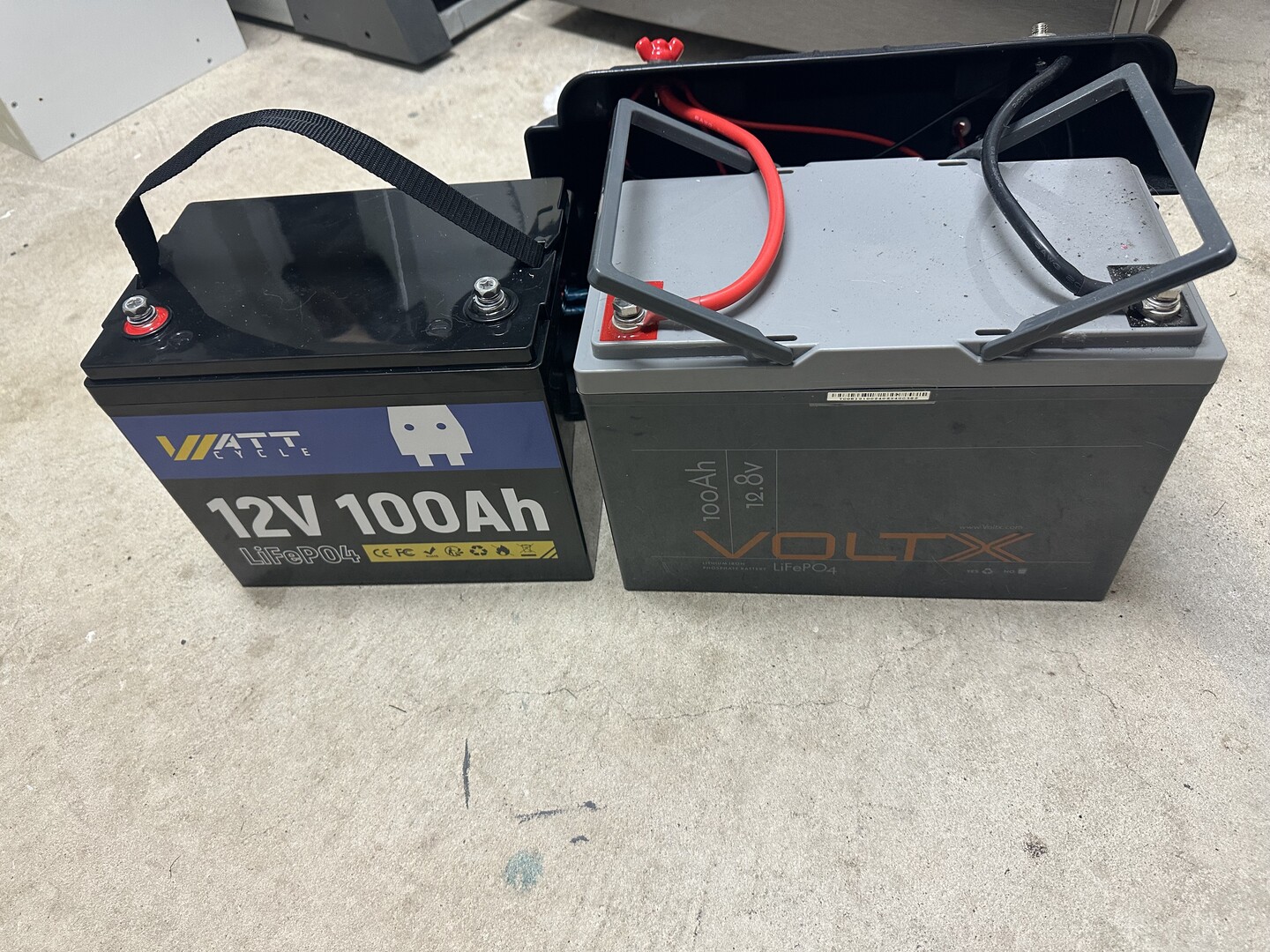

Well my 100Ah Wattcycle battery took a week to arrive. The case is just the normal type case as you see on many of the cheaper batteries with a webbing strap. It is just slightly shorter than the VoltX case and about 10mm higher so always check the dimensions of any battery you buy. The VoltX case s a somewhat nicer case but in reality the case means nothing as there are four prismatic cells in both batteries which will be very similar.

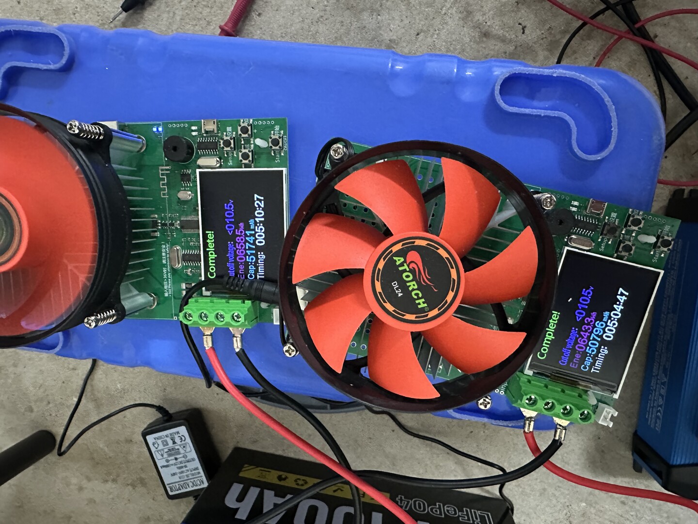

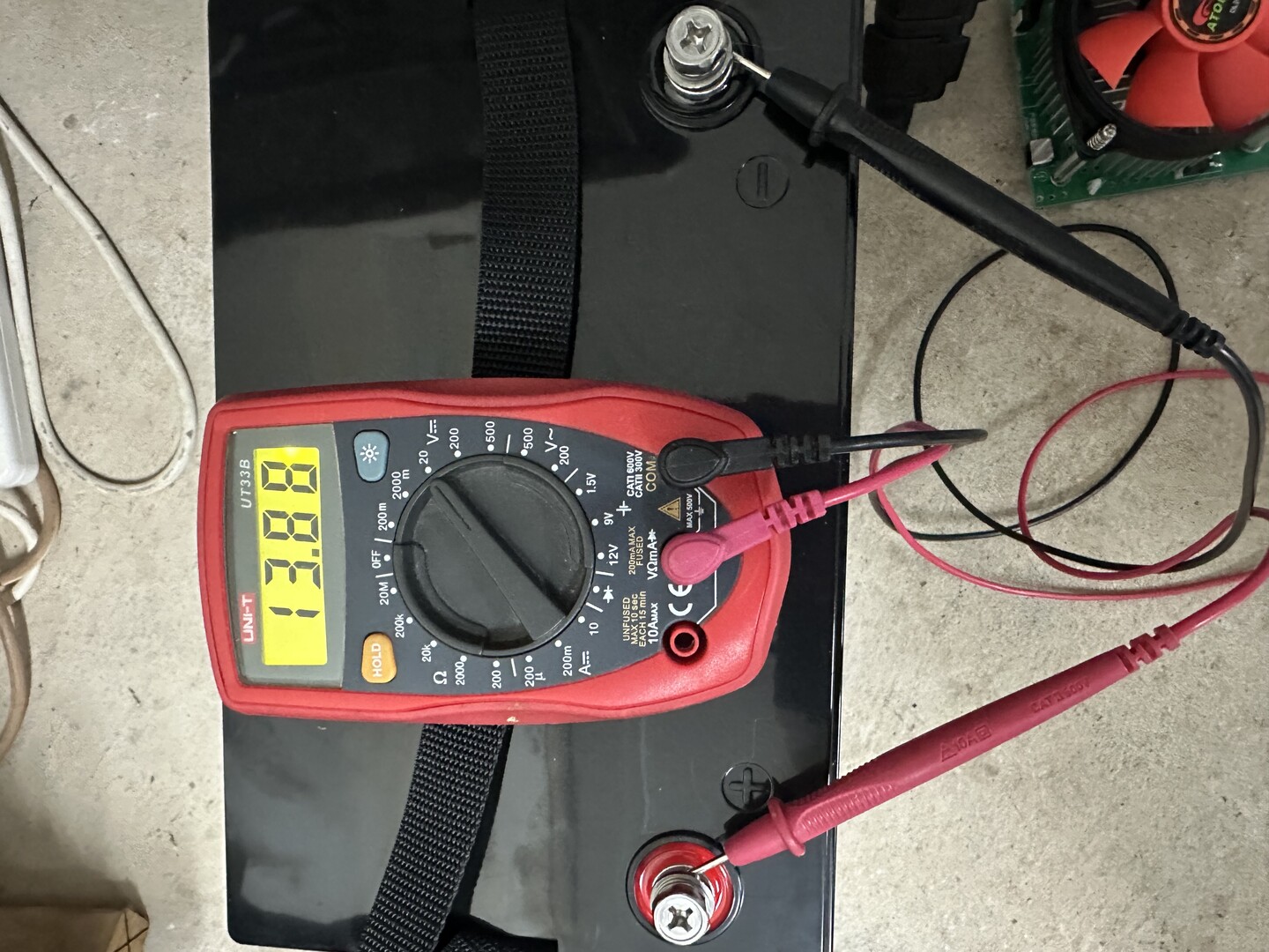

The battery arrived at 13.2V, was charged to 14.6V and then settled at 13.88V the following day.
I undertook two discharge and recharge tests and they all came in at around 102.5Ah. For the price of $275.99 it would probably suit many who are looking for an inexpensive LiFePO4. I had no problem charging to to 14.6V for a full charge and discharged it down to 10.5. 10.00V is considered fully discharged and I could have discharged it down to that voltage but it would have produced only a very small additional power.
