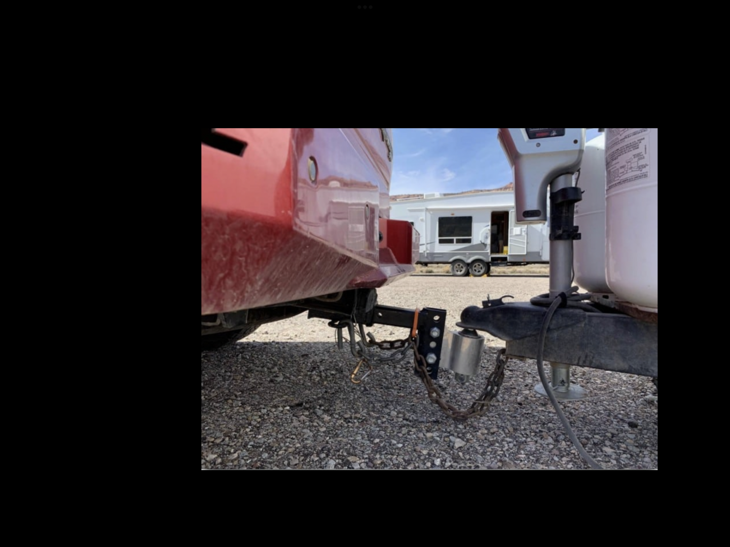

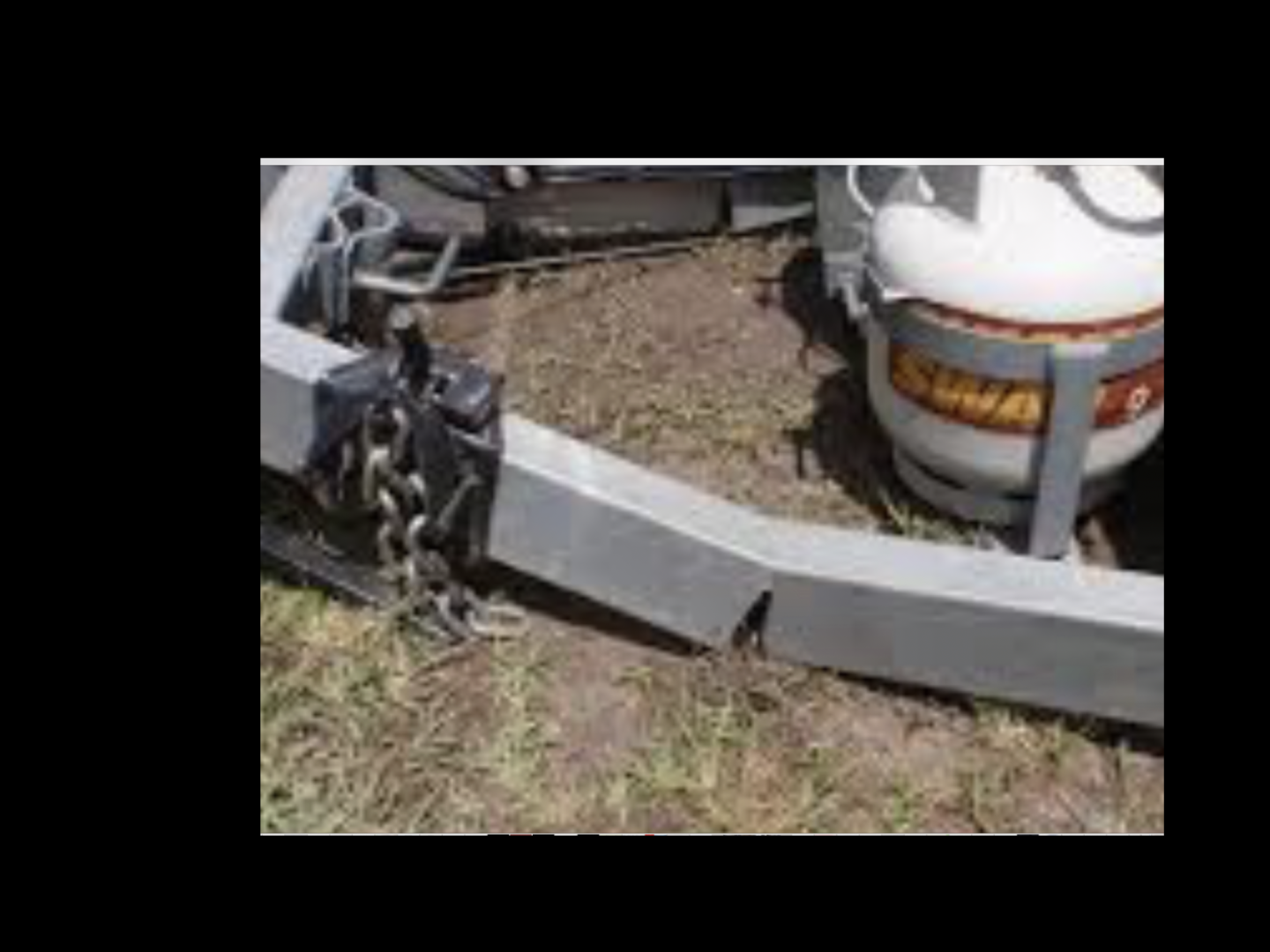

A WDH does NOT change towball weight.Never has. Never will. Cheers
P.S Seems some people have no idea about tow hitches. Note the 'quick release safety chains' with the patented 'equalizer'.

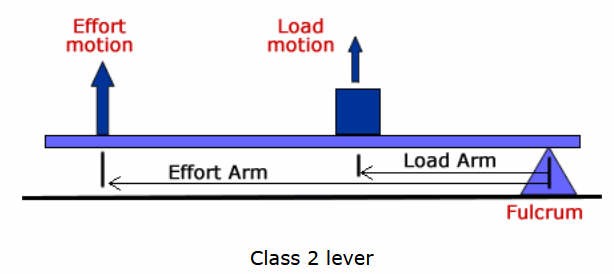

The lifting of the bars is a second class lever (like a wheelbarrow with the front wheel being the fulcrum).
So, relating that the terns used in the diagram ...
"Effort motion" of a 100kg lift at the handles (equivalent to the chains on the end of the bars) may enable you to lift 200kg "Load motion" in the wheelbarrow (the back wheels of the car). That 100kg is added to the wheelbarrow wheel "Fulcrum" (equivalent to the front wheels of the car).
The weight lifted off the back of the wheelbarrow body (equivalent to the towball) will be more than the 100kg you are lifting .... maybe 150kg. So the back end of the car rises. You can measure the changing weight on the wheels, but there is no way to measure the change at the towball ..... only calculate it.
The chains are then attached to the drawbar of the van, part way along. The van is essentially a rigid beam supported at one end by the wheels and at the other by the towball. So when that 150kg from the chains is attached part way along, some is distributed as extra weight on the wheels (say 30kg), but most onto the towball (say 120kg). So the rear of the car sags, but not as low as it was without the WDH. On the van, there are now two components of the weight on the van wheels. The weight from the van itself, plus 30kg transferred from the tow vehicle.
At the towball, the net difference between uplift of 150kg and download of 120kg is 30kg uplift. So the component of the van's weight on the towball does not change, but the net weight on the towball does.
If you have one of these systems you can prove this is the way it works at home. Lift a bar and measure how much it raises the rear. Attach that bar to the chain on the drawbar and measure again. The car rear end will sag but not back to where it was.

Great observation there, Barney.
Although I don't doubt the sincerity of some contributors on this topic, these "Academics" are not necessarily "clear thinkers" in a practical sense.
Their understandings are often "clouded" by complex theories which are often irrelevant to the simple case in question.
No matter how clearly, concisely and frequently I explain the effects of using a WDH, as confirmed by the designers and manufacturers of these devices, always we seem to get contributions from no doubt well-meaning members, with their own convoluted theories.
Their thoughts don't bother me, as we all are entitled to an opinion, but I do despair for newbies, and indeed current members, who simply are trying to learn about the much over rated, and frequently misunderstood, WDH.
Because it may better suit their own agendas such learners may tend to take such "advice" as gospel, to their detriment.
-- Edited by yobarr on Monday 16th of October 2023 09:01:37 PM

In fact the component of the van's weight on the towball does not change but the weight transferred from the car onto the towball does change. Eaglemax points to the three components that make up the weight on the towball. That is the right way to look at it but with a little modification. The downforce on the van wheels is a separate function from the downforce on the car wheels.

Not quite. First, that 50mm difference in coupling height results in less than 10kg change in weight at the coupling according to my calculations. But that is not the point.
When you check the weight while on the jockey wheel the van should be level. When you then go to connect, you need to raise the coupling but only temporarily. At that moment, the towball weight will be a little lower. When you lower the coupling onto the towball (and optionally tension the WDH) the van should be level again. As there is no change in coupling height, there is no change in centre of gravity. So the additional 30kg on the van wheels is unrelated to coupling height.
Remember the 30kg is an example number only, my caravan when hitched to the tug, the coupling height changes from 16 inches to 14 inches and when the WDH is engaged it returns to level.
Just for a little bit of additional information, the distance from the center of my axle group to the center of the coupling on my van is 17 ft.
