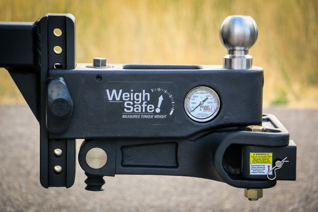

If you are a WDH user and want to see something new, the Weigh Safe WDH might be for you.
It will give you your ball weight and then after a number of measurements entered into an App it will tell you how much load the weight gauge up to distribute the weight correctly.
If you want to know more ther is a Vid is available on youtube,

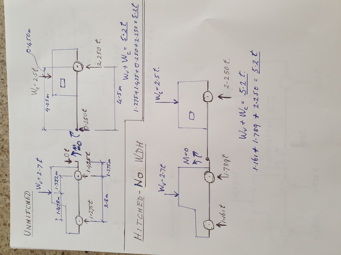

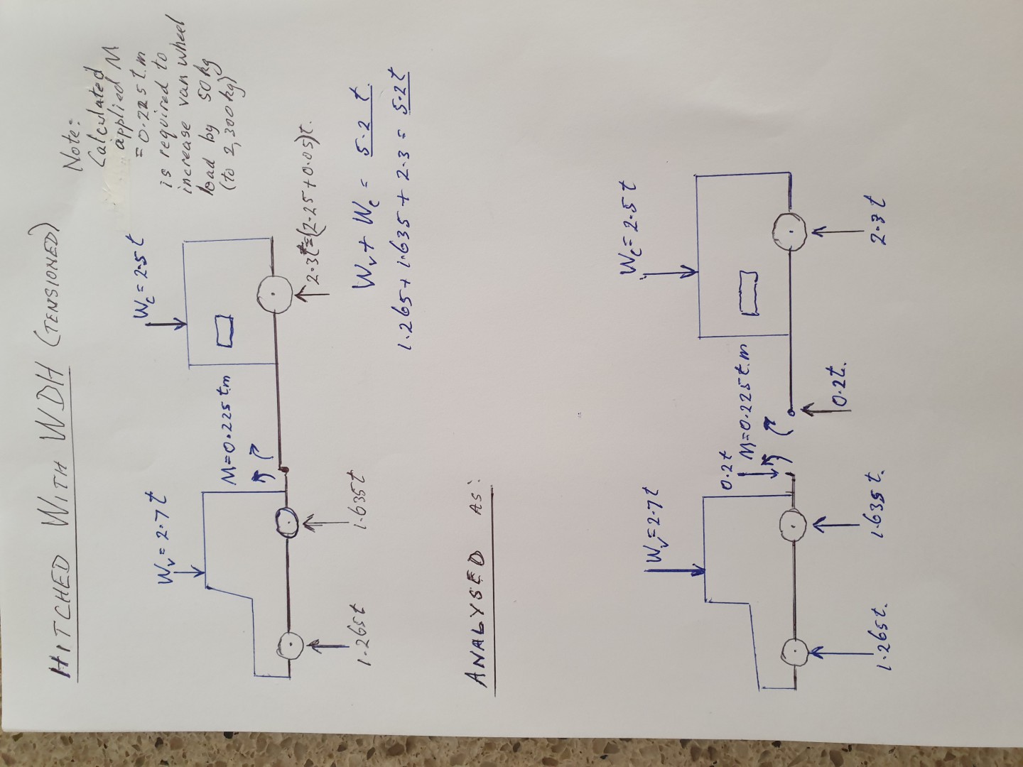

I made a post recently in this thread saying that I was not going to an analysis of the physics.
But after my reading of the posts that have followed, I did a few calculations with a set of vehicle and caravan dimensions and loads. Case without a WDH and a case with a WDH.
In the work, I assumed gravity was constant and thus did not write it into my calculations. Just multiple by gravitational acceleration, if anyone thinks that is useful.
In the work, I assumed that the WDH would be tensioned (torqued) to distribute an extra 50kg to the wheels of the van. My calculations, with WDH, determined that the torque or moment applied, would be 225kg.m or 0.225t.m (I know not a typical unit for torque, but good for these calculations).
As per previous posts and my own observations of my rig with a WDH, with the tensioned WDH, extra weight distributed to the van's wheels and weight distributed to vehicle's front wheelsand weight reduced on vehicle's rear wheels as compared to untensioned but hitched rig.
What was interesting, was that my calculations gave a value of vertical load at the ball coupling, if a load cell was inserted.
Of course, there was no reduction in overall vertical weight of the van and caravan whether they were on connected, hitched without the WDH being tensioned and hitched with the WDH being tensioned.
I assumed the weight of the WDH is already included in the vehicle's weight.
I have attached two pages with some analysis sketches showing dimensions, weights, the loads and the calculated reactant loads. I could show the calculations but more work to make them presentable for the forum and attach as well.
-- Edited by watsea on Saturday 13th of May 2023 03:28:11 PM
Oh no! Bringing practical and detailed into a WDH discussion will be all too much.
I will be interested to see your workings on how you calculated the difference when tensioning the WDH. I would have thought you would need the measurement of where the WDH downward force is applied on the drawbar to derive the ratio with the van wheel distance.
Also, the usual guideline for a starting point is to return half the lost weight on the tow vehicle front axles. Your calculations show a restoration of almost 100% so your example is not a recommended situation. However I appreciate that your calculation starts with a given at the van wheels.
Possum3 said
09:43 AM May 14, 2023
watsea, Analysis sketch is showing a weight reduction of 200 kg on single axle of trailer - Did the trailer go to Genny Craig?

Interesting that yobarr has suggested the method of using measurement in the setup of a weight distribution hitchs, went out with decimal currency and that happened in 1966.
The Weight Safe Distribution Hitch is one of the most recent adaptions of the WDH system and yet it is strong on the use of measurement in it's setup and application.
The inital set starts with measuring the height of the caravan and tow vehicle at the front and rear of both, the caravans attituded is adjusted with the jockey wheel until the caravan is level. the coupling height is established, then the towball is setup at a height 12-24mm higher than coupling height.
The vehicles are connected together, this when the weight safe hitch dial gauge shows the actual towball weight.
There are other measurements and known weights that are input to a phone app for the application of the lift bars.

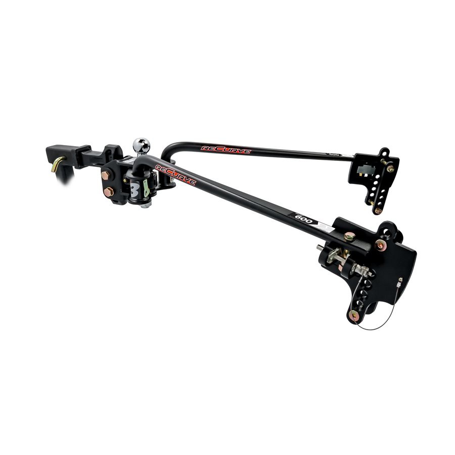

Another newer style of wdh with sway control
