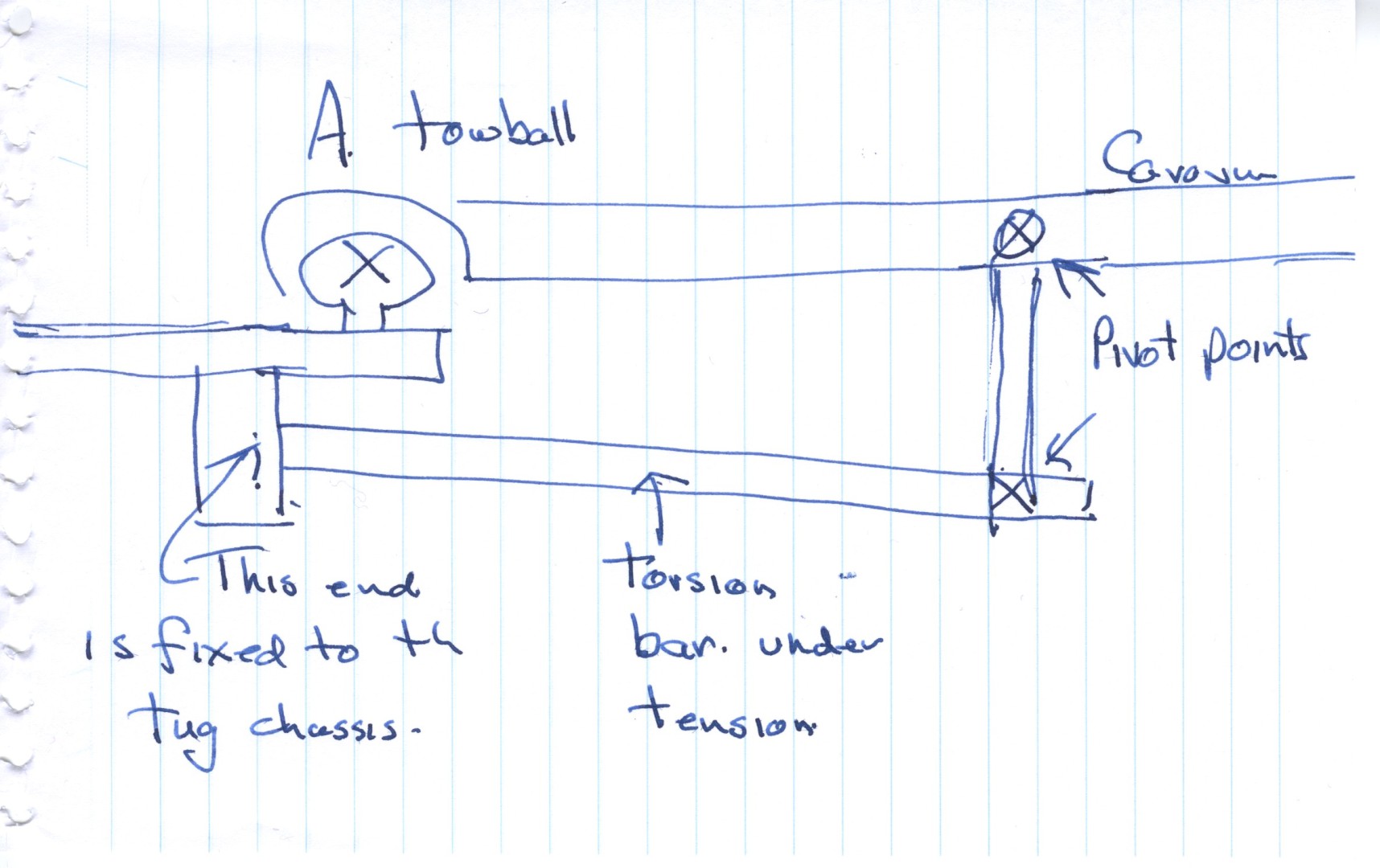

Well, finally I found a bit of time to think about this! Sad news is that if the WDH was reversed, it would not work,AT ALL! Will try to keep it simple so as not to confuse people, with help of photos below. With the HR WDH there is a solid "head" (1) bolted to the towbar shank, creating a solid base which the towball and the WDH trunions, solid bars, are attached to. These trunion bars are 28" to 30" long, and protrude beneath the van's drawbar, another solid bar. Between these two solid bars is a chain which is shortened, using a special lever, to bring the two solid bars closer together, thus transferring weight from the car's rear axle to both the car's front axle and the van's axle group. Amazingly simple, but ONLY possible because of the towball acting as a hinge, near the WDH head. First photo shows (1) the solid WDH head, the towball "hinge", and the solid trunion bar under the drawbar, while (2) (still first photo) shows how it all is mounted to another solid bar, the drawbar. As can be seen,when the chain is tightened it obviously becomes shorter, and draws the two solid bars together, thanks to the hinge. (towball). NOW, let's somehow bolt the WDH head to the drawbar in place of the tensioning brackets, and then somehow mount the tensioning bracket near the towball. Looks good? Now,using the special lever, try to tension the WDH by shortening the chains! Can't be done, because there no longer is a hinge between the van's drawbar and the trunion bars, our original two solid bars. All we're now trying to do is draw two solidly mounted bars together, and it's impossible to do that without bending or breaking one or both bars. Can't be done. Took me a while to work through it all, but it is patently obvious when studied. Cheers

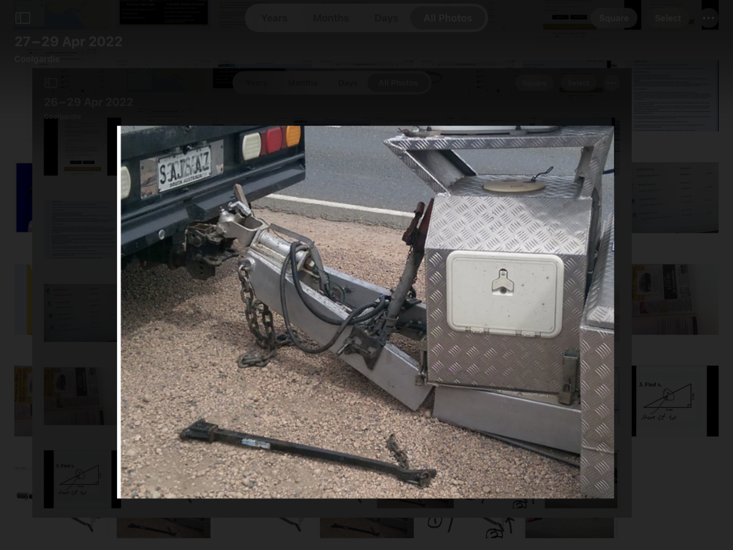

P.S The second picture shows one of the effects of the WDH putting downward force onto a drawbar, and confirms that a WDH increases the total weight of the van. Not negotiable. Cheers
-- Edited by yobarr on Saturday 30th of April 2022 06:21:55 PM
More to do with the extra weight on the A frame from what looks like a generator box and the weld at the end of that bracing under the a frame . BUT I'm happy to admit I'm not qualified to make a judgement call . your photo is far from a smoking gun .

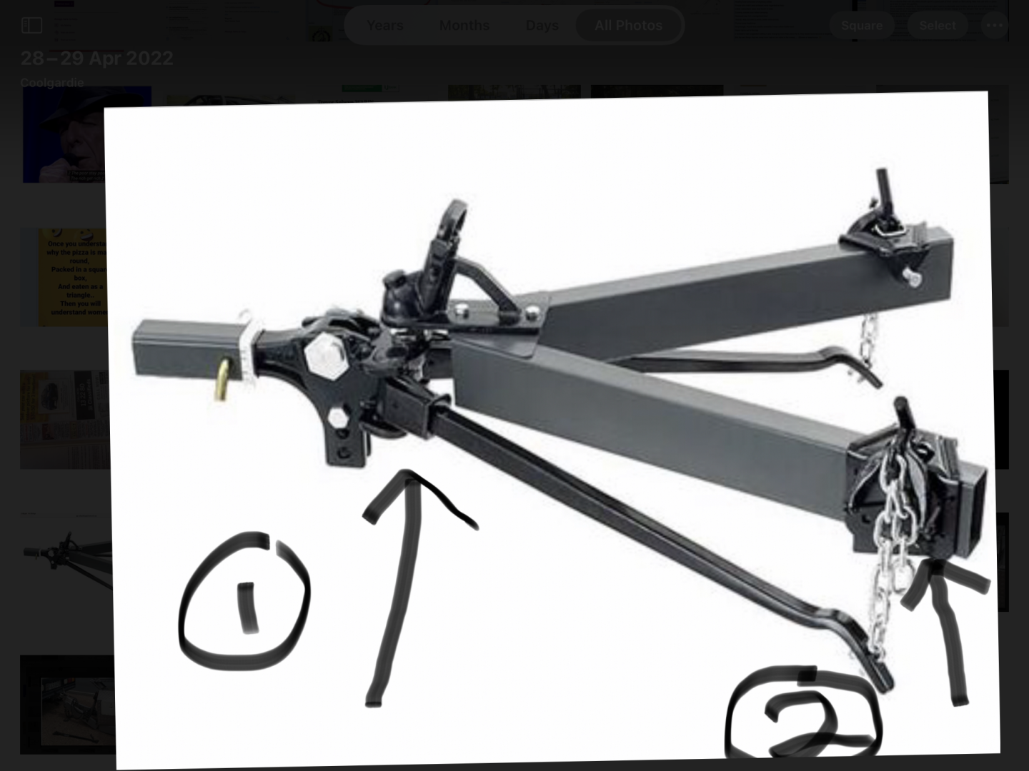

Stewart said
06:34 PM Apr 30, 2022
Thanks Yobarr interesting analisys. Looking at John C video on wdh I thought it it might move the fulcrum to to the caravan. And thus put more weight on the caravan axles. But as it can't be done it won't happen. Cheers Stewart
All is good, Stewart. Much time was spent trying various options, but it eventually became so clear. There no doubt will be many who disagree with my analysis, but it is so simple it's boring! Cheers

I disagree as I said above and say you are wrong. In your analysis you moved the unit to the wrong place. The pivot is the ball as you said and if you moved it where you said all connected on the drawbar it would not work. It should be moved so the chains are acting on the vehicle somewhere underneath, if the head was mounted on the drawbar.
But I will not comment any further as it will just descend into a morass of silly discussion. It is about levers and moments and points of action of the forces. One point of action is on the vehicle and the other is on the van, with the pivot at the ball. So simple its boring.

Hi Jaahn. Could I draw your attention to the wording in the initial enquiry by Stewart? He mentions "tow shank" as a mounting point for the chains, and all my calculations centred around that. Simple physics will prove me correct! Cheers
Yobar is correct I'm that the tow ball is a hinge(pivot)
The torsion bars are an extension of the tug chassis.
The chains when tensioned are essentially a solid lump of steel which are attached to the torsion bar at one end and the caravan chassis at the other end via pivots
The torsion bars are exerting a downwards force on the caravan chassis pivoted at the tow ball, it forces the tow ball up and the tug front wheels and caravan wheels down.

I had a thought. What if the wdh was reversed. So chains hooked on to the tow shank and fixed to the caravan draw bar would the results be the same for towing. (nothing to do with mud). Cheers Stewart
I would never buy from a manufacturer who forgets to weld the A frame!
