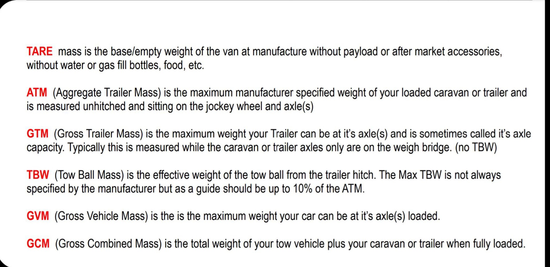

thank you oldbloke for the attachment which explains it all.
-- Edited by Ivan 01 on Sunday 27th of February 2022 02:28:05 PM
oldbloke said
03:36 PM Feb 27, 2022
Yep, that info is Freely available. The tricky bit is getting it in clear English. The defintions are often mixed up with less relevant and at times confusing info. The other thing is getting the correct info. Often it's just word of mouth or on the www and just wrong.

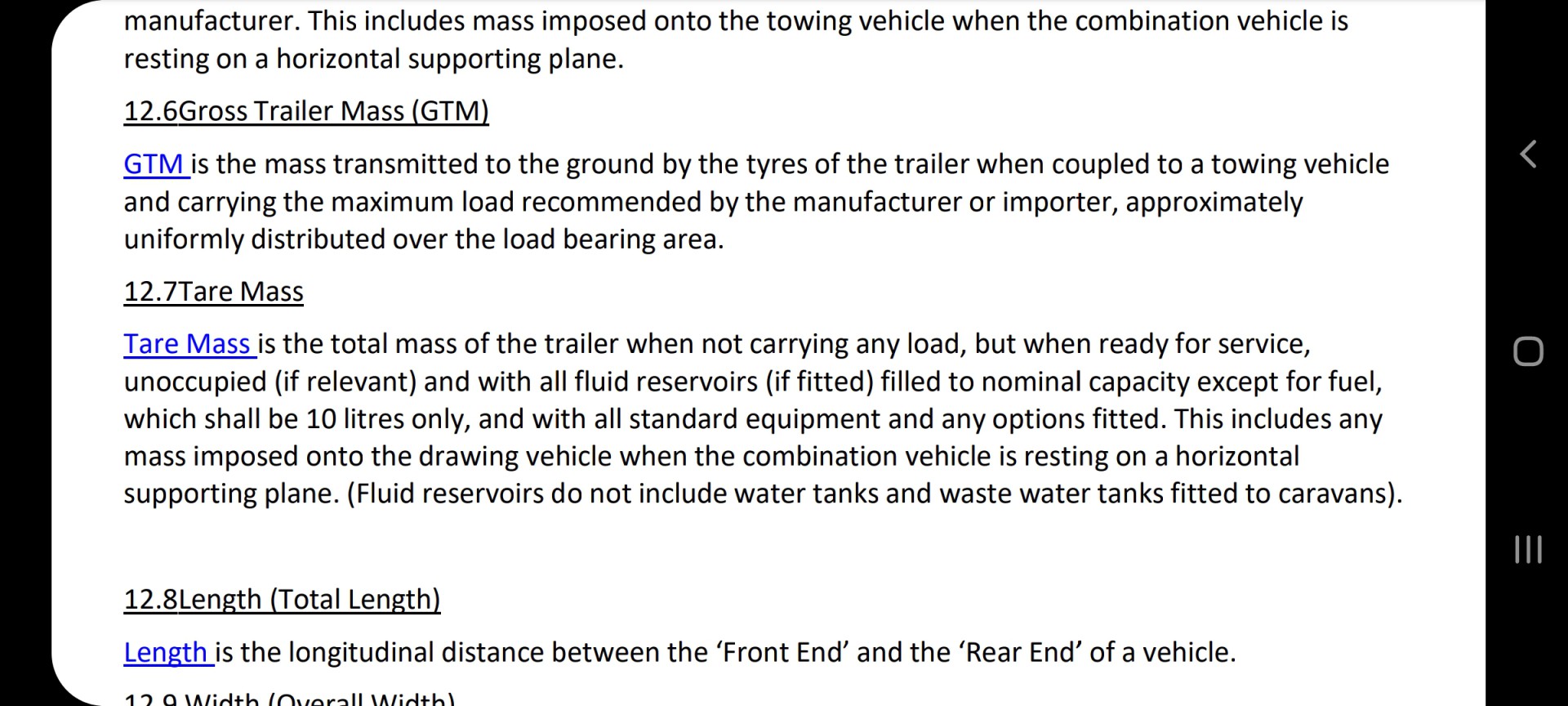

Tare Mass is the total mass of the caravan with no load, unoccupied and with all fluid reservoirs, if fitted, filled to nominal capacity, and with all standard equipment and any options fitted. After market optional add-ons (TV, mattresses, extra gas bottlles, awnings etc) are not inlcuded in the tare mass and are considered as a load, so must be included in your ATM measurement. The tare mass weight of your caravan can be found on the vehicle plate or in the manufacturer's handbook.
I assume as the domain is roadsafety.transport.nsw.gov.au that that is the NSW government official definition.
Everything on the invoice should be included in the tare mass. Not that I would rely on a salesman assurances.
oldbloke said
12:02 AM Feb 28, 2022
I suggest you call them and ask if it includes water tanks and gas bottles in caravans.
This is fron vicroads. Water tanks NOT included. See last sentence. That's 190kg as a rule. Normally gas also not included.
That is a surprise to me as well. I always thought TARE was the weight as it left the factory. I can't think of what fluid reservoirs a van would have that are not water and gas. Grey and black water filled to nominal capacity? Hardly. Perhaps a little diesel to test a diesel heater, etc.
But, maybe it makes no difference even if NSW TARE does include water tanks.
I looked up the definition of "nominal". Depending on the site it is "an insignifcant amount" or "a trifling amount in comparison to normal". So if the factory tests the water tank and pump, there would be a nominal amount of water left in the tank that is insignificant in the total weight. There is no logic that the factory would put a nominal amount of gas in the bottle. I imagine they would connect a temporary bottle for testing.
So, in reality, it virtually means the same thing.

oldbloke said
07:50 AM Feb 28, 2022
-- Edited by Are We Lost on Monday 28th of February 2022 01:40:19 AM
IMO you are correct.
I'm guessing an IT person has copy pasted the definition for a car "tare mass" into caravan section not understanding the difference.

For a caravan the Tare Mass is the total mass of the caravan with no load, unoccupied and with all fluid reservoirs, if fitted, filled to nominal capacity, and with all standard equipment and any options fitted. After market optional add-ons (TV, mattresses, extra gas bottlles, awnings etc) are not inlcuded in the tare mass and are considered as a load, so must be included in your ATM measurement. The tare mass weight of your caravan can be found on the vehicle plate or in the manufacturer's handbook.
I had not factored in fuel as I was considering only the caravan,
I wonder if the vehicle plate figure will include the extras, supplied and fitted by the manafacturer?
I want an extra battery and solar as well as Lithium batteries.
These are the correct definitions.
Yes, all potential purchasers of new and even second hand vans and vehicles should read understand and absorb the meanings of the terminologies listed in your attachment.
A lot of inaccurate information could also come from an over exuberant sales person just telling a future owner what they want to hear as opposed to the facts.

The definition I gave in my previous post was copied and pasted from
https://roadsafety.transport.nsw.gov.au/stayingsafe/drivers/caravan-safety/weighing.html
https://rvbooks.com.au/caravan-tare-weight-issues/
-- Edited by oldbloke on Monday 28th of February 2022 12:31:15 AM
Empty from factory is what it is.
