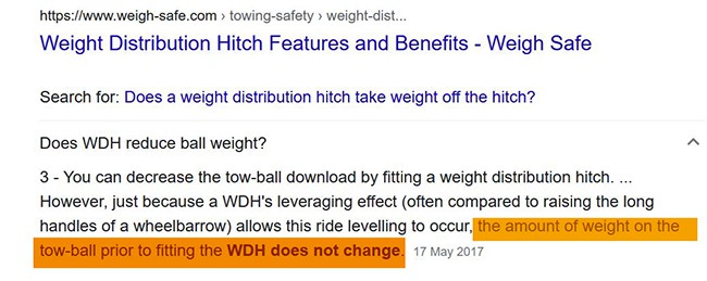

Hi Stephen.Not sure what you are attempting to illustrate here,but before anyone is confused by your assertions,I will say,for 6,950th (approx) time,
A WDH DOES NOT CHANGE TOWBALL WEIGHT.
Never has,Never will.
This information is clearly written on the Haymane Reese website,screen shots of which I have posted prevoiusly.

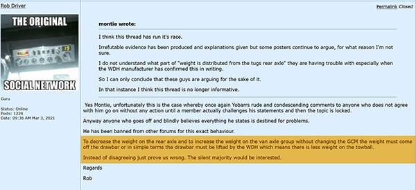

In the exercise of weighing a combination of a vehicle towing a pig trailer to achieve the GCM the drawbar can not increase in weight unless more weight is added to the pig trailer between the trailers axles and the tow coupling.
I grabbed this from anothers post.
See the picture, no weight on the drawbar.
If there was, the back axle of the car would be on the ground.
The installation of a WDH or a rigid bar between the c/van and the car in theory, makes the combination become the same as a rigid two axle or in this case 3 axle vehicle.
In this example (picture) you cant weigh the tow bar or draw bar because it is in theory a rigid chassis.
Look at the picture.
Imagine driving it onto a weighbridge.
The only weights you may read is from the axles of the van and the front axle of the car. This weight will equal the GCM of the combination.
Any weight reading can only be taken or assessed where the weigh point touches the ground.
If it not touching the ground then it cant register a weight.
The weight has been moved by the action of the WDH bars, to the c/van and front axle of the car.
The weight that would normally be exerted onto the ground by the drawbar of the c/van is non existent because it has been distributed to the 2 van axles and the cars front axle.
This car (in the picture) is a Front Wheel Drive and it was reported that for the demonstration it was driven around in that condition.
If a rigid bar or WDH removes weight from the draw bar and distributes part of that same weight to the vehicles front axle and part to the axle of the c/van then in theory, the draw bar / tow ball will be lighter by the total of the amount that the front axles and the c/van axle increase.
This is, and has been proven on the charts in this and other topics and so easily proven if anyone chooses to take their own van and car to a weighbridge.
The weight or design of the WD hitch, or the boot lid, the travellers suitcase in the boot, or the gas bottles on the drawbar have no relevence.
The static weight of the drawbar when standing on the ground will be lighter when a WDH is tensioned. The amount that the WDH is tensioned will have a direct effect on how much weight is transferred fore and aft.
-- Edited by Ivan 01 on Wednesday 26th of January 2022 08:40:21 PM

This continual toing and froing about towball weight is becoming tiresome because some people refuse to believe the facts.
1. TBW is a static weight that can only measured correctly when the trailer is level and not connected.
2. As soon as the trailer is connected to the towing vehicle the TBW becomes irrelevant as it is unmeasurable.
3. Using a WDH is about weight distribution nothing else.
4. From personal experience in using WDH'S and a lot of research, the setup and application of the WDH needs to be inline with the manufactures instructions.
* My WDH has been setup using the measurement method and then checked using a weighbridge
5. As long as your combination is within the weight limits for you vehicle (GCM, GTM and Axle weights) nothing else matters.
Finally as long as the TBW doesn't exceed the weight specified on the Towbar I'd plate nothing else matters.
